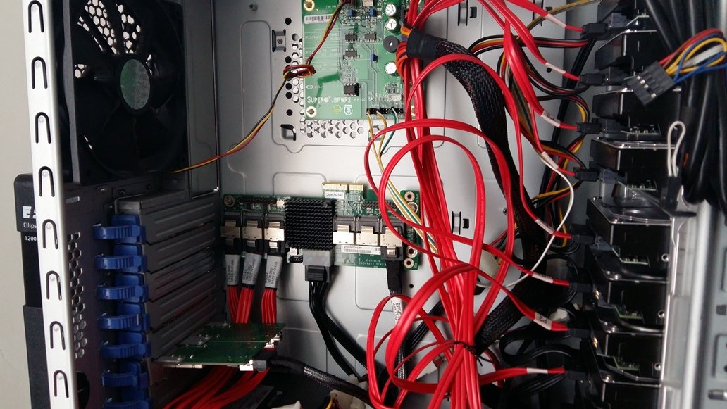

Another option would to get an expander, like the Intel RES2SV240, it can be found on ebay for around $70/80.

Thanks for the reply. Can you tell me how that works? Does it hook up on its own independently, or does it have to interface with my existing h310 in some way?
It connects to the HBA, with 1 or 2 cables, since you only need 16 ports 2 is best for max bandwidth, then 4 cables go to the 16 drives, it doesn't need to be on a PCIe slot, it's optional for power only, it can also be power by a molex plug.
