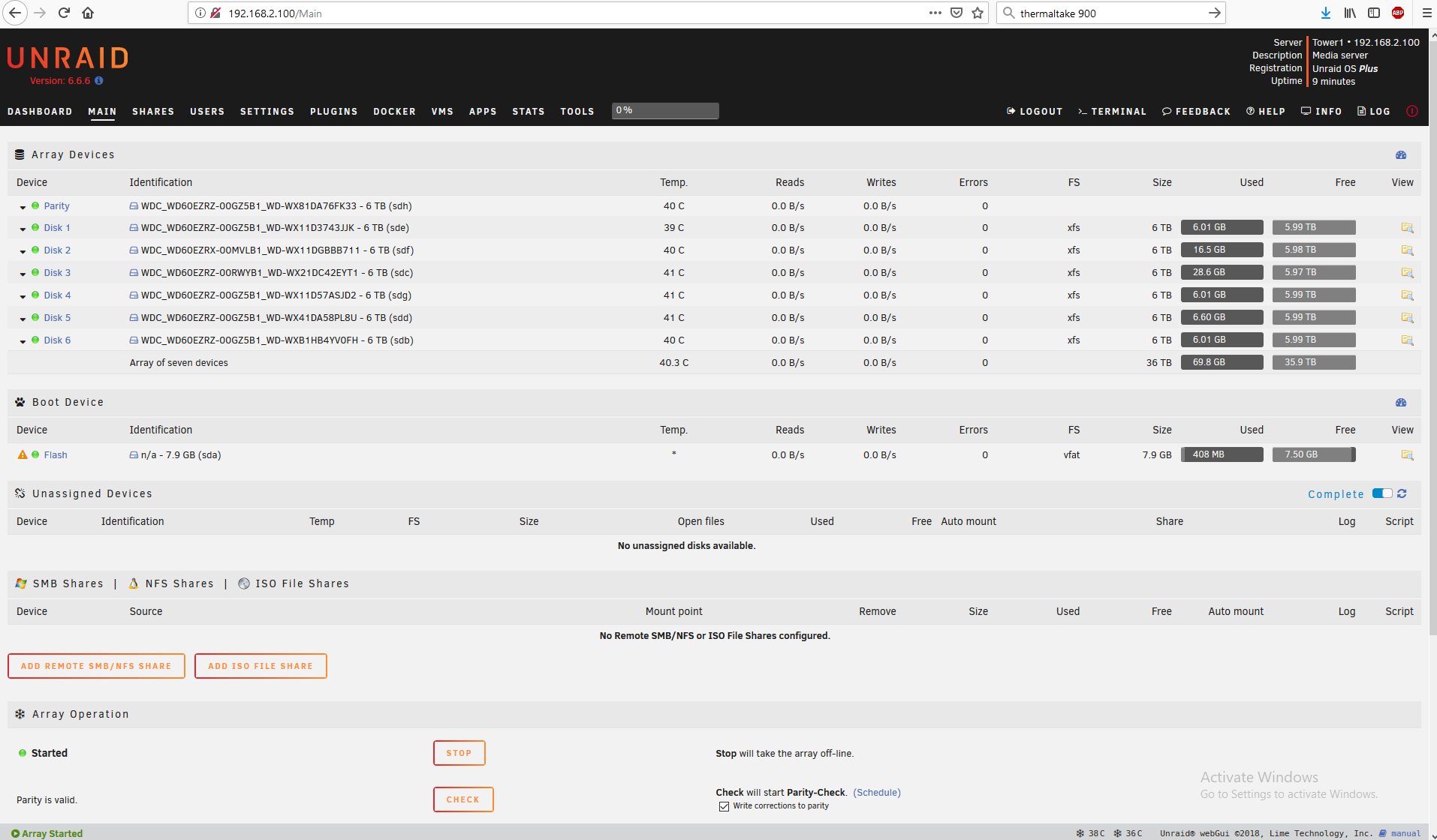

Happy New year to me.  this day I noticed that there were no files and triple the data size array.  Prior to New year I cleared the recycle bin and can only image that I may have cleared the drives. The system is intel 4670k with the 7 drives indicated.  There were about 20,000 video files on the disks or about 26T.  Have not done any writing or other actions.  Where can I go from here?main.thumb.PNG.b13c9d29dbf17a83e4ad2efb3b83820d.PNGtower1-diagnostics-20190102-1700.zipsyslog.thumb.PNG.adcbf826c2ef17a7c8c44da9483aaf51.PNG

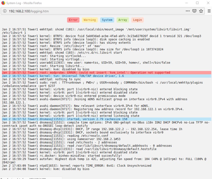

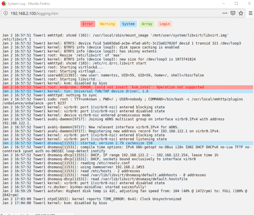

Not much in your logs since you rebooted before taking them. It looks like you may have another browser open to your server somewhere. It is better to only work from one session, or at least keep your open browsers refreshed so they are working from the same state of Unraid. Please close any other browsers you may have open to Unraid, including mobile app.

Your diagnostics seem to indicate shares on all of your drives. Don't know what files may be there.

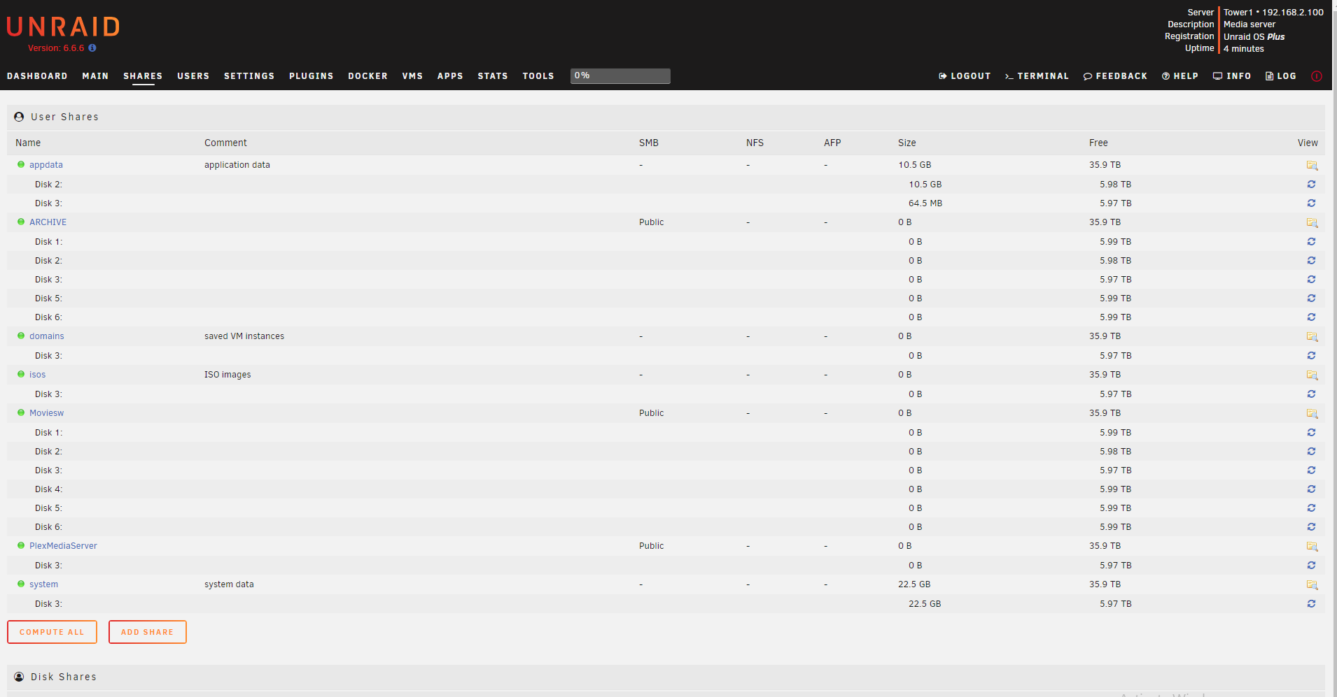

Go to Shares - User Shares and click the Compute All button. When it is finished and displays the results, post a screenshot.

From your screenshot, it appears the top level folders, which are the user shares, are on your disks, but those are empty.
