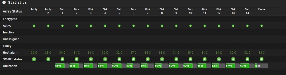

Well according to my smart reports which I downloaded from the Diagnostics report and from my dashboard , all looks good. But I think I will take all dockers offline and replace one at a time just to be on the safe side. Thanks for all the info .
