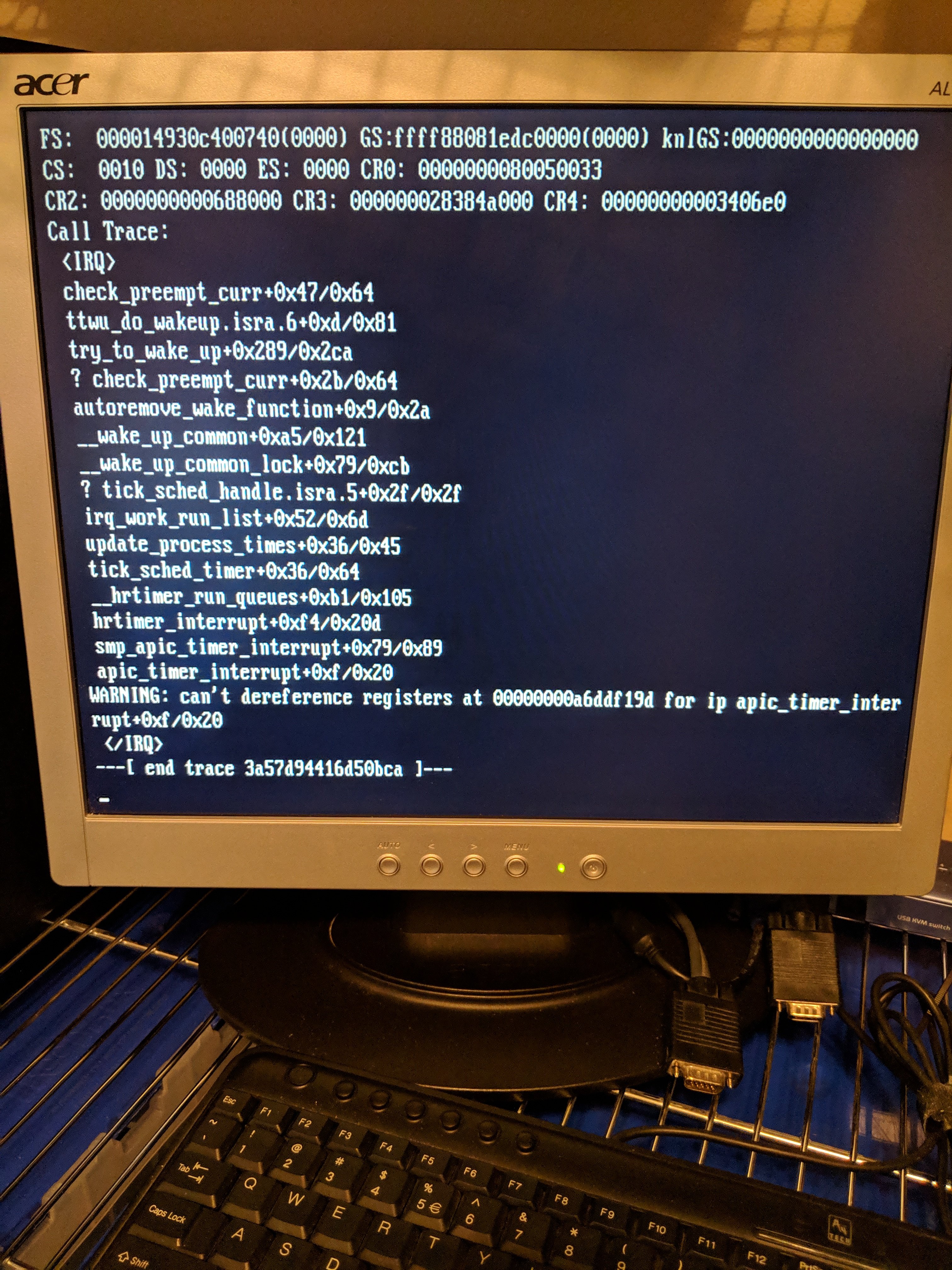

Double check that all power connectors are securely and fully inserted.  Same for the RAM modules.  Unless you have ECC memory, run memtst for 24 hours minimum (It is an option in the Boot Menu.)  Connect a monitor to the console so that you can see if there are any clues there.  (Take a picture of the screen making sure the photo is sharp and clear. )  Check the MB and CPU temperatures (with the Dynamix System Temperature plugin).

I did not mean to take a picture of the results of memtst but rather after the system has crashed.  Hopefully, there is will be something on the screen.  You can also install the Fix Common Problems plugin and turn on its 'Troubleshooting' mode.  That will write files to the   logs   directory of your flash drive.  Upload those logs after the crash.   With your system being new, it  could be possible that you have one of those new components in a failure mode.

Here is what I got. I don't know what to look for so hopefully you see something useful.

What is current status?  If the  problem is still happening and it still does it in Safe Mode, you probably have a hardware problem.  Hopefully a Hardware  Guru ( like @johnnie.black )  Will have a look at that screen photo of the console monitor that you posted.
Beyond that, Since the memory does not appear to be an issue, I would be looking at the remaining hardware.  Since that Ryzen 7 2700X is a relativity high power consumption chip, I would have a good look at the PSU.  (PSU's have been the culprit  in several similar problems recently.)  You may have one laying around, borrow one from a friend or see if you can 'borrow' one from a vendor with a liberal return policy.
