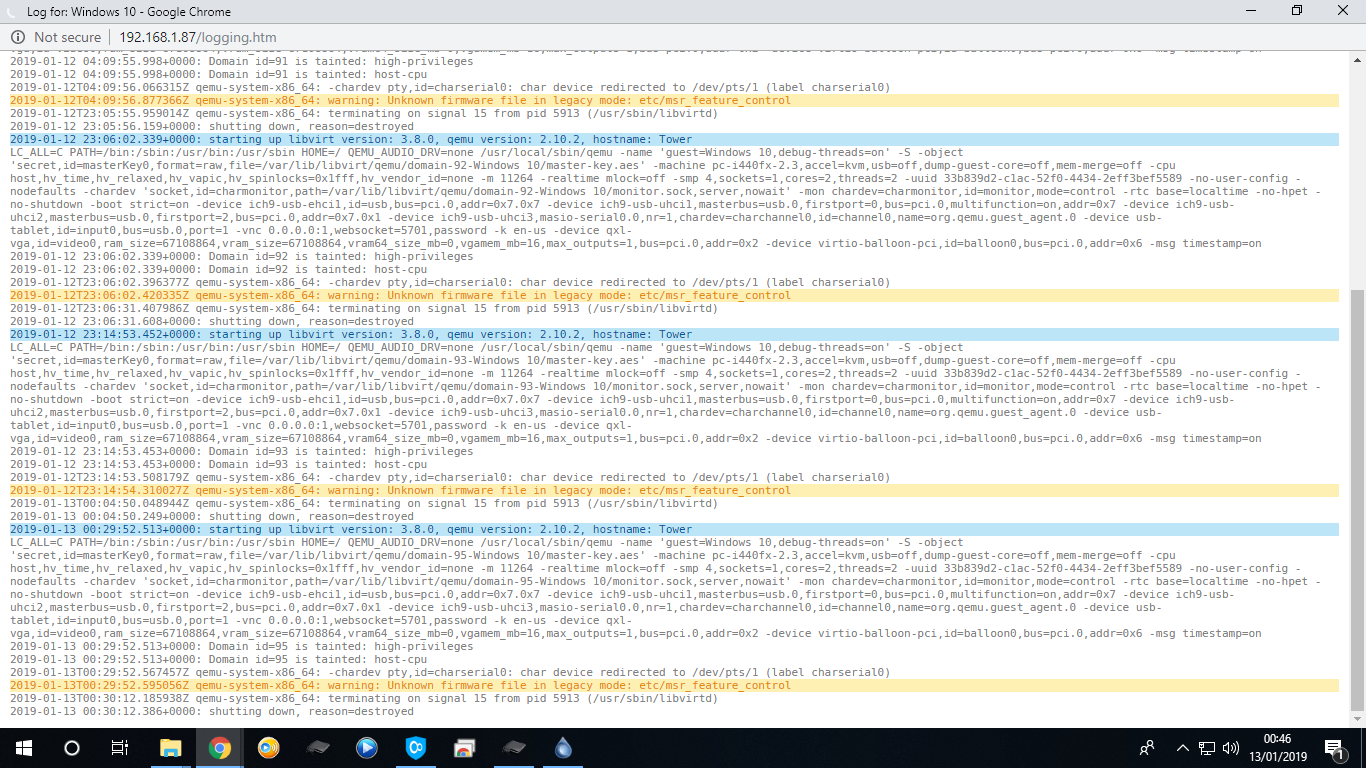

I have two win 10 vm's, one is running ok, the other has stopped & I can't restart it. When I start it, it runs for a few seconds then stops. Below is copy of log file,

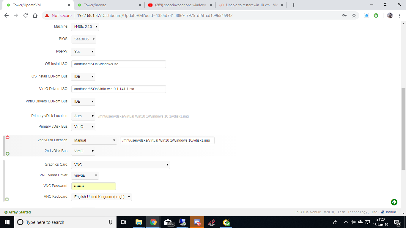

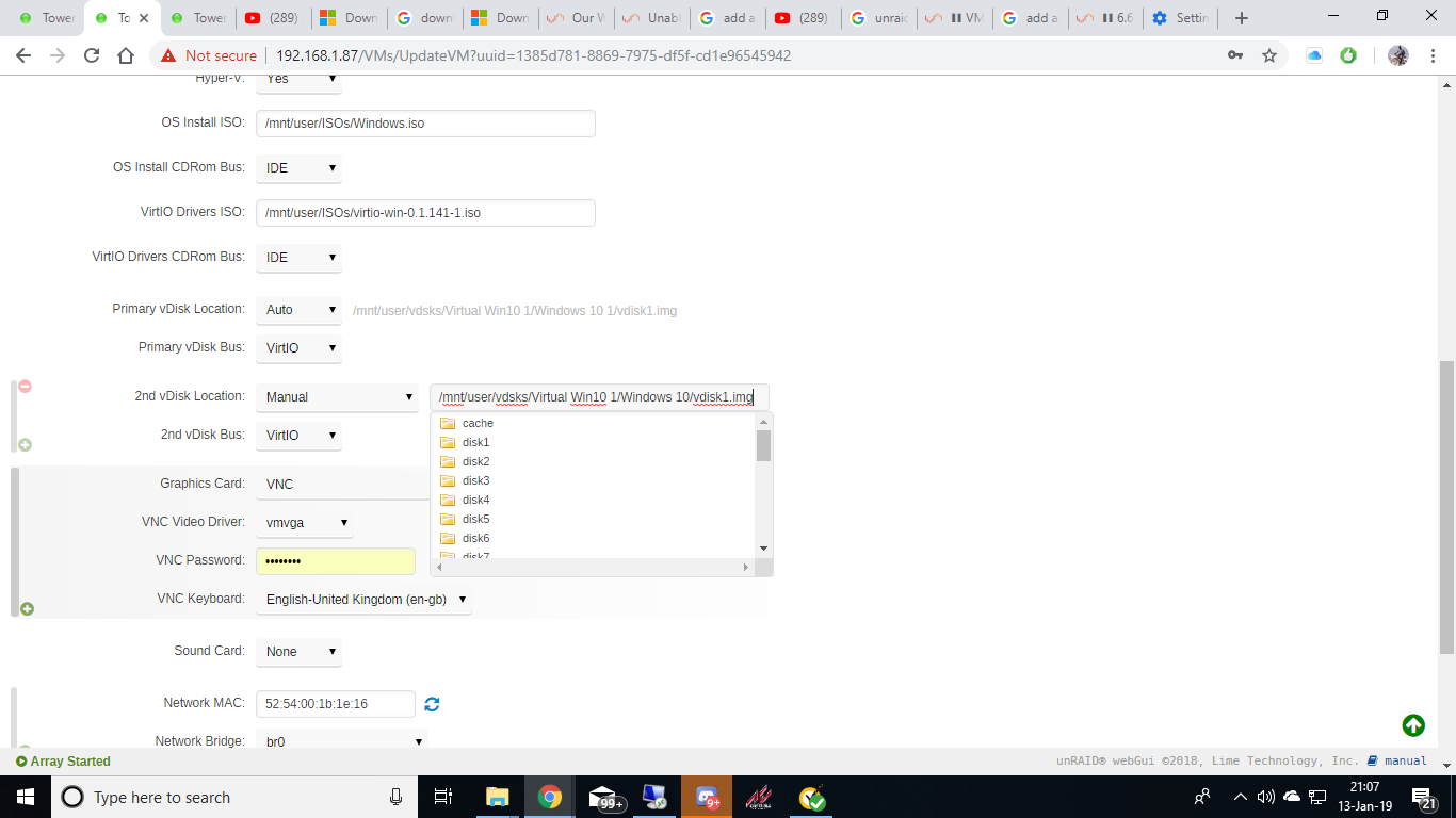

/mnt/user/vdsks/Virtual Win10 1/Windows 10/vdisk1.img
This is what I pasted into the 2nd vdisk of my new vm. It wouldn't start

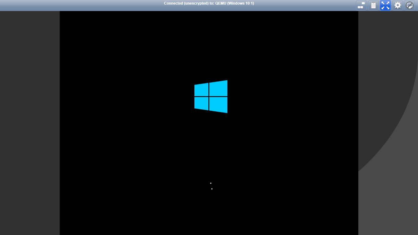

This is what happens, it locks up and I have to force stop it and remove that line.

Unless I am misreading the screenshot you seem to have given the same vdisk as both the primary drive and the second drive?
/mnt/user/vdsks/Virtual Win10 1/Windows 10 1/vdisk1.img
Primary vDisk Bus: VirtIOSATAIDEUSB
2nd vDisk Location: AutoManual
/mnt/user/vdsks/Virtual Win10 1/Windows 10 1/vdisk2.img

The dots that normally go round on windows start stop. Refresh the unraid dashboard screen and the vm has a yellow paused symbol

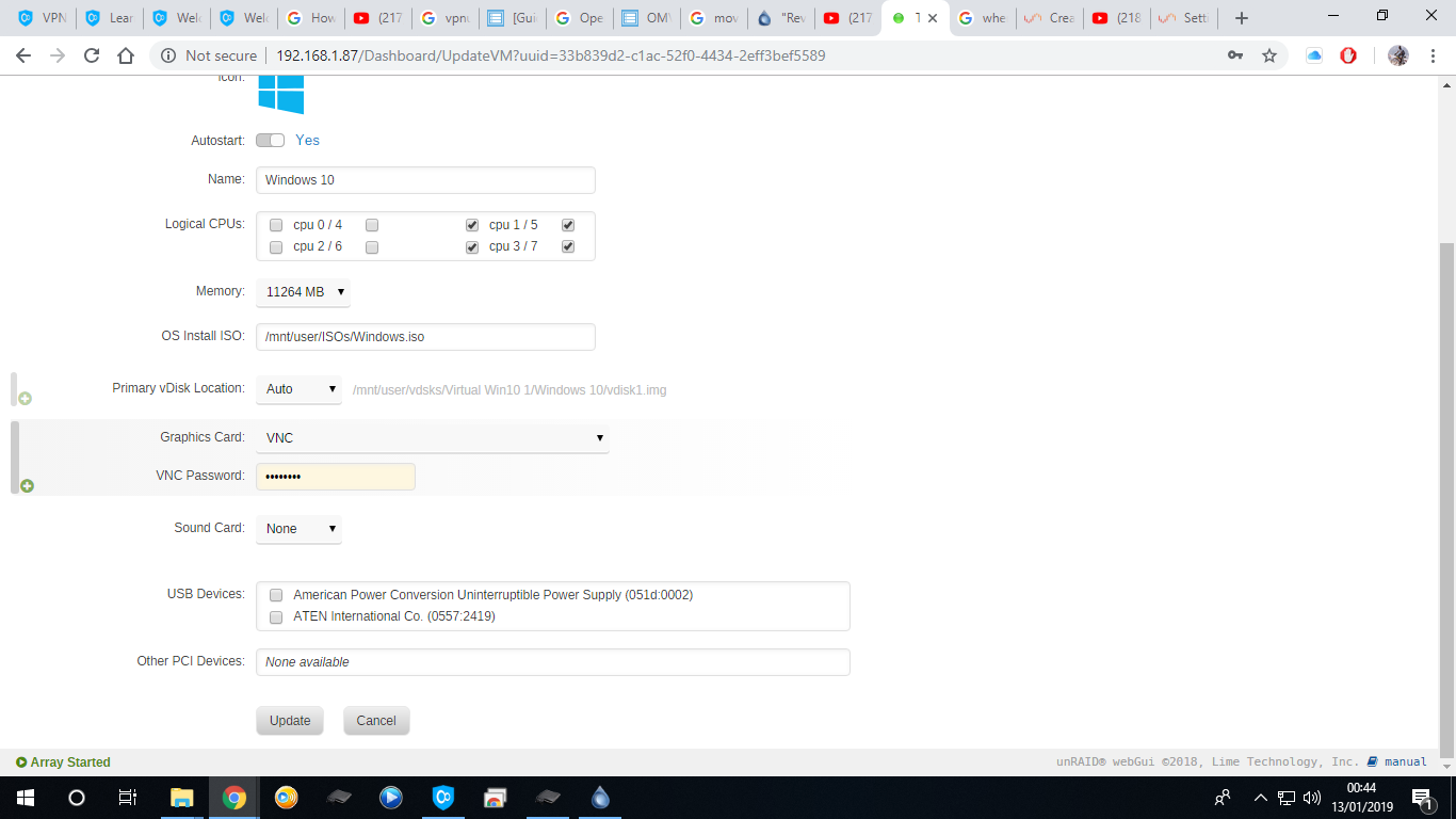

Post a screenshot of the VM that won't start, and another of the new VM that you are using to recover the data.

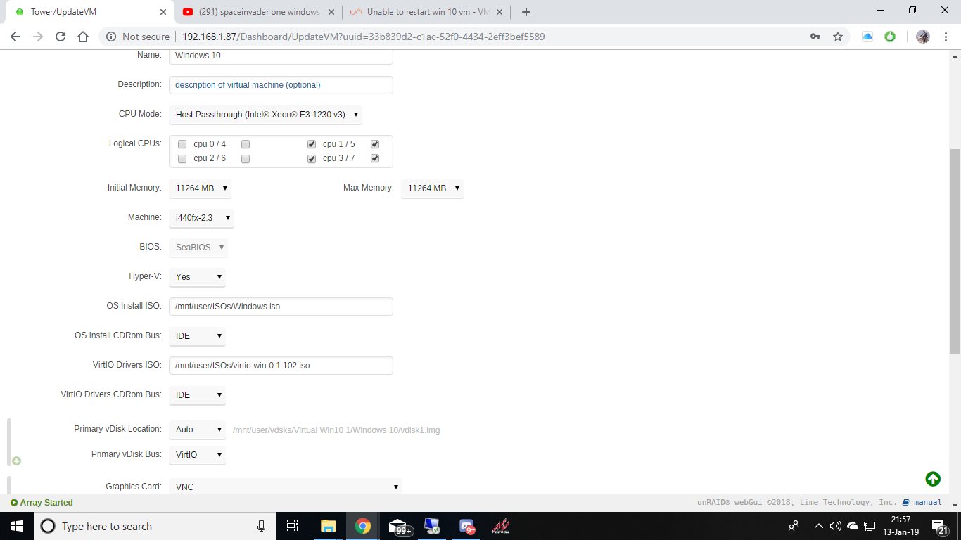

The failed vm,

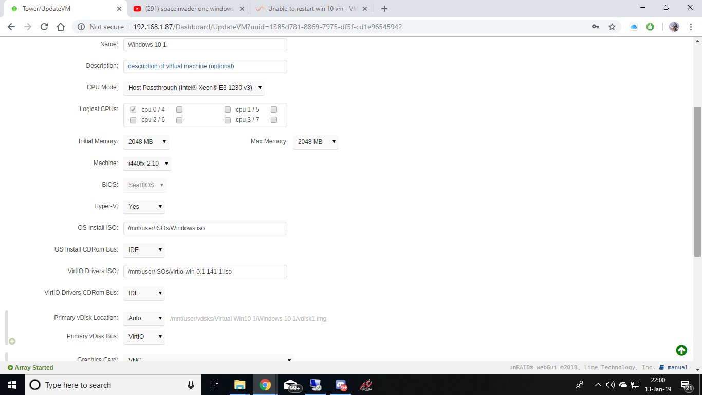

The vm I'm using to recover,
