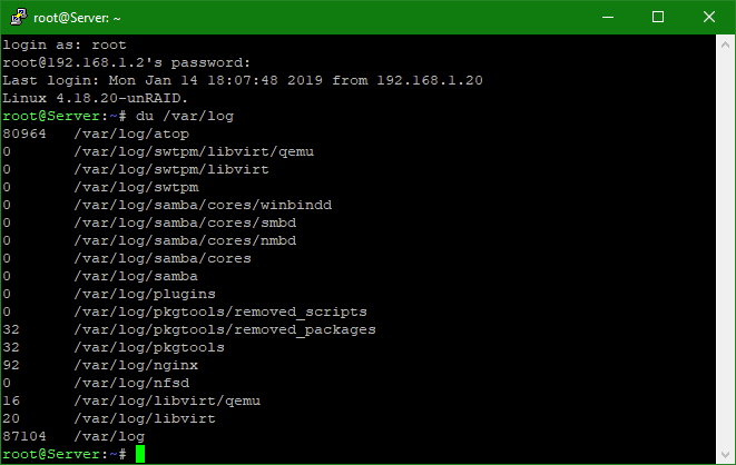

Syslog itself isn't to blame. Have you got atop installed? At the terminal, what do you get with this?
du /var/log
du /var/log
Looks like I do have atop installed.
Should I rip it out?
I can't remember why I installed it come to think of it, lol
If you don't know why you have it and it is giving you trouble then get rid of it.

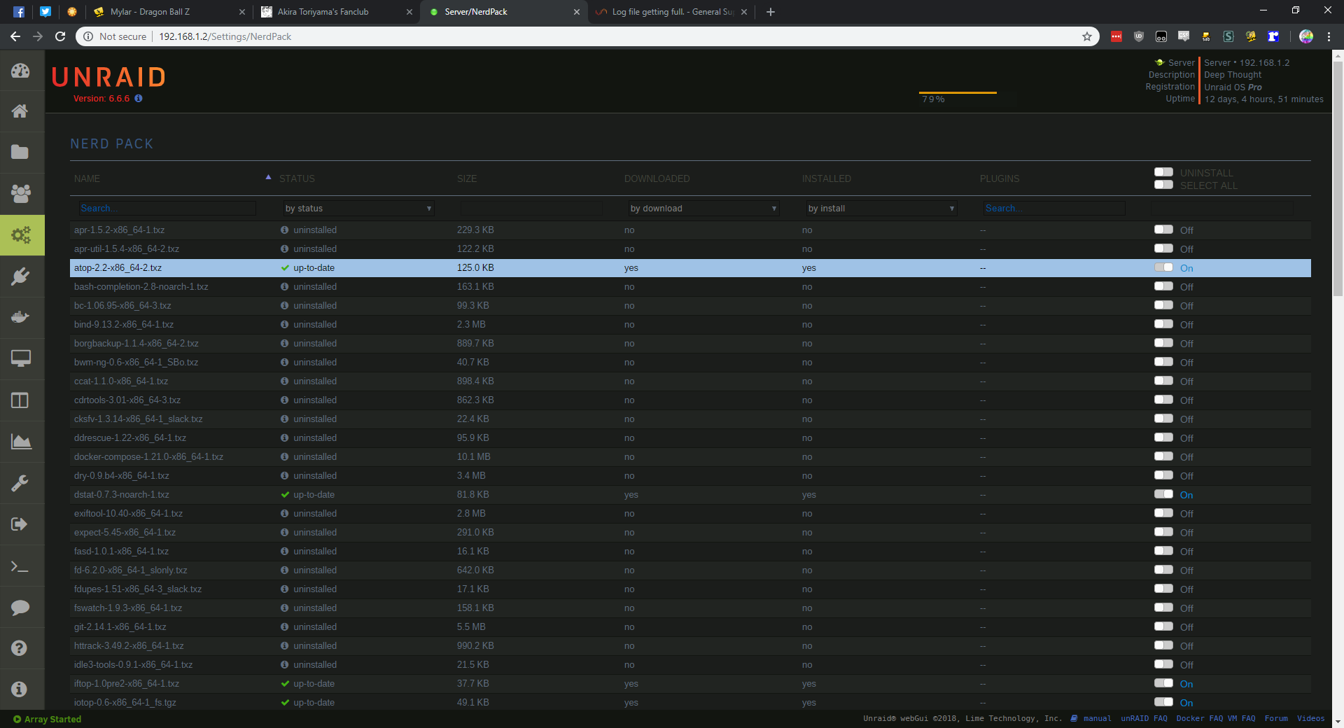

Okay, I feel dumb, how do I remove things in Nerd Pack? I turned the switch for it off but it didn't remove it........ I'm sure I'm missing something. :'(
Did you scroll down and hit "Apply"?  *May* have to reboot also after applying.
I just figured it out, after turning it off and hitting Apply I have to go back to the top and toggle on the "Uninstall" switch and it removes everything that isn't on, so when I did that it pulled atop out and left the others.
Thanks everyone ^_^
