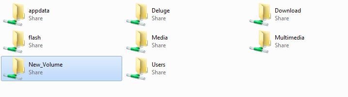

and here is my shares
and the view from MS Windows

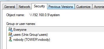

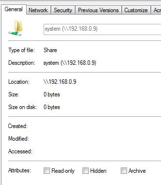

when I do as requested I get a bit of information.
Capture.JPG.b049ab9b4a9f570f741fe4efc89692c0.JPGCapture.JPG.d27a1e4dccbae1a9d8d844b1b96e5f6f.JPGCapture.JPG.8cd4fdd347b817ada1e3fff04c3f7271.JPG
I also have attached the Diagnostics logs tower-diagnostics-20190206-1638.zip
A quick look at your diagnostics shows that you have no user share called "New_Volume". The information in your most recent post suggests that the share in question is actually called "system". Now all Unraid servers have a user share called "system" but it isn't usually exported. Quite why Windows is referring to it by a different name, I don't know. I'll look more closely at your diagnostics but in the meantime try turning off the sharing of your "system" share, then reboot Windows and see if the "New_Volume" share doesn't appear. If you don't actually need to export that share then leave it disabled. Otherwise re-enable sharing and see if it appears with it's correct name. It looks like a Windows problem - maybe it objects to the name of the share. Do you have access to another PC to see what it makes of the "system" share?
