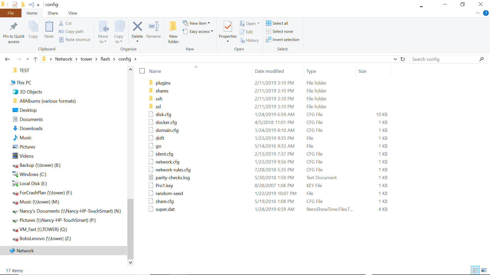

Thanks to both of you with your quick responses. I have not changed any hardware since I backed up the original flash drive, and also I have a screen shot of the current hard drive array. I will wait until the new flash drive arrives in the next several days before I proceed. In this way, I can maintain the integrity of the second flash drive as mated to its GUID which has the second of the two Pro licenses purchased long ago. When the new flash drive arrives, I will load it with a fresh copy of 6.6.6. I will use the make bootable app which is part of the unRAID download. Then I will rename the config folder to config_old. Next I will copy the config folder from the now dead flash drive which I saved on my PC to the new flash drive. I will boot unRAID and do those things which the license manager prompts me to do. Does it seem to you that I understand the proper process? I did notice that the now dead flash drive, contents of which I have a copy, has a Pro1.key file. However, the flash drive which ought to have the second Pro license and which was updated as far as version 4.7 has only a super.dat file in the config folder. Is this because it was never used in actual running an unRAID server? I have copies of the config folder from both flash drives backed-up in 4 places:  on a local SSD and a local external HDD and two off-site cloud locations, One Drive and Amazon Drive.
Check the root of the 4.7 flash drive for the .key file. The locations and contents of the files on the flash have evolved a bunch since then, but the actual key file itself should still be valid.

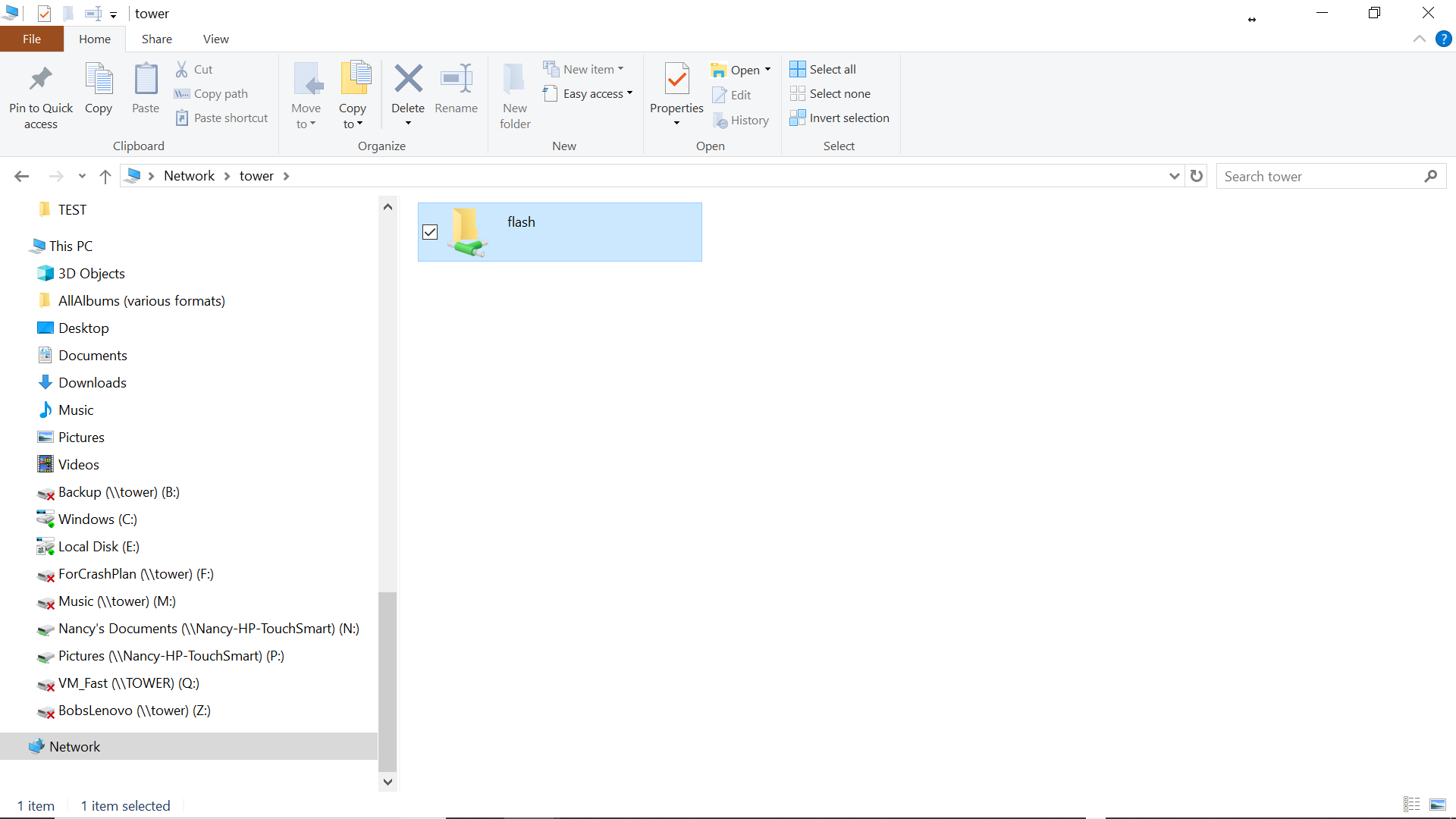

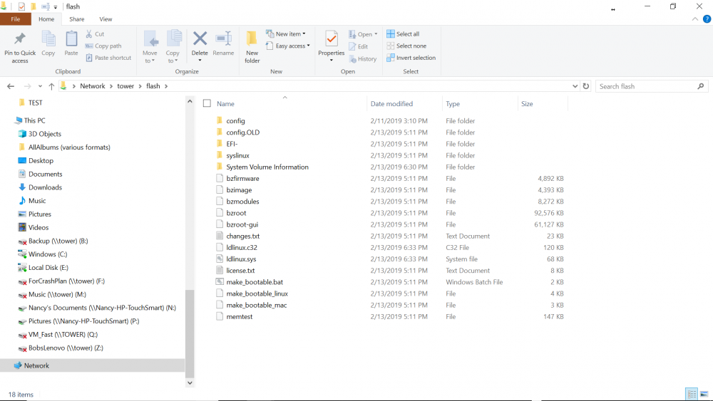

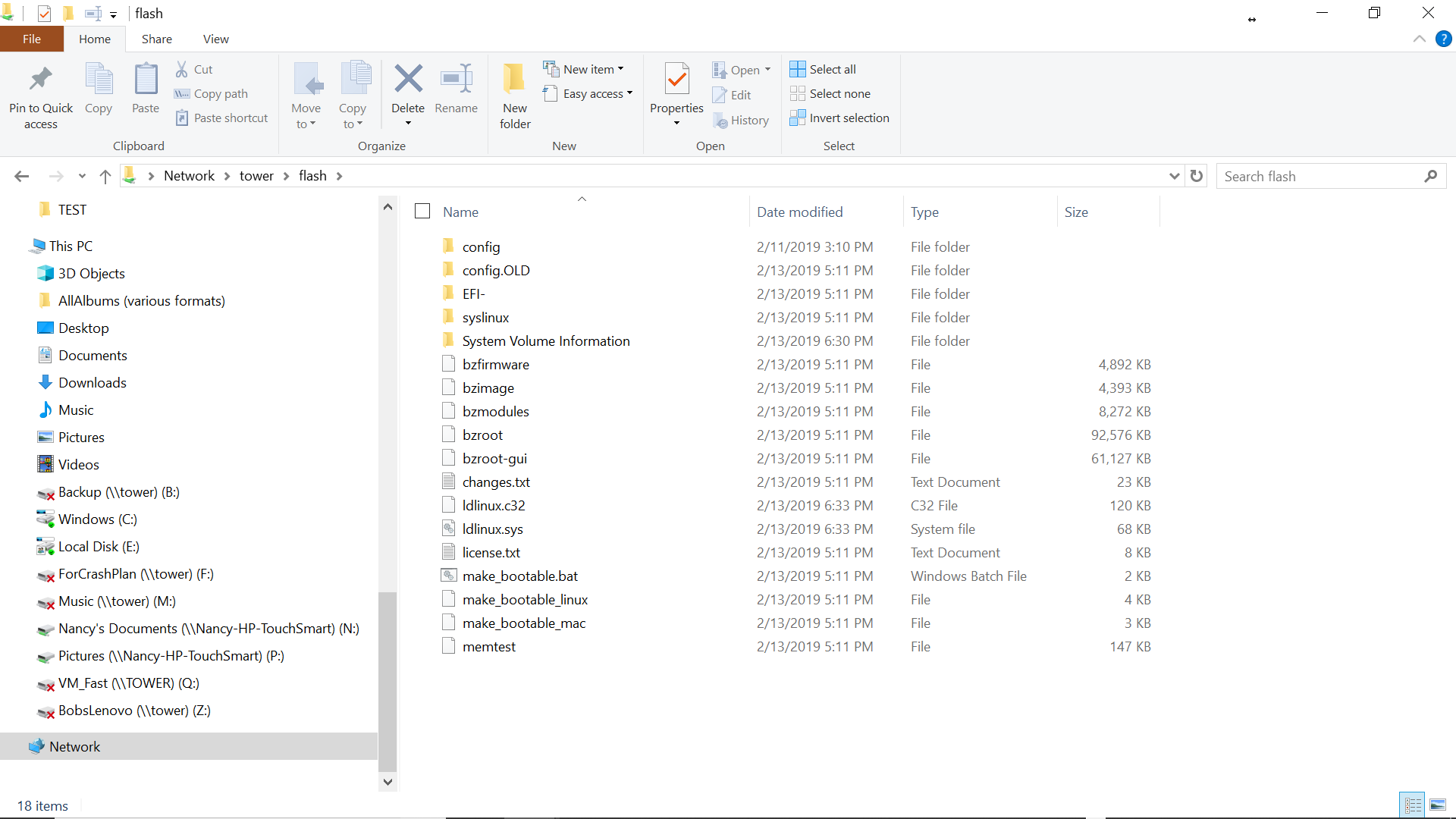

So, I received my new flash drive, a 32GB Kingston DataTraveler SE9. I downloaded a zipped copy of version 6.6.6 from the Lime-Technology site. I used Control Panel/Administrative Tools/Computer Management/Disk Management to find the flash drive; I formatted it to FAT32 with the drive name as UNRAID. I unzipped the downloaded copy of 6.6.6 on my local Windows 10 PC where it had been downloaded. I copied all of the unzipped files from my PC to the flash drive. I right clicked the make_bootable.bat file and chose the run as administrator command. After the bat file ran, I went back to the flash drive and renamed the config file to config.OLD. I copied the config file from the old flash drive, saved on my PC, to the new flash drive. I used the safely remove usb device sequence in Windows 10 and removed the new flash drive when told that it was safe to do so. I plugged the new flash drive into my unRAID server. I booted the server. However, all that was visible from my Windows 10 computer's Network screen was the flash drive. Though I did know that the unRAID server must have assigned a TCP/IP address, I wanted to know what that specific address was. I opened the router's web interface and found not only that a TCP/IP address had been assigned but that it was the same TCP/IP address as it had previously when the old flash drive was in service. I have attached 3 screen shots of the flash drive. I have no idea what else to do.
WOW! Now I feel like an even bigger idiot. After running an unRAID server for all these years, I have never used the simple http://tower command; I have only ever used \\tower. Thank you again! And I apologize for wasting your time. I so should have known better.
