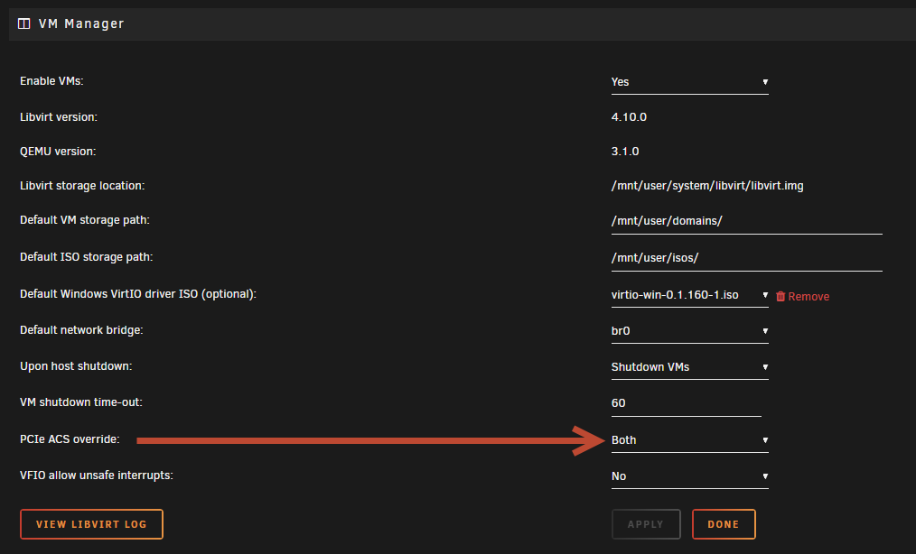

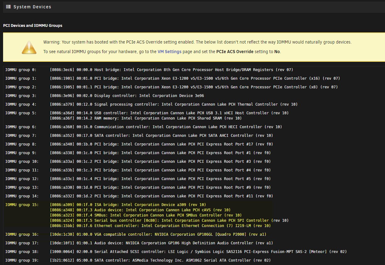

and found that my MB had grouped the adapter with alot of others devices so I had to enable "PCIe ACS Override"

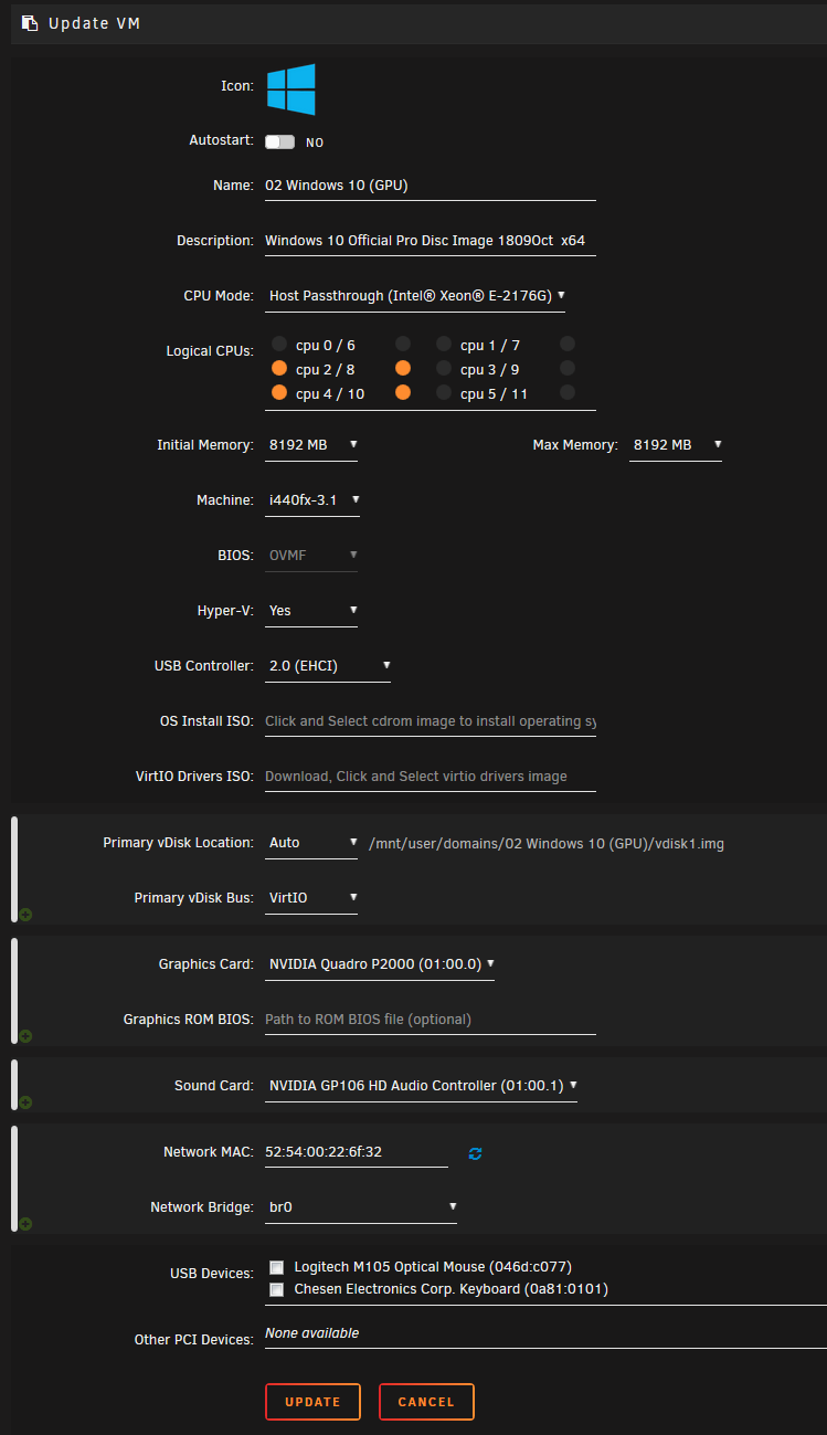

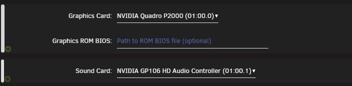

I then got a Group 16 with the Nvidia card
I then selected the card in the VM

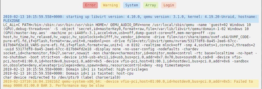

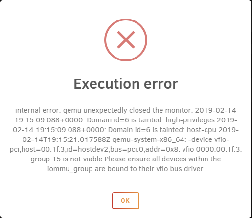

And fired up the VM and got this

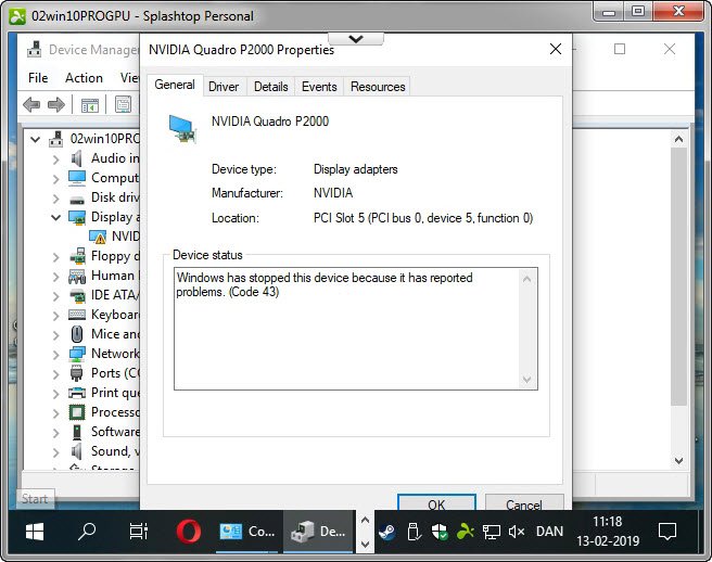

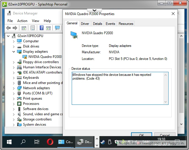

The card was not being initialized and updating the driver didn't help.

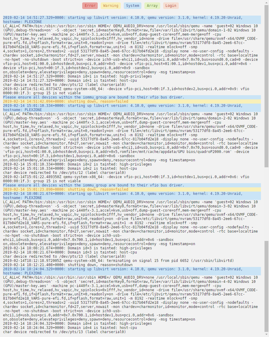

The log file states:
Any input to what to do next? do I need some BIOS file for the card?

There are different things you can test to fix Code43 on NVidia cards. This error mostly occurs when the Nvidia driver notices it runs inside a VM. Change the VM machine type between i440fx and Q35 or setup a VM as OVMF or as Seabios, HyperV on vs off, passthrough a BIOS for the Card, change the PCIe slot the card is placed in. There are a couple threads here in the forum with this topic. There are no general fix that works for everyone.

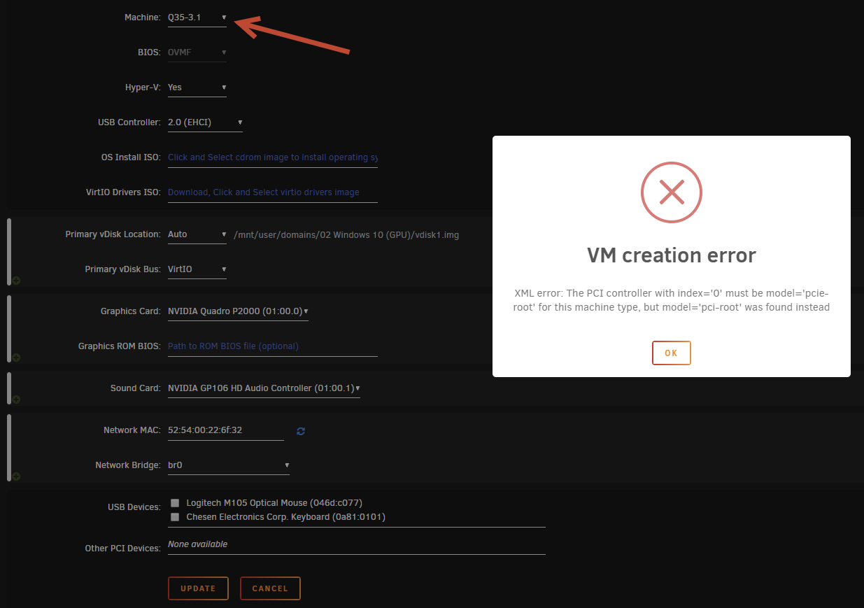

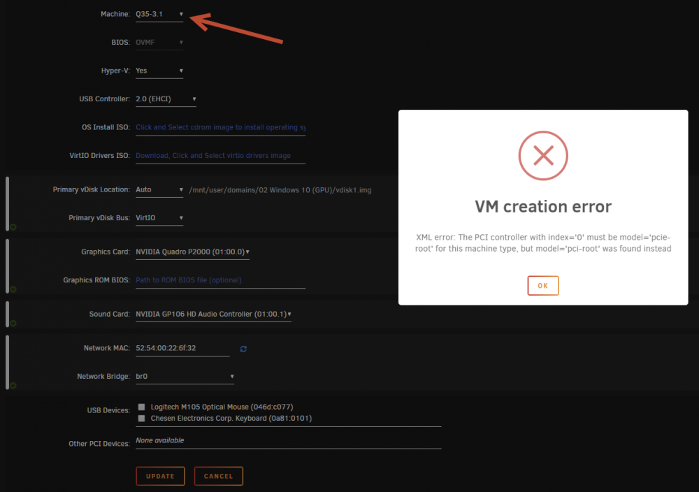

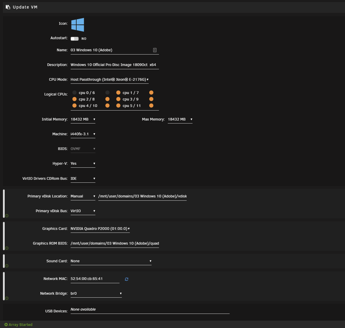

I then tried to change the Change the VM machine type between i440fx and Q35
But that wasnt allowed - Do I have to create a new from scratch?
Also trying to setup VM as Seabios, HyperV on vs off,
is greyed out and cannot be changed
Finally passthrough a BIOS for the Card, I tried looking for a bios file for my Quadro P2000 card at techpowerup.com
but they didnt have one, and I could only see a way to dump it using CPU-Z if it was placed in a local windows machine which I dont have.
Anyone having a vBios for the Quadro P2000 that they would like to share then give me a ping Thanks!

Ok here are the logs still same error in windows
Ok pretty sure this one is it..

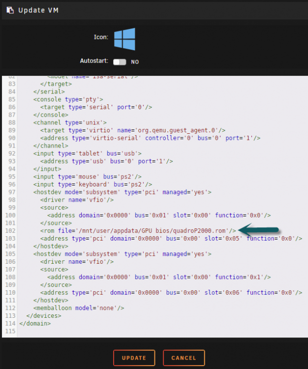

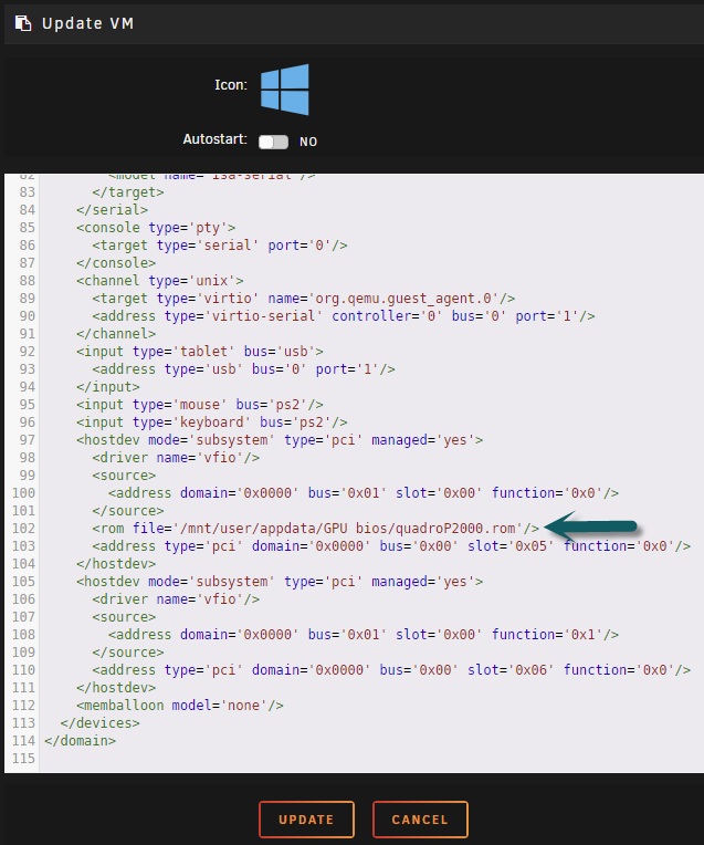

Thanks I already found that file and edited it in one of the other videoes to remove the vbios Nvidia header but at that time it didn't work?
I think it's because I run the script it now seem to work just took a little time to process
Here is the edited file to anyone else who need it:
quadroP2000.rom
Also here is the line added:

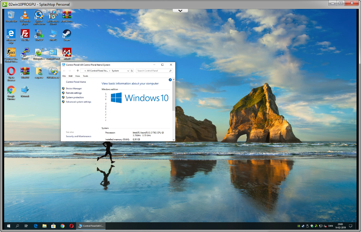

And Voila (Thanks for all your help!)
