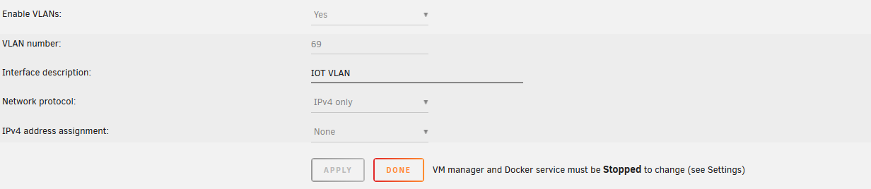

Did you create a VLAN interface in Unraid?
Then assign the VLAN interface to your VM (Network Bridge option)?
I guess I missed this option when I looked before posting. Everything is working now as it should be. Thanks for the help.
