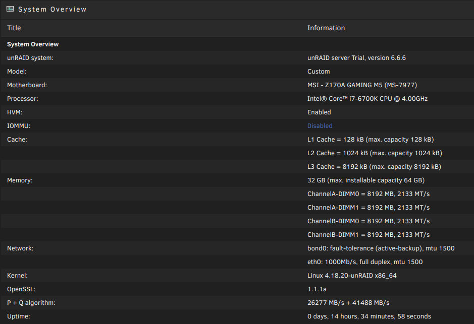

i7-6700K 4Ghz
32GB RAM

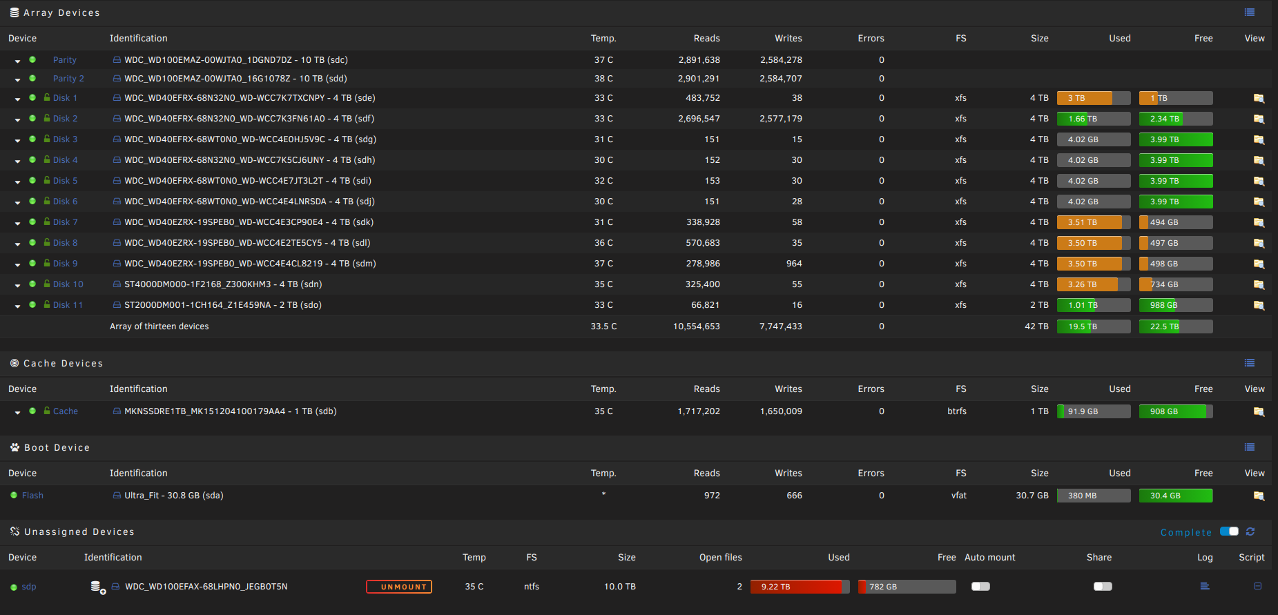

13 Drives totaling 42TB usable, 1TB SSD Cache
Bunch of dockers, no running VMs (yet)
Details:

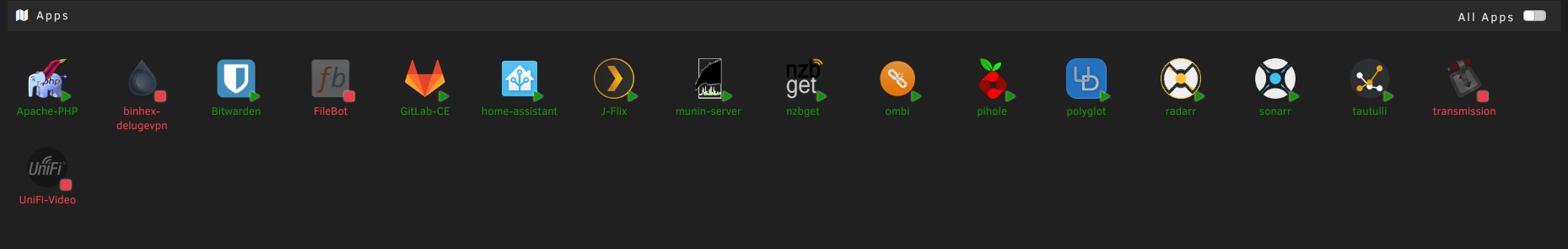

Selection_141.png.dc50447e57fb86358c4601e9f08079b8.pngSelection_142.thumb.png.2a49f587d1e4b899fdfb21afb8f41027.png

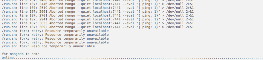

Here is where the problems started. While preclearing the new drives I started seeing 'fork: retry: Resource temporarily unavailable' when trying to tab-complete from the terminal. Then I started seeing issues with my dockers. Unifi-video especially would be stopped every night. I'd look at the log for the docker and see
