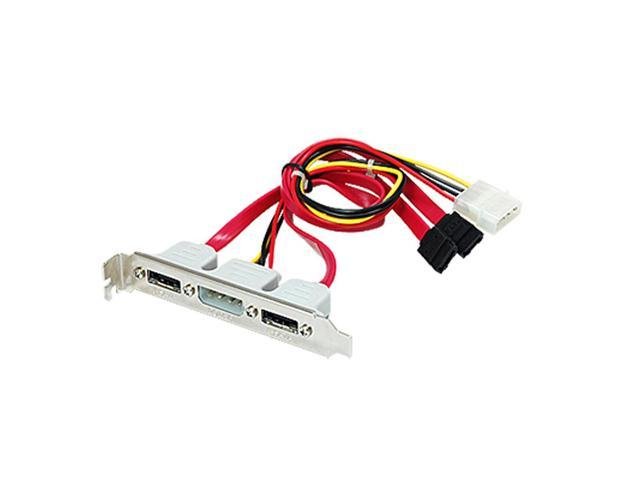

I noticed from your listed spec your pre-clears are on esata ports??
Is this still the case??? Have you tried pre-clearing the drives internally??
The two eSata ports are plugged into two of the MB main internal Sata ports.  It's just a matter of convenience to not have to open the case and move drives around until they have been cleared and usually I've gone through the unRaid replacement before doing it.  I don't actually have a spare drive slot inside so I'd have to pull a spare, then preclear, then replace, then go physically remove the old drives and put the spare back in.
See attached photo, this is what I have on the back of the case and have used to pre-clear a number of drives.  Do you think this extra cable in line could be causing an issue given I've done it a number of times in the past?
I would be tempted to disconnect one of the ports connected to the esata header and directly connect 1 of the problematic drives and attempt another preclear. ive had issues with those cables before, not with unraid but with windows, not saying this is the issue but process of elimination.
