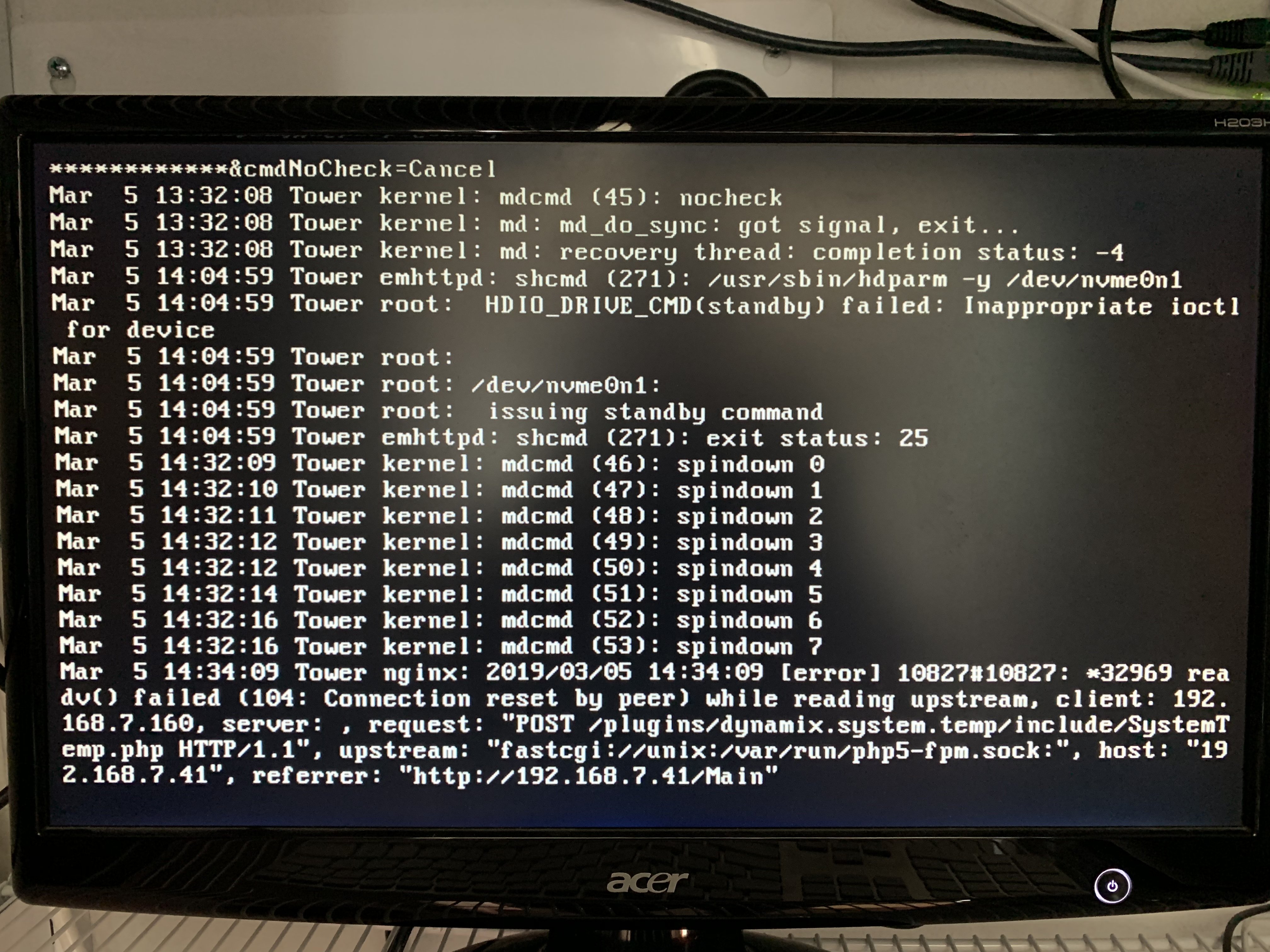

Hello all, I am at my wit's end with this issue. I have been running my current setup for nearly 3 years without a hiccup but starting in January I started experiencing odd behavior. The first sign on something amiss was my server froze, upon restart all of my dockers and VMs were gone. It ran fine for a few weeks until seemingly out of the blue it began freezing every 12 hours or so. I have a monitor and keyboard attached but the terminal was completely unresponsive. I restart and enter GUI mode to see if I can gather more info or if I'm given a warning before freezing, but get nothing. The GUI freezes completely. No keyboard or mouse input accepted. Fix Common Problems reports nothing.
Since then, the following actions have been taken with no improvement in outcome:
1. Uninstalled all VMs, docker containers, and plugins -- system still froze
2. Reinstalled OS -- system still froze
3. Reinstalled all SATA devices -- system still froze
Attached to this post is a .zip containing diagnostics and an image of the syslog when the system was frozen. Please feel free to let me know if additional information is required.

I would start by removing the NerdPack, preclear, and S3 Sleep plugins.  See if removing any of these plugins helps.
If removing these doesn't solve the problem, reboot in safe mode.
If that doesn't help, you should test your memory.
Thanks for the response. Ive actually run a memory test and everything was fine. I will try uninstalling those plugins again...and then Safe Mode.
If I dont have any issues in Safe Mode, what is that telling me? How should I proceed from there?

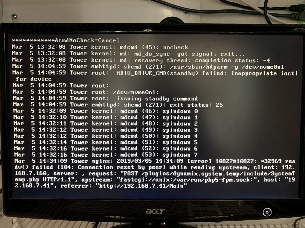

Additionally, Ive attached an image of the most recent lockup from just a few minutes ago.
Nearly three years? AMD only launched Ryzen 7 on 2 March 2017. Either way, that's a very early Ryzen 1700X you're using, so how are you mitigating its tendency to lock up when idling? I don't see either the boot option tweak or the go file tweak in your diagnostics so maybe you've disable C6 state in your BIOS or you've configured normal power idle instead of the default low power idle? Perhaps after a recent BIOS update you forgot to re-select this particular customisation.

You didn't mention clearing the CMOS in the list of things you'd done to try to fix your problem. In that case, disable low power idle in the BIOS and enable SVM and see how it goes. You'll want to enable XMP so that you can set the RAM speed to DDR4-2666 (assuming you have two 8 GB modules), too.
Mar  5 12:47:01 Tower kernel: [Firmware Bug]: ACPI MWAIT C-state 0x0 not supported by HW (0x0)
### [PREVIOUS LINE REPEATED 15 TIMES] ###
Suggest check the BIOS setting ( try enable/disable/auto ), this about Ryzen C6 issue. Besides, I never try S3 sleep plugin on my Ryzen.
