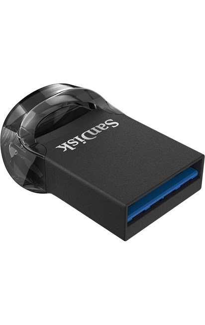

Ultra should work fine but all sticks could go bad of course. I use SanDisk Ultra Fit 16GB USB 3.1 in USB 2 port since a week (changed from Kingston, needed more compact hardware). Working fine but your milage may vary.

Flash is used very little by Unraid. The OS actually runs in RAM. The Unraid OS is unpacked fresh from the archives on flash at boot and then the saved configurations from the webUI are applied. After boot, flash is mostly only accessed when saving changes from the webUI. So capacity and speed aren't required. And USB2 is more reliable. That especially applies to the port you plug flash into, but why not just go for a USB2 flash drive also? I know those Ultra Fits run pretty hot. I have some but my Unraid is booting from the USB2 version of the Fit.

My fit runs hot when writing/reading much data at once. Like booting. But not that hot when the system is running. I think that's normal with small sticks. Less surface area to distribute the heat but not a problem. Designed that way. 😉 I changed my stick from a big Kingston stick to the smaller fit because it was protruding too much at the back of the server. My server is located on the floor in the hallway so I don't want my kids to accidentally hitting the stick and break it (and/or the port or motherboard). 😉
