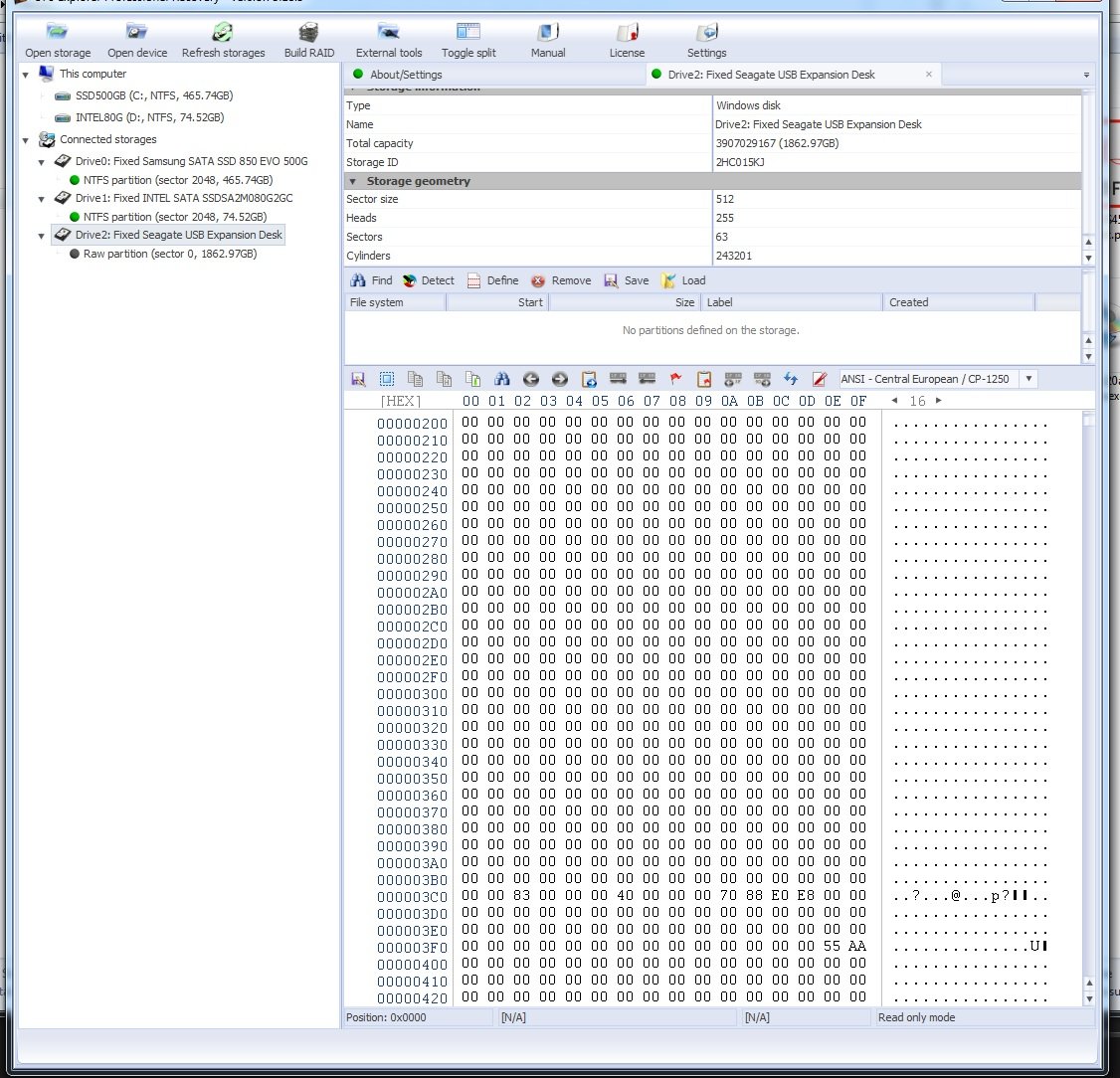

I powered down the server and removed one of the problems drive and the good drive to inspect their content - specifically the first 64 sectors.
For my surprise it turned out that the MBR is in the second sector and not in the first one where it is supposed to be, The XFS partition in both cases starts at offset 64 sectors (hex address 8000)
So I guess I will need some Linux gurus to help me with a command to copy the drive second sector (512 bytes) over the first sector and then zero the second sector, so I do not end with garbage polluting the first 64 sectors. This will be done in array running in maintenance mode to preserve the parity - surprisingly it still shows as a valid.
Thank you

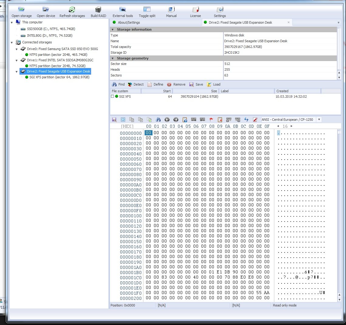

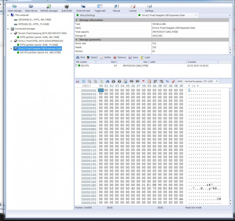

After more reading on the MBR structure I realized I will need to copy the first sector from a good 2TB hard drive over the first sector on the three problematic hard drives. The zeroing of their second sector will be only the gravy.
Attached is a picture of the good HD first sector and one of the bad ones second sectors - partition size is hex E8E08870 , corresponding to decimal 3,907,029,104 sectors of 512bytes each and starts at hex sector 00000040

Hmm, I was thinking more of using these:
1. Zeroing the first two sectors of the 3 unmountable drives:
dd if=/dev/zero of=/dev/sdX bs=1024 count=1
2. Copying the first sector (MBR - the partition info) from the good 2 TB hard drive into the first sector of the other 3 drives:
dd if=/dev/sdX of=/dev/sdY bs=512 count=1 , where the sdX is the source with good MBR
3. Reboot
This should set me with 4 hard drives having the same volume ID (in the Microsoft sense - 4 bytes starting at location 0x1B8), but I am not sure if Linux (Unraid) uses it. If not advisable, then I will have to manually remove the drive, attach it to my Windows computer and manually change one bit of this volume IDs - which will result in three parity errors, but I can live with that - unless there is some HEX utility editor that I can use with Unraid to manually modify a bit
I just need need some Linux guru to confirm that the the commands above are good
