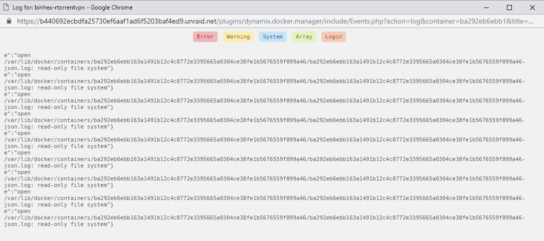

Some of my containers were turned off this morning, while others are running. When I try to turn a container on I get this:

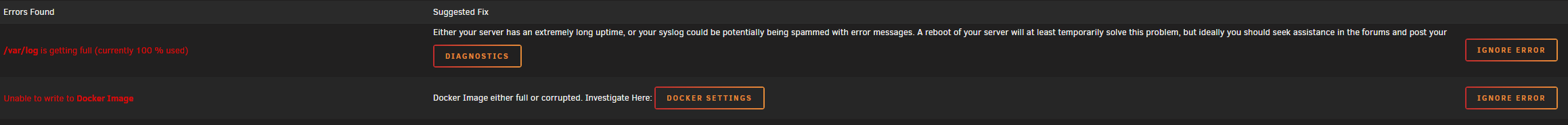

Running a Fix Common Problems test I get this:

Most of them give "cannot read directory" "input/output error".

Your docker.img file is trashed, and the syslog is being spammed with errors from it, hence the error FCP is throwing at you.
Your recourse is to stop the docker service via Settings - docker.  Delete the image from there, then re-enable the service, hit the apps tab, previous apps, check off whatever you want and hit install multi.
