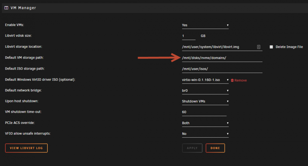

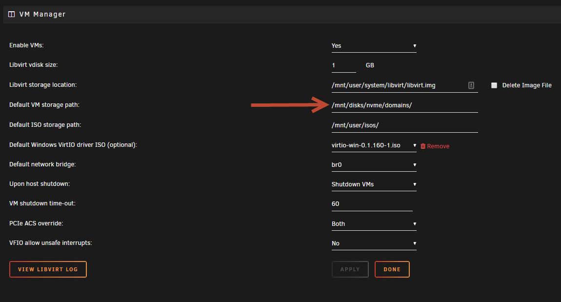

I did the copy to the nvem drive (After stopping the VM service) and then pointed to the new Domains location:
I then started VM service and now I get the:
