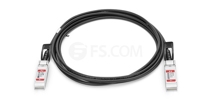

I also have a 10gbE connection directly from the server to my desktop using mellanox 10gb/E cards using this cable

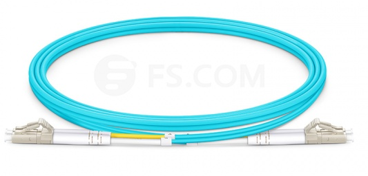

to work with this cable (LC-LC UPC Duplex OM3 Multimode Fibre Patch Lead 2.0mm PVC (OFNR) 30m)

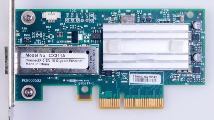

here are the cards I have, they say ConnectX-3 so should be ok?

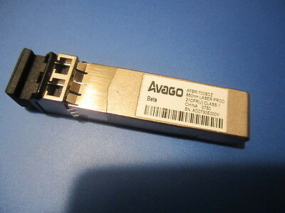

BTW, for you or anyone else coming up on this thread in the feature, I use these transceivers with both the ConnectX-2 and X-3:
Avago AFBR-700SDZ-QL

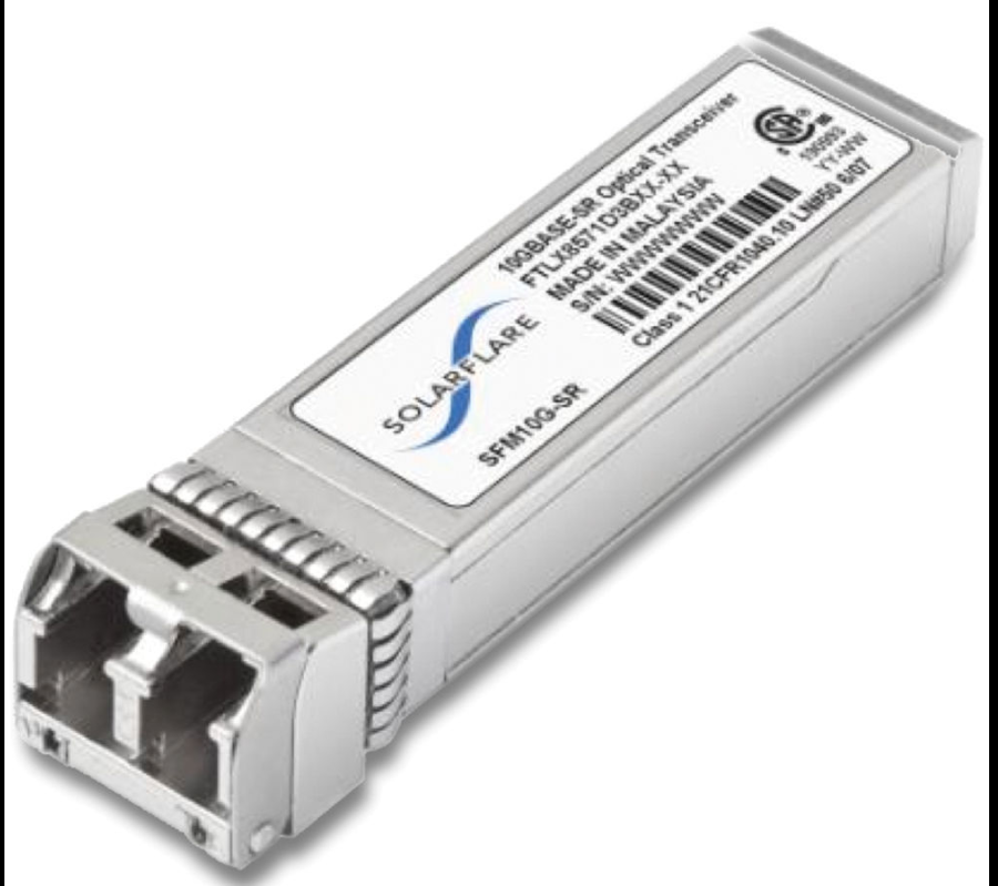

Many Thanks Johnnie, I will report back on my ones when I get the cable.. I have to admit I thought I had a bargain as they are quite expensive but I got 2 new sealed ones on ebay for £12 delivered! but they will only be cheap if they work 😄
Just to update,
those transceivers I bought (2X Brand New sealed Solarflare SFM10G-SR 10GBASE-SR 850nm 10 Gb/s SFP Transceiver) £15
work perfectly with my mellanox cards (MNPA19-XTR 10GB Mellanox ConnectX-2 10Gbe 3m SFP+ ) £35
with this cable (Brand New Sealed 20m 10Gb OM3 Aqua Fibre Optic LC LC Duplex MM 50 125 LSZH fibre patch Cable) £9
