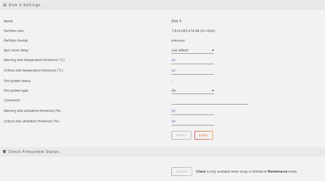

Looks like unRAID is able to identify the partition  format, any ide how to solve this or if that could be the issue ?

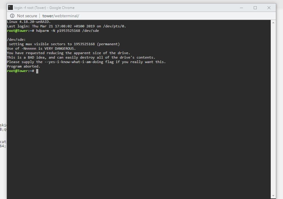

*EDIT* found out it can be done via the web interface ">_terminal" option but it is warning me against doing so, am I missing something or should I not do the "hdparm -N p1953525168 /dev/sde" to fix the issue ?

Found out it can be done via the web interface ">_terminal" option but it is warning me against doing so, am I missing something or should I not do the "hdparm -N p1953525168 /dev/sde" to fix the issue ?
Note that if you disable HPA on disk4 now, Unraid will complain it's wrong, since it was added with HPA enable.
The warning appears if you're using a smaller sector size instead of full size, for all purposes creating a HPA, so you're doing it on the wrong disk or using the wrong value.
My bad used the wrong value, did not know that it needed to be changed from what was used in the HPA thread you linked to, sorry about that, so if I am correct the value I should use for disk 5 is: 15628053168 so the command should look like this "hdparm -N p15628053168 /dev/sde" ?

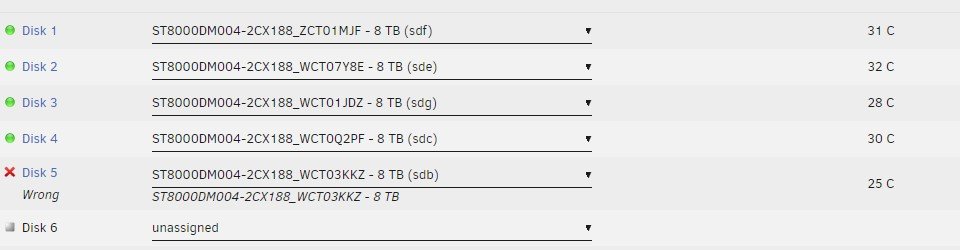

Yes, if disk5 is sde, it was sdb in the screenshot you posted above, though it can change after a reboot, mostly if SATA connections are swapped around, I suspect you're getting sde from the link, in doubt and if you rebooted since post new diags, assuming it's still sdb it would be:
hdparm -N p15628053168 /dev/sdb
18 minutes ago, Denner said:
How do I go about excluding disk4, and the rest of the disks for that matter, so that the HPA fix is only applied to disk5 and not all the disks ?
Command is only applied to the disk specified, using the correct identifier, as shown after the serial number in the GUI, sdb, sdc, sdd, etc.

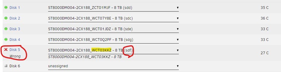

Just did a screen-grab, and attached it, and it looks like the disk5 is named "sdf" and in that case the command should look like this "hdparm -N p15628053168 /dev/sdf" to fix disk5 HPA issue am I correct ?
Yes, that's correct, identifier is different from before because of changing the controller to AHCI, when ports 5 and 6 were in IDE mode they got assigned first during boot.
Also remember that if you can't disable HPA in the board bios it might get recreate on the same or another disk on future boots.
