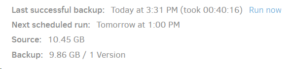

It's been a while since I last tried it, so did another quick test so see if it is as slow as I remember, at least on a lower end CPU which is what I have on my little work server, still better than the OP as it's a dual core AMD Athlon 64:
If my math is correct that's around 4MB/s, so as slow as I remember, using default settings with encryption disabled.
