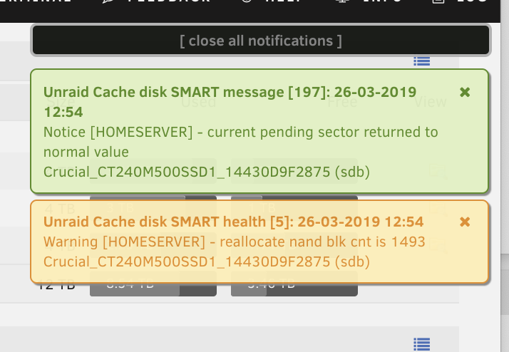

I tried new cables and got the errors that I screenshot, the attached log and the same "unmountable" error that I had before.
I am going to lose everything on the cache drive? I've got time tomorrow to replace it but I would rather not lose everything that was on it.

I needed to get the server back up so I replaced the cache drive. I'll look into getting the data off the old drive from the above link. Any additional help appreciated.
