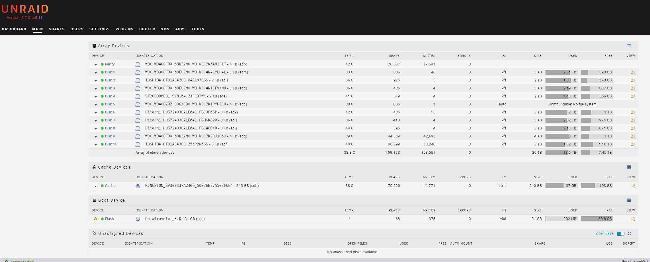

My unraid key died and I replaced it with a new one.  I did not have a backup of it, stupid me..
Anyways after setting up new key and set up my array with a screenshot I had, all disks came back up fine except 1 (Disk 5) i get "Unmountable: No file system" on it
I rebooted the unraid server a few time, didn't help.
Anything I could do?

        - resetting contents of realtime bitmap and summary inodes
        - traversing filesystem ...
        - agno = 0
        - agno = 1
        - agno = 2
        - agno = 3
        - traversal finished ...
        - moving disconnected inodes to lost+found ...
Phase 7 - verify and correct link counts...
resetting inode 128 nlinks from 1 to 2
        XFS_REPAIR Summary    Fri Mar 22 16:11:03 2019
Phase           Start           End             Duration
Phase 1:        03/22 16:11:02  03/22 16:11:03  1 second
Phase 2:        03/22 16:11:03  03/22 16:11:03
Phase 3:        03/22 16:11:03  03/22 16:11:03
Phase 4:        03/22 16:11:03  03/22 16:11:03
Phase 5:        03/22 16:11:03  03/22 16:11:03
Phase 6:        03/22 16:11:03  03/22 16:11:03
Phase 7:        03/22 16:11:03  03/22 16:11:03
Total run time: 1 second
done
root@Tower:~#
ok found it, i had to turn off array, change it's FS from auto to xfs.
Then in maintenance mode I had check file system..
Its running now.
ok this is results..
Phase 1 - find and verify superblock...
Phase 2 - using internal log
        - zero log...
        - scan filesystem freespace and inode maps...
Metadata corruption detected at 0x4392a8, xfs_agf block 0x1/0x200
Metadata corruption detected at 0x4392a8, xfs_agf block 0x15d508ec9/0x200
Metadata corruption detected at 0x462fc0, xfs_agi block 0x2/0x200
bad uuid e0ba330f-b396-470f-8dfc-ee8c32745fe8 for agf 0
bad uuid e0ba330f-b396-470f-8dfc-ee8c32745fe8 for agi 0
would reset bad agf for ag 0
would reset bad agi for ag 0
bad uncorrected agheader 0, skipping ag...
Metadata corruption detected at 0x4392a8, xfs_agf block 0x74702f99/0x200
Metadata corruption detected at 0x462fc0, xfs_agi block 0x15d508eca/0x200
bad uuid e0ba330f-b396-470f-8dfc-ee8c32745fe8 for agf 3
bad uuid e0ba330f-b396-470f-8dfc-ee8c32745fe8 for agi 3
would reset bad agf for ag 3
would reset bad agi for ag 3
bad uncorrected agheader 3, skipping ag...
Metadata corruption detected at 0x462fc0, xfs_agi block 0x74702f9a/0x200
Metadata corruption detected at 0x4392a8, xfs_agf block 0xe8e05f31/0x200
bad uuid e0ba330f-b396-470f-8dfc-ee8c32745fe8 for agf 1
bad uuid e0ba330f-b396-470f-8dfc-ee8c32745fe8 for agi 1
would reset bad agf for ag 1

That's a strange filesystem corruption, are you sure you didn't assign old disk5 as parity and old parity as disk5? Double check the serial numbers in the screenshot you have.
If you're sure assignments are correct remove the -n flag for xfs_repair to try and fix things.
All drive assignments appear to match a diagnostic posted on March 7
https://forums.unraid.net/topic/78533-loads-of-gz-files-added-to-root-dir-of-unraid-usb-key/?do=findComment&comment=728325
EXCEPT disk5 is a different disk. So not a swap but also not sure when or how a new disk5 was introduced.
For future reference, you can always download a zipped copy of flash at Main - Boot Device - Flash - Flash Backup.
Even after you get your array fixed, by not having a backup of flash, you have lost all settings you made in the webUI, including docker templates.
Good idea checking previous posts, disk5 was likely upgraded since it was 3TB at the time, then the OP should run xfs-repair without -n
My disk 5 was replaced not long ago.  And was working fine until the usb key died.
I did run the xfs-repair without -n and it came back up.  But had no data on it afterwards.  It only had a gig or 2 on it, and I had the data on my main computer still, so nothing lost.
Thanks for all the help!
