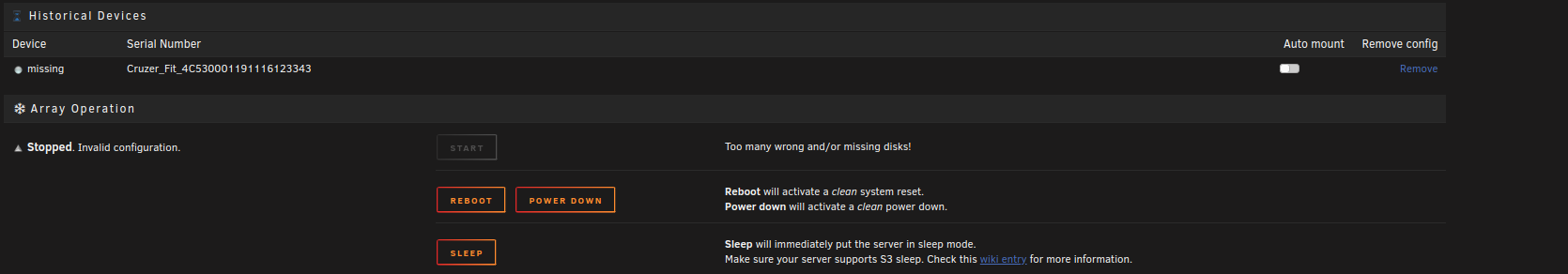

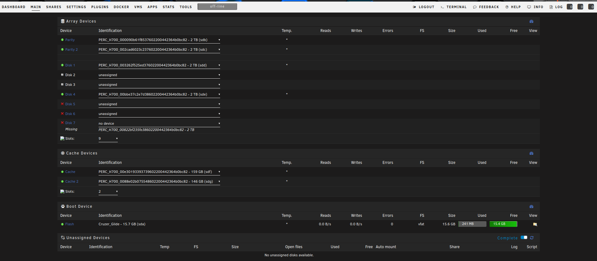

You have too many missing disks. Post a screenshot of Main - Array Devices and Main - Array Operations.
I had the same amount of drives before I rebooted. I don't believe I've made any new additions. I've attached the screenshots.
Your screenshot is showing you have 3 missing disks and it says you have too many missing disks. Which agrees with your diagnostics. Did you used to have more disks?

You have too many missing disks. Single parity will only allow you to run with one missing disk. And will only let you recover the data of one missing disk.
Do you mean you would now like to simply forget about those other disks and any data they might have had, and go ahead and run with fewer disks than you had before?
If so, then you will have to set a new config and rebuild parity.
Probably you shouldn't do anything but get rid of that controller and work with us to get all disks working again.
I think it's possible none of your disks have failed and the controller is the cause of all your problems. That and the fact that you didn't ask for advice when you had the first problem and just decided to do something that made things worse.
