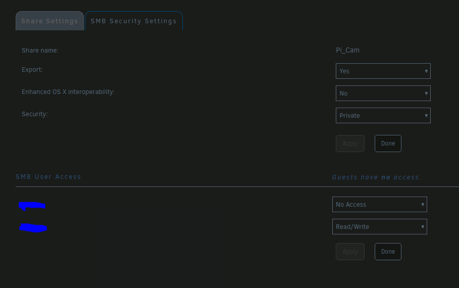

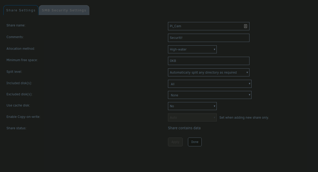

Screenshots of the share is below:

I don't see anything either on the permission side but why do you have your DHCP lease set to an hour.
Also have your tried connecting to the share via a Windows machine?
