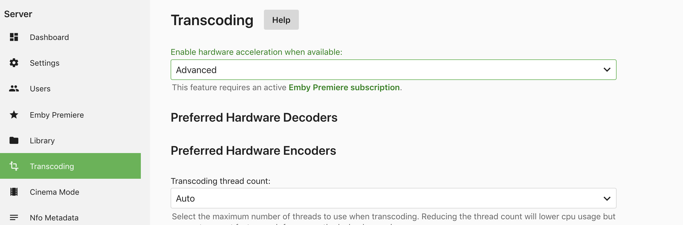

After all this I am not seeing under the transcoding tab of emby and selecting advanced for hw transcoding the intel gpu.
I am really stuck at this point and don't know how to proceed. Any help would really be appreciated.

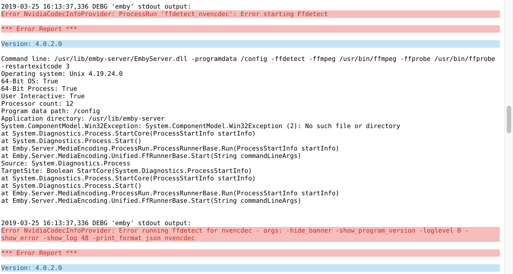

Additionally seeing this in the logs which im not sure if this has anything to do with it.

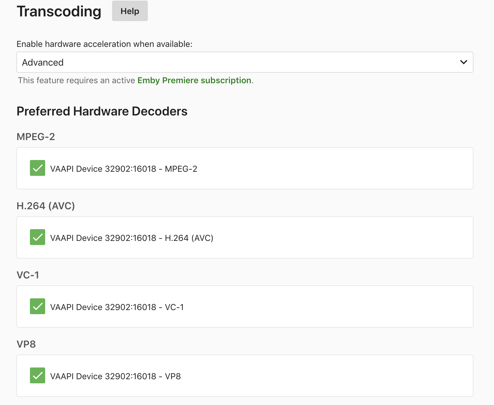

Guys i was using the binhex docker of emby and now changed to emby/embyserver and i think its working now. I do see some spikes on the cpu but i dont know if this is normal and what i would expect to see? Also seems like the video is very laggy.

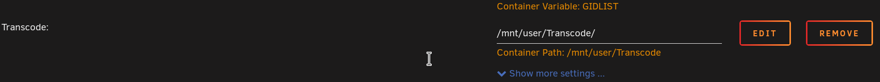

Nano,
I also struggled with this for my Xeon E3-1275 & ASRockRack  C236WSI.   Now that you have the device passed through correctly to the Emby Docker, you need to specify a transcode directory:
Create a New Share (SSD Cache Only) called Transcode (or whatever you want to call it)
Stop Emby Docker
Add new path to your transcode share:
Start Emby Docker

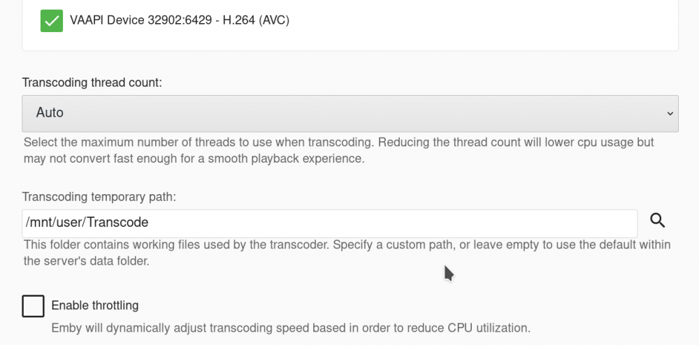

Inside Emby Server Admin - change the Transcoding temporary path directory to your new path:
See if your transcoding performance improves.
Pancho
Edited by pancho
I added a new share "transcode" and mapped it in emby and seems good now! When i have a movie playing that transcodes and i leave the hardware transcoding off i am seeing about 50% utilization on my CPU and when i turn the hardware on i am seeing about 10%. Is that what i should expect to see?
