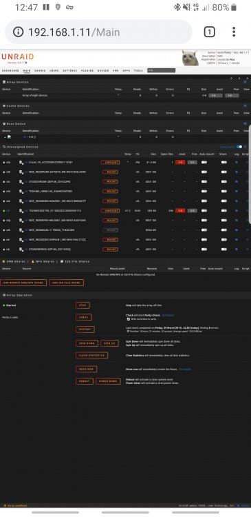

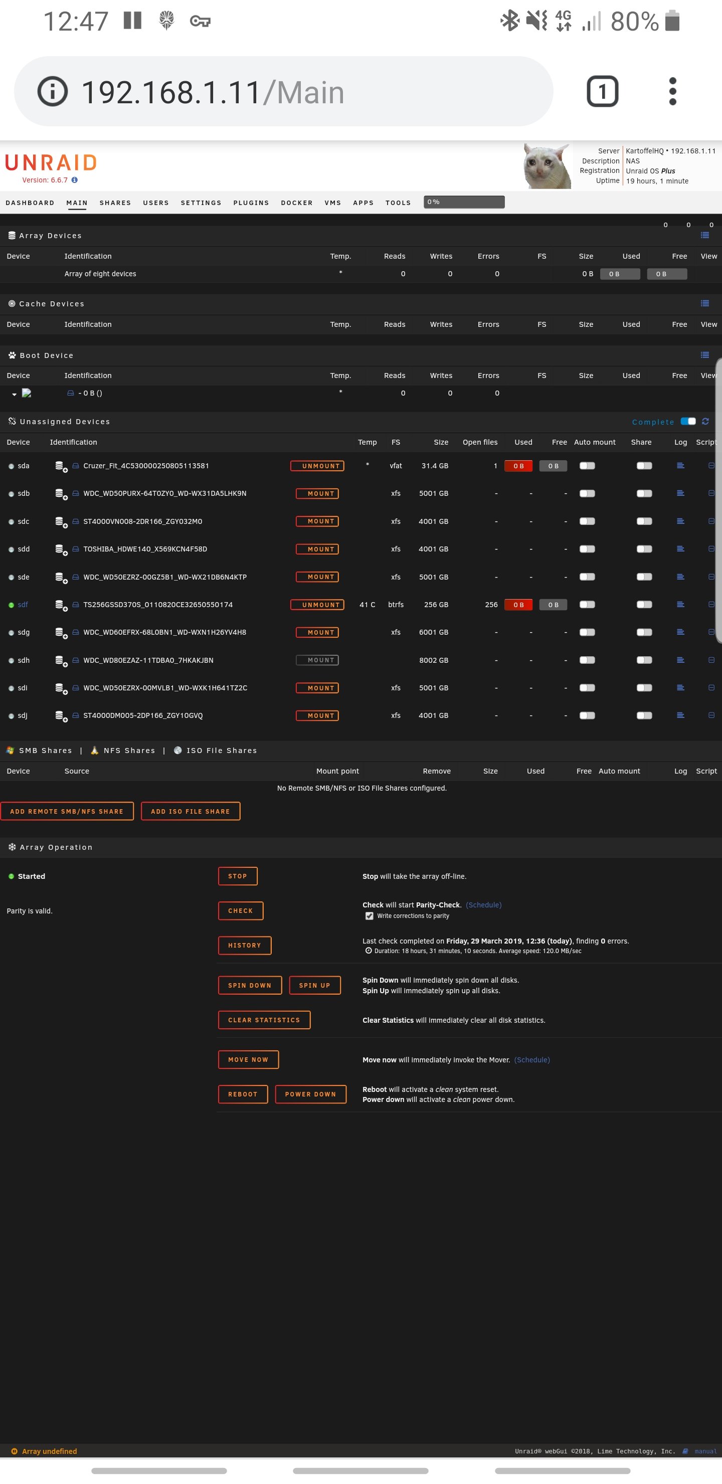

The rebuild just finished without errors. Now it looks like this in webui.
Docker Services and the VM are running.

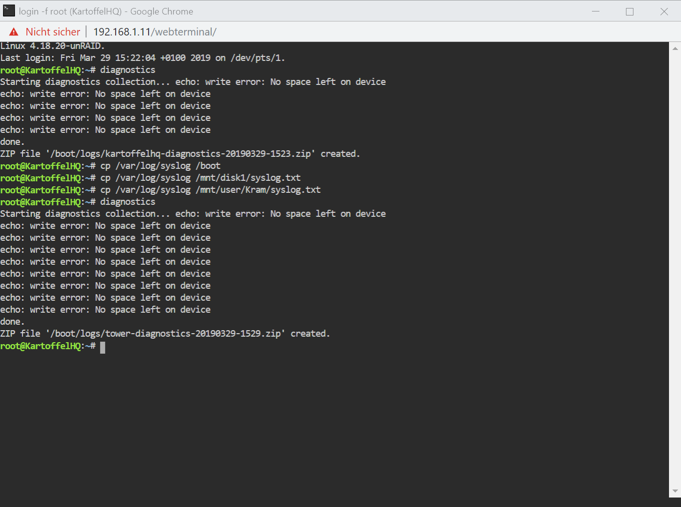

I can't get a diagnostics file via the webUI.
Via the console I get the error message from the screenshot.
Now I tried to capture the syslog, but to get it I have to shut down the server and read the USB stick on my computer.
At the bottom you can see how the messages "Array undefined" and "Array Started" alternate in different intervals.

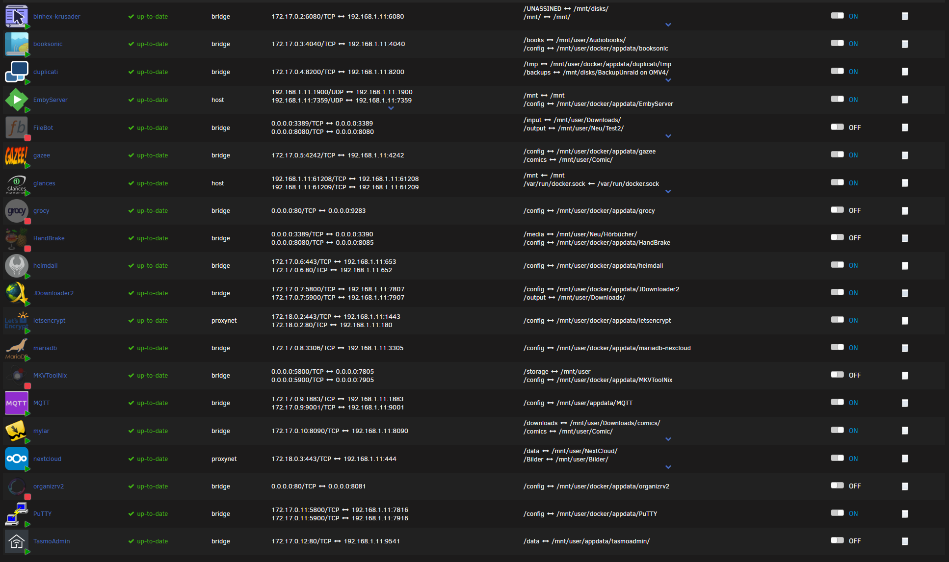

1 minute ago, smeeee.again said:
rootfs 5.8G 5.8G 0 100% /
This is going to play havoc with your system.  Most likely a misconfigured docker container is writing to RAM instead of a share (ie: writing to /mnt/appdata instead of /mnt/user/appdata)
Your only recourse though right now is to reboot
powerdown -r
and then investigate
The Docker Containers are configured correctly. Most of them have been running without errors for some time and the newest ones are deactivated to exclude them as a source of errors.
