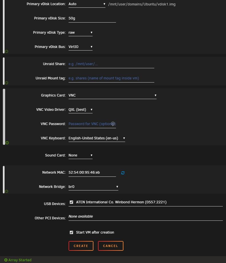

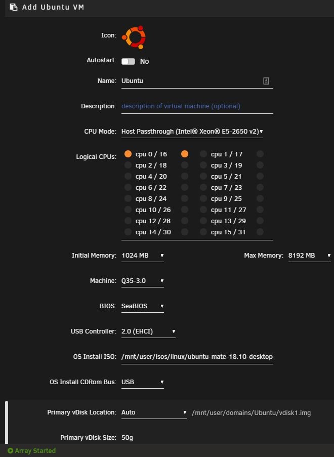

This is what my config looks like:
Change "OS install CDRom Bus" to SATA and don't pass through the ATEN until after the install.

Use a fixed amount of RAM not a range from 1024-8192. Set both values to the same.
This did the trick!!! 🙌🙌🙌
