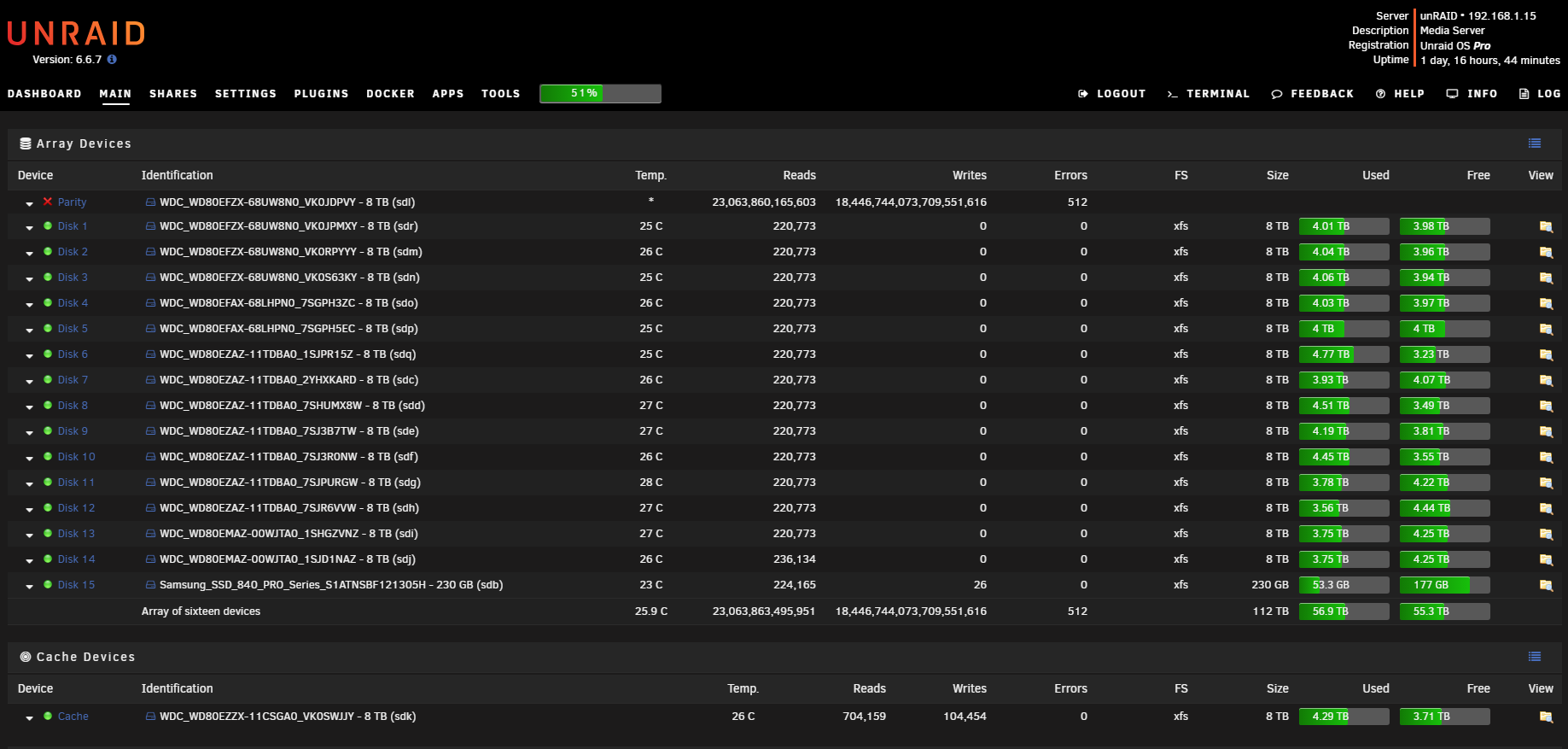

Two days ago my Disc1 was booted from the array with a red X.  The unRAID main page showed that Disc1 had over 15,000,000,000,000,000,000 writes and even more reads.  Fortunately, I had run a parity sync just the day before with zero error.  I had also just run an extended SMART test with zero errors.  So I reseated the power and SATA cable on Disc1 and rebuilt the drive.  Everything went fine and the drive rebuilt and is back in action.
Today I started a parity sync to double test (without writing corrections to parity) and shortly there after my parity drive got booted with a similar error.  Attached is the log and a screen capture on the unRAID Main screen showing the huge number of reads and writes to parity.
Both drives are connected to the same SAS port so I reseated the SAS cable, swapped the four drives on the that SAS input with another SAS input, and then reseated all the SATA cables.  I am now rebuilding parity on the same parity drive.
Please provide any advice.  This system has been running stably for years.  About four months ago, I upgraded any remaining drives below 8TB to 8TB drives, but my parity and Disc1 drives have been in the system for over 2.5 years and are not new.  I find it unlikely that they would both go bad three days apart in the exact same way.

Disk dropped offline then reconnected as sds, SMART looks fine, so likely a connection issue, if it happens again to one of those 4 disks replace/swap the miniSAS cable, could also be power related, PSUs do go bad.
Well, my thoughts exactly.
I didn't notice that when the parity drive reconnected it was reassigned sds, so thanks for pointing that out.
I am actually shopping for a miniSAS cable now just to have on hand.  I suppose it could be the one LSI9211-IT controller too :(  The power supply is just over a year old and is well regarded and under worked.  I doubt it's the PS, but at least if it is, it's under warranty and I have a spare.

So I just upgraded my SAS controllers and when I did, I found that one of the power plugs on my modular power supply was not inserted all the way.  It just fell out while I was working.  I'm pretty sure this was the entire issue and I can't believe that I didn't have more problems than I did.  One of my hard drives on that power rail now has two UDMA CRC errors as well.  I'm pretty sure that's a result of a momentary power glitch on that drive...
