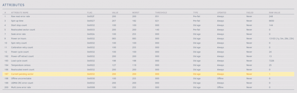

If you look on the Dashboard, you should be getting a SMART warning for that disk. If you mouse over it should tell you something about it. You can also click on the disk in Main to get to its page and look at the attributes.
The disk has one pending sector. It's not clear if that caused the disk to be disabled or something else.
Your syslog seems to indicate you rebooted with the disk already disabled, and it is currently doing a correcting parity check. Is that correct? We can't see what happened before the reboot to cause the disk to be disabled.
Not related but you have a 40G docker image that is filling up. If you have your docker applications configured correctly it is very unlikely you would ever need even 20G, and making it larger than 20G doesn't fix anything, it just makes it take longer to fill.
Here is a screenshot of the attributes. yes i know the docker size is probably too big but i do have issues with it filling up. not sure what i have set wrong. i use home assistant and influxdb and mariadb which are the only ones that i can think of that may grow so i am sure it is one of those.
