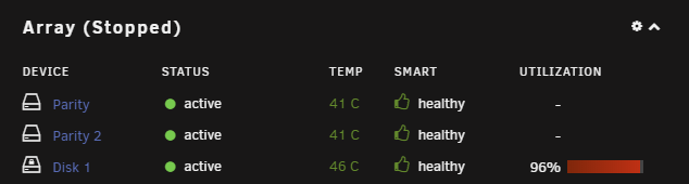

I have been forced to cut the power 3 times since I started using Unraid instead of primary Synology server.
I know this could be caused by me running the Version: 6.7.0-rc7 release
And every time its been in relation to a docker application that wouldn't stop (Plex) or UAD not finding mounted drives
I typically see a stopped on the UI like this:
But the Array is still mounted, and it's just keeps stating:
Logfiles: Can't get them when the server is in this "state"
I do have console:

Any input to what I could do when this happens next time?
