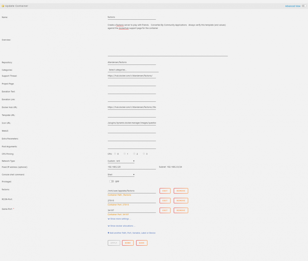

I think you should show a screenshot of the docker settings page for that container.    The -e option suggests you have set up environment variable mappingrather than port mapping.

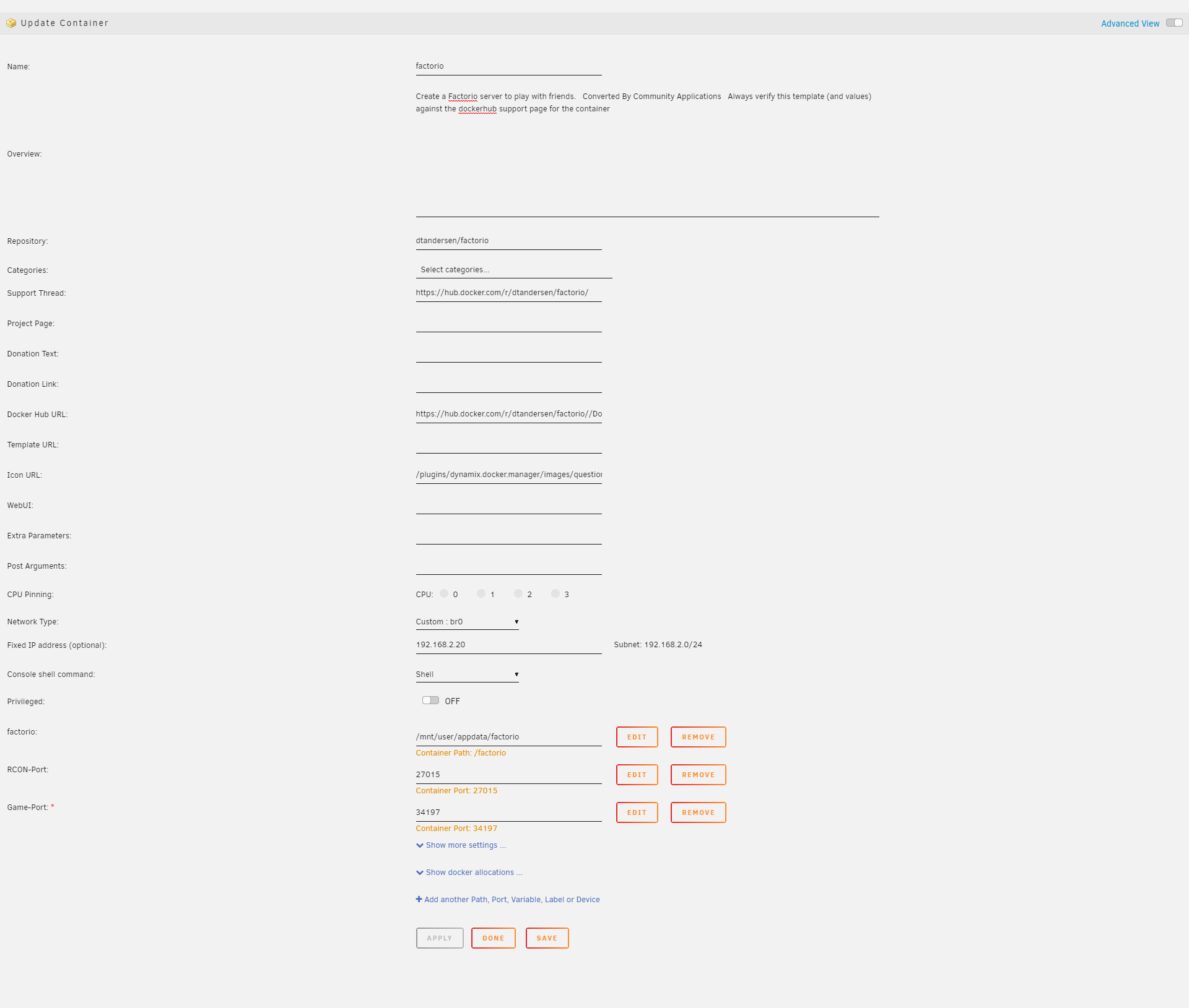

Here's a screenshot of my container configuration
The weird this is, that all of my docker containers (e.g. Plex) are using the "-e" option... 🤔
The reason is that you have set it to use a bridge and assigning an IP. Then the container port will be used and you can't publish any ports. It's the same as using host networking. Unraid then switch the -p to -e automatically. Don't know why they did that instead of just removing it from the run command though....
