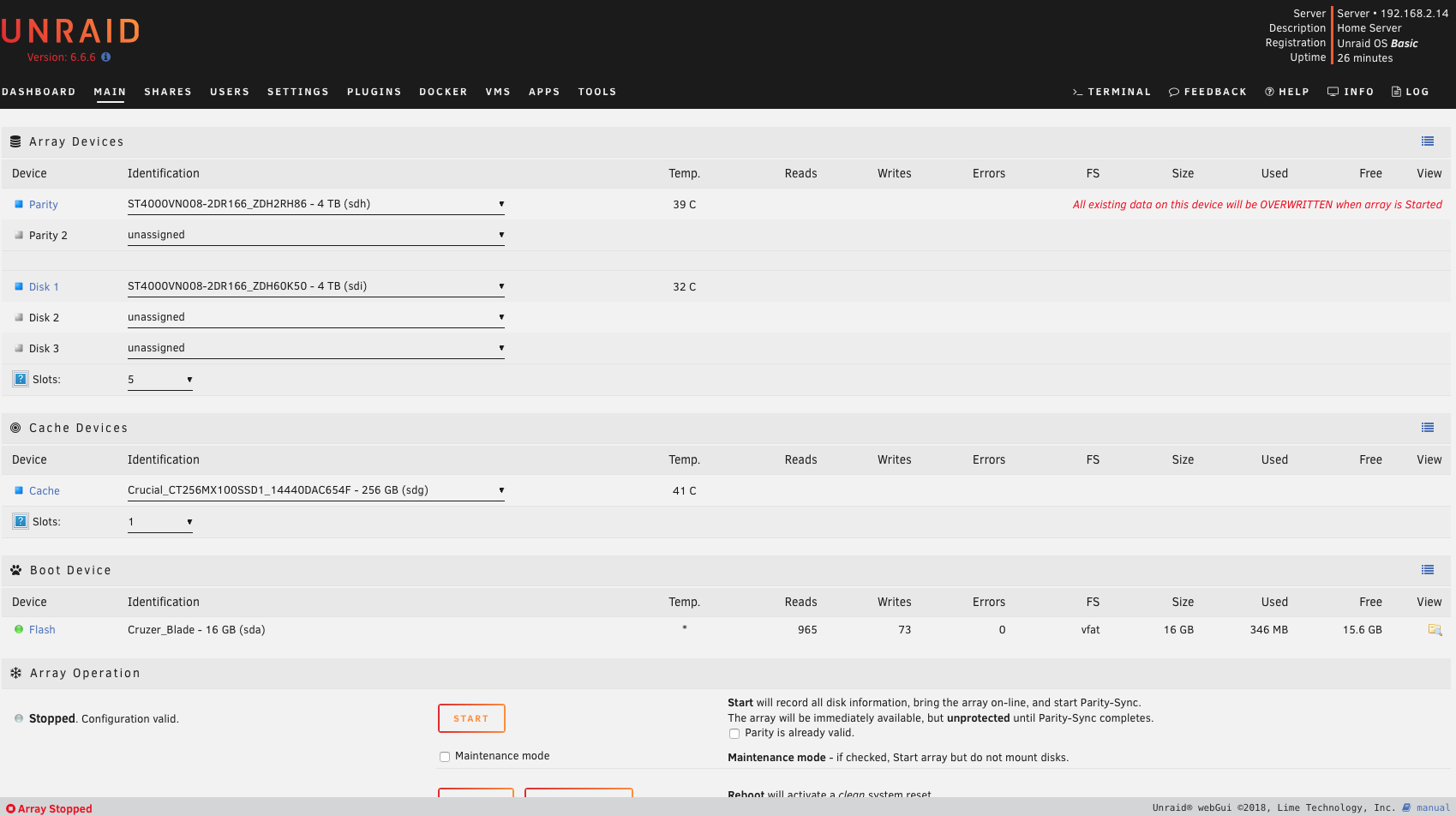

So I tried to replace 2x 1TB drives with a 4TB one. My parity disk is also a 4 TB disk. I powered down, removed the old drives, installed the new one and tried to rebuild the array. I googled some and red somewhere about the new config command, I didn't even read the text it came with but I clicked it anyway and choose preserve parity drive config thinking I could rebuild afterwards.
Long story short, I'm stuck at this screen. My parity drive still contains all data but I have no Idea how to or if its possible to rebuild the array from the parity drive at this point.
I still got the old drives so worse case I should be able to rebuild from that right? Otherwise I still got a backup of all my data but that isn't recent and I would have to re setup the whole server.
Parity doesn't contain any data. Single parity PLUS all other disks allow a single disk to be rebuilt.
So, you can't really do what you were trying to do. You will have to use the original disks to get any of your data.
There are a couple of ways you could do this, but I am going to tell you the way that will lead you to what you should have done.
First, New Config with all the original disks in their original slots. Check the box saying parity is already valid. It should be assuming you haven't left anything out of your description, but I would feel better about it if you did a noncorrecting parity check after you get your array back to its original configuration.
Then, you can do the disk replacement the correct way, one disk at a time.
Try this much and let us know if you have any questions or problems, and we can go on to the next part.

Thank you, I now have my server back in its old state and are doing a non correcting parity check which will finish in like 12 hours. How would I proceed to replace the two 1tb drives for one 4tb drive?

You can't actually do that.
Replace one of the 1TB drives with the 4TB drive and let it rebuild. That will give you a 4TB drive with all the contents of that 1TB drive.
Simpler really just to leave that other 1TB drive in unless there is something wrong with it. Then later when you get another larger disk you can use it to replace/rebuild the other 1TB.
If you really want to remove it, you can copy its data to the new 4TB drive, then New Config without that 1TB drive and rebuild parity.
The wiki is a bit wordier and more detailed than what I described, but basically what I said was the same as in the wiki section labelled "Safer Method"

Oh oke I'm sorry. The Parity-Check has finished and hasn't encountered any errors. Here are my diagnostics files.
