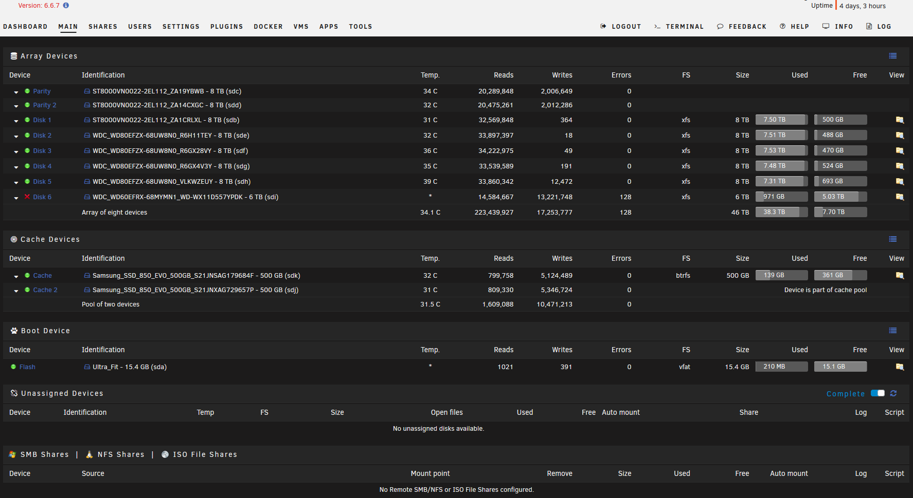

I was copying data to my unRaid Server and didn't notice that the cache ran full. I meanwhile changed the setting on the share to not use the cache and cancelled the copy-process. When I checked the unRAid dashboard I saw a lot of notifications that the cache was full andsomewhere in between that a drive was disabled.
A parity check was running the past hours and still is.
I attached the diagnostics file.
The mover is running (I assume, as I can see space getting freed up on the cache drives).

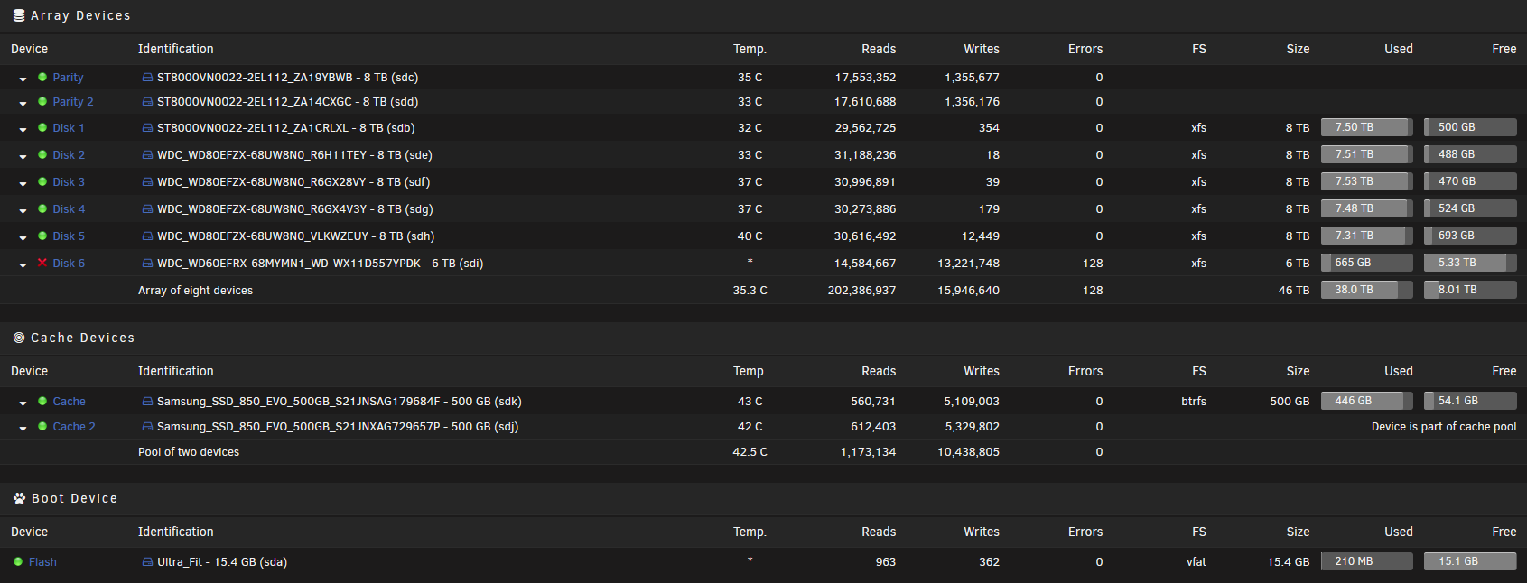

This  is my Main dashboard:
How come the drive was disabled? And what can I do now?

It's better to not cache anything for a large initial data load, since cache will not have the capacity. And it would also be better to wait until the initial data load is complete before setting anything else up, such as dockers.
You will have to rebuild disk6 after checking all connections. You may have to reformat cache and install your dockers later.
A disk being disabled means that a write to it has failed.    When that happens Unraid stops using the physical drive and instead ‘emulates’ it using the combination of the parity drive and the remaining data drives.    Since writes can still be made to the ‘emulated’ drive this means that the physical drive is no longer in sync with the ‘emulated’ one.
Very frequently there is nothing wrong with the drive itself, and the write failure was caused by an external factor (cabling, power, controller).    The recovery process is to rebuild the ‘emulated’ drive back onto a physical one.    If the drive has really failed this will be to a replacement drive.    If it is determined that the disk has not really failed then it is possible to rebuild back to the original drive to bring it back into line with the ‘emulated’ one.

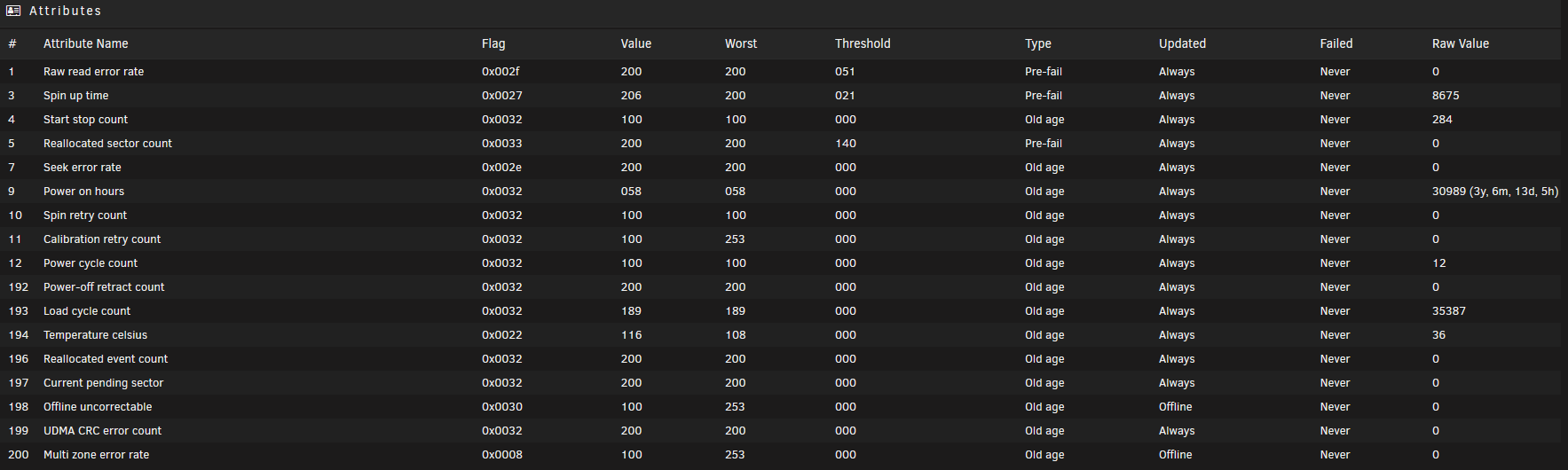

SMART for disk6 looks OK.
Your screenshot shows a lot of writes to both parity disks. Did you have valid parity before adding disk6?
I think so. I did a pre-clear on disk 6.

OK, I guess those writes to parity are just updates due to writing disk6. You say it is doing a parity check currently? Why?

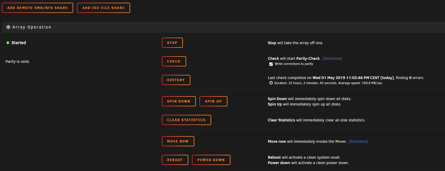

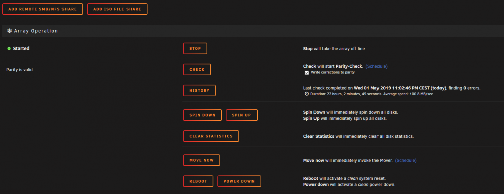

Post a screenshot of Array Operations.

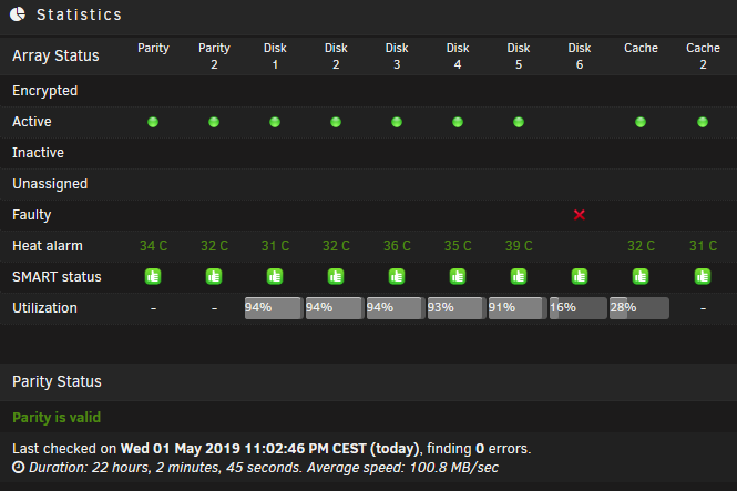

The parity check was running because I had it scheduled to run on the first of every month. It just finished now:
The Main screen looks like this:
The SMART for disk 6 looks like this:

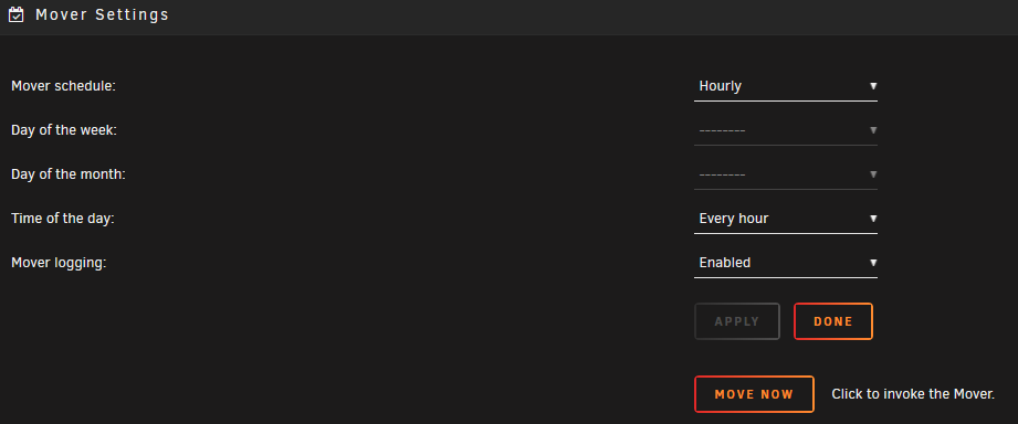

The free disk space on the cache stabilised. When I check the scheduler settings it doesn't show as the Mover working
Is there another way to show you what the array operations are?

The wiki link you posted earlier has the correct procedure for rebuilding to the same disk.
Thanks very much!
I removed the disk and replaced it with another WD Red 6TB I have. The array is now rebuilding.
