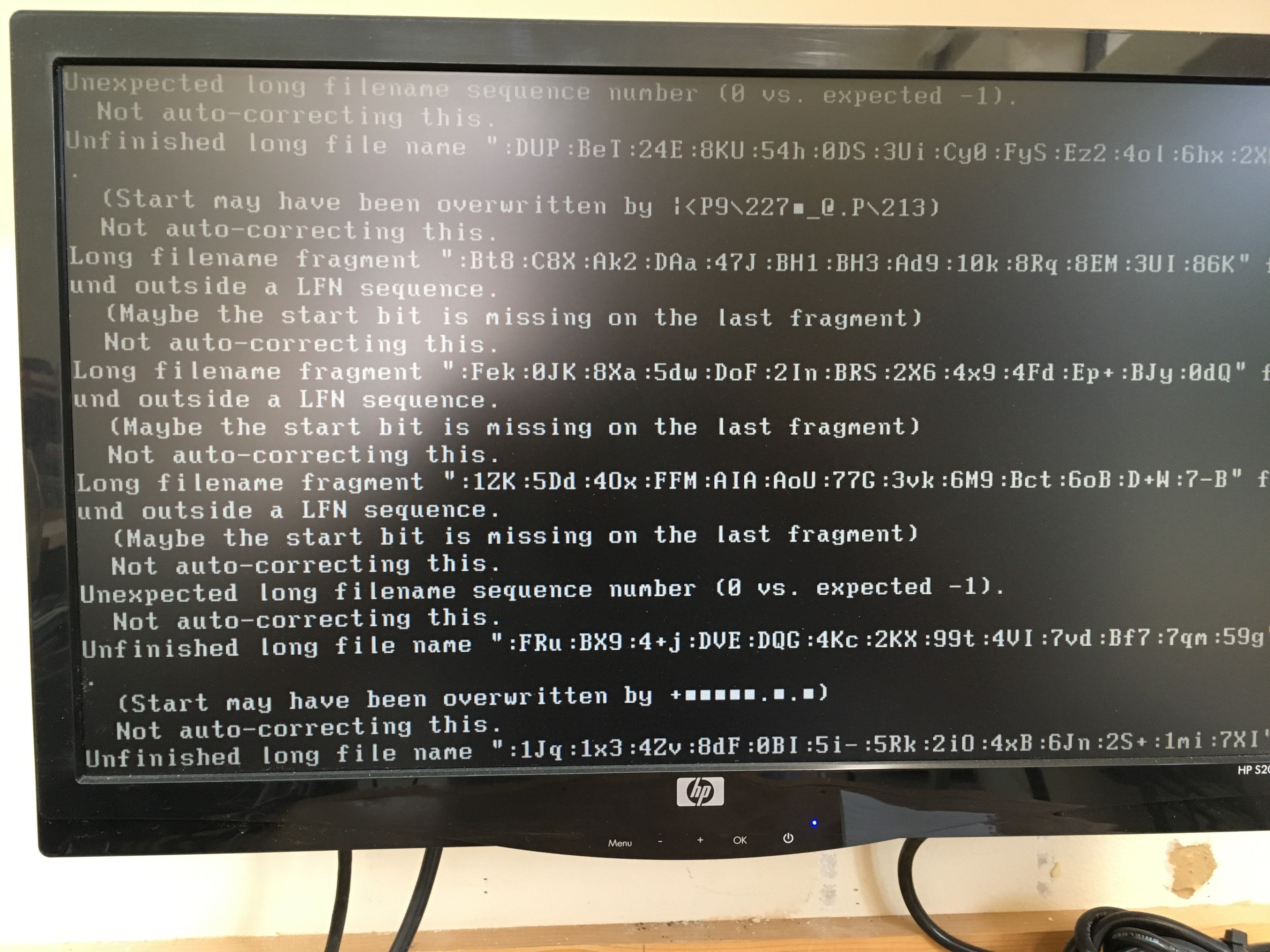

Last night I had a major power failure (3+ hours) which I slept through.  My Backup Generator decided to have a problem so I lost power to the unRaid tower and it shut down after the UPS battery was depleted.
I have been using unRaid since 2009 with no major problems and no loss of any data. The system is very robust with n device failure (ever).  I believe I am using The latest version of unRaid but am Not sure  (Side note: I am 79 year of age and just returned from major surgery on 4/19/2019. I am more tired than usual and not mentally back to my usual self, so please bear with me.
I can start the system and get to the bios with no problem and all the settings look quite normal
When I boot from the unraid USB-HDD It seems to start okay. I get the messages:  "bzimge...OK" and  "bzroot...OK" followed by a bunch of text messages with no stop until the last message "unpacking initramfs"
The system then halts for a few seconds and then the screen goes crazy with gibberish scrolling by at a rapid rate.  Interspaced in the gibberish are some readable text messages such as:
Unexpected long file name <gibberish>      Not autocorrecting this
Unfinished long file name <gibberish>    Start may have been overwritten
Long file name fragment <gibberish> found outside LFN sequence (Maybe the start bit is missing on the last fragment) Not autocorrecting this.
/config/plugins/statistics.sender /\ ...<gibberish>    Bad start file name  Auto renaming it  Renamed to FSCK0004,xxx
As long as I don't shut the system off it keeps doing this scrolling with gibberish.
My thoughts are that either there is a problem with the USB system on the mobo (don't think so as it seems to read bzimage and bzroot okay.
I would like to build a new USB hard drive with the latest version 6.x.x but I am not sure how to do this and am concerned about my license key.
Can someone point me to where the instructions are for building a new USB HDD with unRaid on it or just help me out with thoughts and advice?  I really want to get my unRaid system back on the air!!
I have attached a photo of the screen to show what I am seeing
Edited by barrygordon
ended too soon by mistyping
That suggests a problem with the flash drive, run chkdsk on a Windows/Mac PC, if that's not enough overwrite all the bz* files using the zip from latest stable release.

I just tried what was suggested.  I copied the following files from the unzipped archive for 6.6.7 to my non-working USB-HDD:
bzfirmware, bzimage, bzmodules, bzroot, bzroot-gui.
I then tried to boot the system. I first tried it in normal mode and the same result occurred.  I let it run for a few minutes as it kept scrolling on the screen.
I then tried to boot in safe mode with the same result.  I decided to let it keep running for a while (it is still running scrolling the screen) and I'll give it about 10 minutes and then stop it.
(10 minutes later) There seems to be some consistency to what is scrolling on the screen.  The majority is gibberish, but the following shows up fairly regularly:
/CONFIG/PLUGINS/statistics.sender / \ 202, <gibberish>
Bad short File Name (<gibberish>)
Auto-renaming it.
Renamed to FSCK005.<number>   Where number increases with each message cycle.
I hope that it is not accessing and writing on any of my data drives!!
