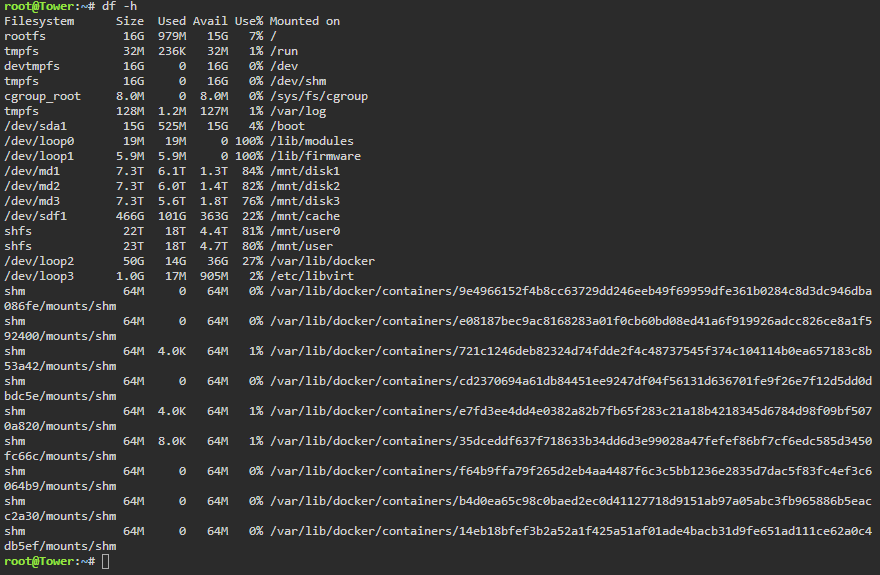

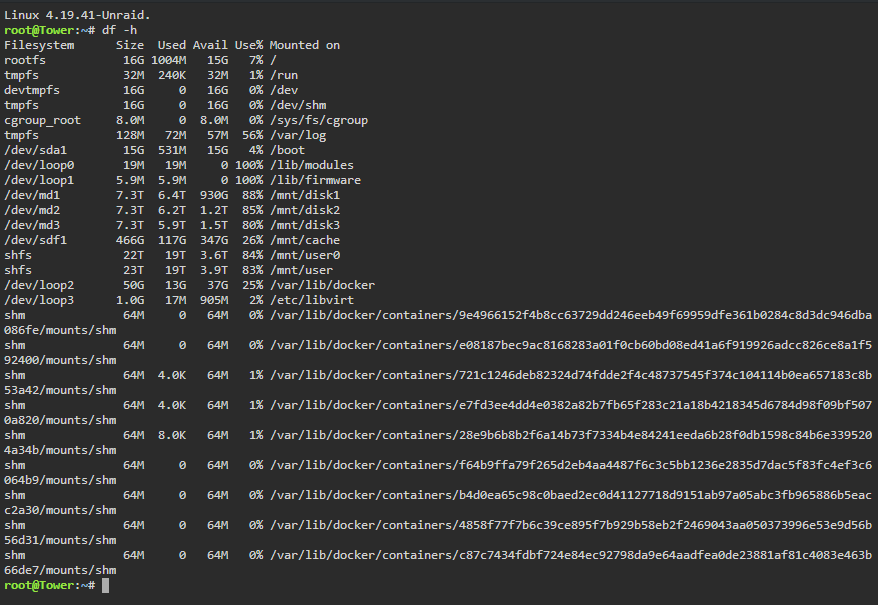

What do you get with this command?
df -h
Sorry, I thought I had given all the info I would need so I updated to 6.7.0. It's been up for almost 2 days now.
And of course, that shows you aren't currently having the issue.
