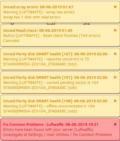

Tried enable but still no data: smartctl -s on /dev/sdd
It's sdc (at least it was)
OFC my bad   WDC_WD30EFRX-68EUZN0_WD-WCC4N4JSF25Z-20190608-1909.txt
Dont know what to now with all these error

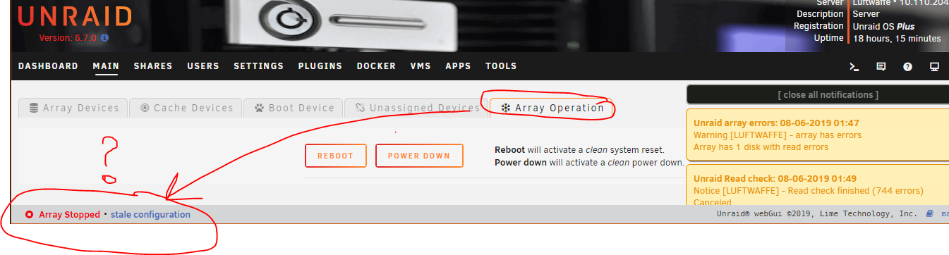

Array stopped again - rebooted and we are good to go again
What shoud I do next to solve things out?
Thanks!
Edited by Nebula
Disk looks fine, you can rebuild on top, as for the stale config error not sure what's causing that, rebuild the disk first the you can try redoing your flash drive.

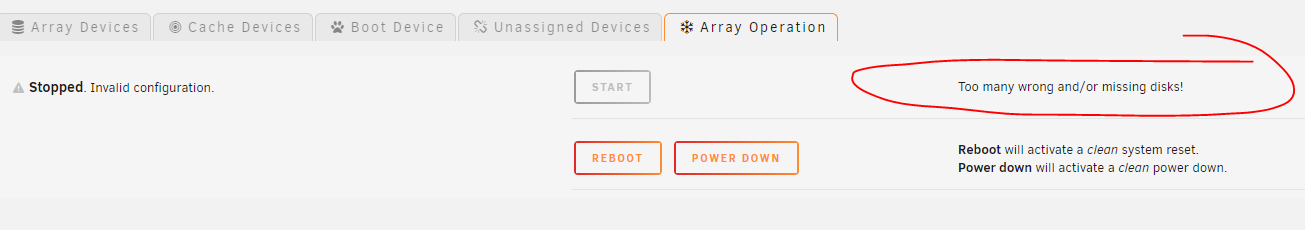

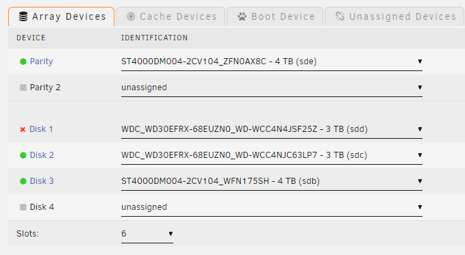

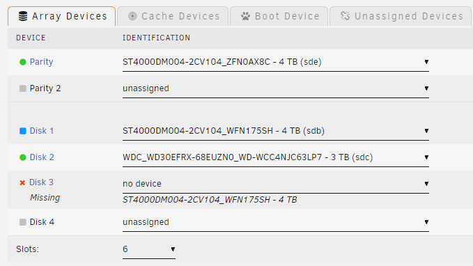

Now when I set Disk 1 to "no device" and chose new disk it's says DISK 3 missing and can't start up server due to wrong/missing disk
But if I go back to settings in first picture above its good to go but then I can't rebuild.
I did som research and maybe I did something wrong installing the new disk.
Is it because Disk 3 is now a part of the array and there for I cant change it with the dmg Disk1?
Should I have'd set Disk 1 to no device first and then change it with the new disk 3 (before preclear) followed up with preclearing, rebuild?
Edited by Nebula
You can't use disk3 to rebuild disk1, you'll need another one.
What do you mean by that? Pls explain
You can't use an existing array disk to replace another, I think that's pretty clear.
ofc I understand that but that leads me to my questions above or below:
I guess it is from your answer.

5: Install the new drive  (from a noob view it does only tell you to install new drive and not it has too be the same disk slot you want to replace before preclear, rebuild)
And thats why I ended up with one extra added disk to my array instead. Now its pretty clear ofc but I thought I might delete data or something.

To replace an array device you assign it to the slot of the disk you are replacing and start the array to begin rebuilding, pre-clear is optional and if you want to do that it's done with the disk outside the array.
You can remove the disk from the array using the shrink array options, but the first option can only be used if there's already no important data on the disable disk, second option can still be used, but it will be slow.
