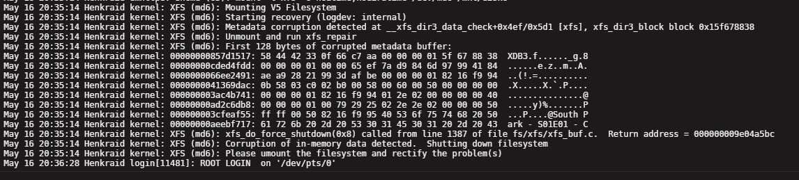

It doesn't look like disk6 is detected as an xfs filesystem. I restarted the system and it don't look like that changed anything.
Not sure if that's a problem? Did this, didn't run the actual repair (the option to check it isn't in the gui).
It says "FS auto", "Unmountable: No file system". And on the bottom "Unmountable disk present:Disk 6 • WDC_WD40EFRX-68N32N0_WD-WCC7K2RK8VU8 (sdb)". And i have the option to format it.
root@Henkraid:~# xfs_repair -n /dev/md6
Phase 1 - find and verify superblock...
Phase 2 - using internal log
        - zero log...
Log inconsistent or not a log (last==0, first!=1)
empty log check failed
zero_log: cannot find log head/tail (xlog_find_tail=22)
        - scan filesystem freespace and inode maps...
ir_freecount/free mismatch, inode chunk 3/35062848, freecount 0 nfree 5
inode rec for ino 6521313728 (3/78862784) overlaps existing rec (start 3/78862784)
agi_freecount 57, counted 14 in ag 3
sb_icount 2496, counted 2560
sb_ifree 397, counted 308
sb_fdblocks 496361854, counted 491894032
        - found root inode chunk
Phase 3 - for each AG...
        - scan (but don't clear) agi unlinked lists...
        - process known inodes and perform inode discovery...
        - agno = 0
        - agno = 1
        - agno = 2
        - agno = 3
imap claims a free inode 6477511085 is in use, would correct imap and clear inode
        - process newly discovered inodes...
Phase 4 - check for duplicate blocks...
        - setting up duplicate extent list...
        - check for inodes claiming duplicate blocks...
        - agno = 0
        - agno = 1
        - agno = 2
        - agno = 3
entry "South Park - S01E13 - Cartman's Mom is a Dirty Slut Bluray-720p.mp4" at block 0 offset 2824 in directory inode 6477511060 references free inode 6477511085
        would clear inode number in entry at offset 2824...
No modify flag set, skipping phase 5
Inode allocation btrees are too corrupted, skipping phases 6 and 7
Maximum metadata LSN (1:26702) is ahead of log (0:0).
Would format log to cycle 4.
No modify flag set, skipping filesystem flush and exiting.

Alrighty that seems to have fixed it now, it's detected as an xfs filesystem and it mounts without any issues from what i can tell so far. Will provide the xfs_repair output and my diagnostics just in case there's anything more to it. I guess now i just have to slowly go through the data and see what's lost due to all of my problems lol. Thanks alot man!
root@Henkraid:~# xfs_repair /dev/md6
        - zero log...
ERROR: The log head and/or tail cannot be discovered. Attempt to mount the
filesystem to replay the log or use the -L option to destroy the log and
attempt a repair.
root@Henkraid:~# xfs_repair -L /dev/md6
        - zero log...
        - scan and clear agi unlinked lists...
        - agno = 0
        - agno = 1
        - agno = 2
        - agno = 3
imap claims a free inode 6477511085 is in use, correcting imap and clearing inode
cleared inode 6477511085
        - agno = 0
        - agno = 1
        - agno = 2
        - agno = 3
        clearing inode number in entry at offset 2824...
Phase 5 - rebuild AG headers and trees...
        - reset superblock...
Phase 6 - check inode connectivity...
        - resetting contents of realtime bitmap and summary inodes
        - traversing filesystem ...
bad hash table for directory inode 6477511060 (no data entry): rebuilding
rebuilding directory inode 6477511060
        - traversal finished ...
        - moving disconnected inodes to lost+found ...
Phase 7 - verify and correct link counts...
Maximum metadata LSN (4:49915) is ahead of log (1:2).
Format log to cycle 7.
done
        - zero log...
Phase 3 - for each AG...de chunk
        - agno = 0
        - agno = 1
        - agno = 2
        - agno = 3
        - agno = 0
        - agno = 1
        - agno = 2
        - agno = 3
done
henkraid-diagnostics-20190520-1541.zip
Data should be mostly OK, assuming parity was in sync.
