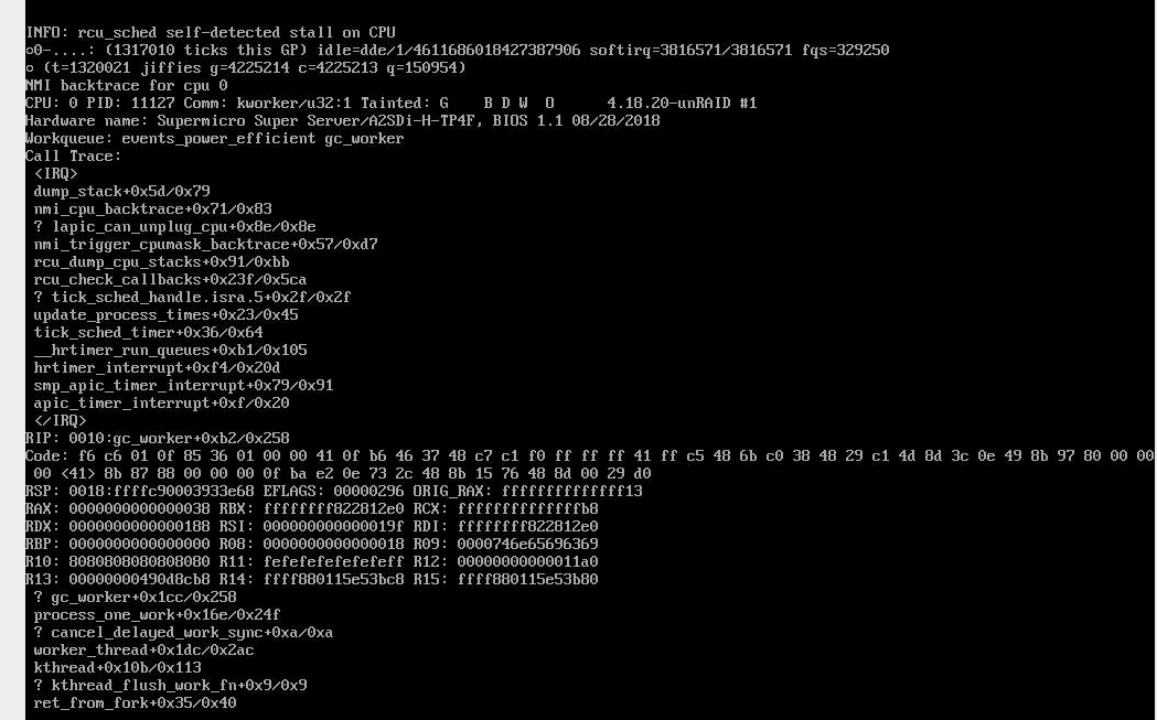

I've decided I wanted to try unRAID for a new NAS build, so I've installed it and had in running for a few months. But I'm experiencing severe issues where I can't consider this build complete.
I randomly get errors and it wasn't as bad in the beginning, but I never really hammered the NAS very much.
I get a whole bunch of different errors. Attached you see some of the ones I've screenshotted from my BNC. I have obtained a diagnostic dump after I've confirmed one error got on the screen but didn't make the unraid unresponsive yet. But it always happens.
I also suspect it can be related to docker, which I currently only run a rtorrent docker, I've attempted to heavily limit the number of files it allowed to keep open at once and limited it's ability to create connection, but it had no effect on unraid just crashing completely. I've kept my server in a good state longer if I don't start any dockers, and when I start rtorrent. The problems always start occurring within two days or so with uptime.

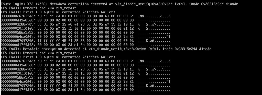

You should really post your diagnostics.  And no, there's nothing you need to redact.   About the only that can be discerned from your screenshots is that disk 3 requires you to Check Disk Filesystem on it.
I've added the diagnostic dump to my OP. I've rebooted it now, but my trail has expired among with my two extensions and I can't access the WebUI anymore. And it doesn't seem like /dev/md3 exist either. I suspect this is what unraid have named their pool, and that it's not a reference to one of my disks.

I've managed to run xfs_repair on the device in question. It have had absolutely on effect on any of the issues described in this thread. I have no idea what to do next. Is there anything indicating anything wrong in the diagnostics files?
Could you give us some details about that? The output from running the repair would be preferred.
There was no errors in it, it was the standard output.
These issues also occurred way before that error popped up, also feel like this is the most irrelevant error to the symptoms experienced. Why would a completely corrupt storage-disk even crash unRAID?

Now it crashed again, but it is not responsive, it's on and display the error, but I can't connect to it with SSH or access the WebUI to get another diagnostics.
While this error is not one of the those I've have managed to screenshot, it is an error I've gotten before, it's "nf_nat_setup_info"
this happen after I started to stress-test my rTorrent docker, as I have suspected it's related to docker in some way. I started adding a few torrents, one after another and it very quickly crashed.
