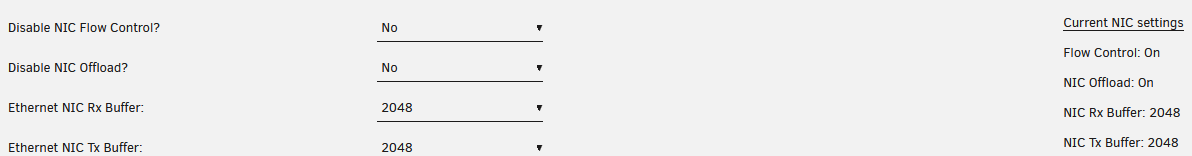

December 13, 20214 yr //edited: needed NIC offloading off. Hello, This is my first post .... as far as I remember .... but I though this might help others so here it goes. Had issues with VLANs enabled on a 10Gbps adapter and after the first reboot copying files using samba shares on any IP of any VLAN interface, I got the same disabled state kernel errors in the logs. After a shit-ton of searches and failed diagnostics, I remembered about Flow control and NIC offloading, so I installed the Tips and Tweaks plugin and set Disable NIC Flow Control to Yes, Disable NIC Offload to "Yes" and Rx and Tx buffers to 2048 and it now works perfectly. Hope this helps you too. Edited December 13, 20214 yr by VladL
November 7, 20223 yr Just wanted to thank you @VladL for the response ... been trying to find an answer to this for quite some time. After some research I found that I was having a lot of Rx packet drops which led me to increasing the NIC Rx buffer. Just wanted to note that bigger isn't always better - seems like ideal setting it the smallest buffer where you don't have packets dropping.
