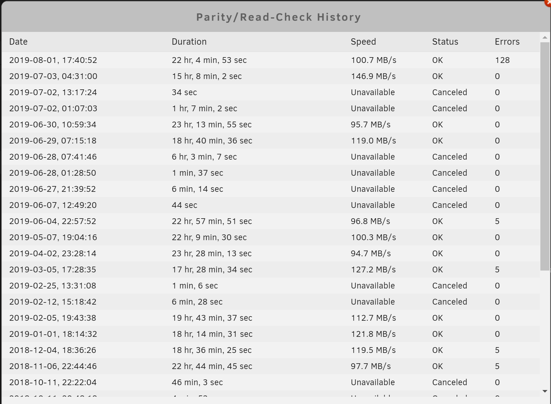

The diagnostics on my third post should be right after the disk7 was rebuilt "successfully" with 128 errors. As far as checksums go that is something I would have to have been prepared for correct? Is there a easy way to catalog files and their checksums for the future? I guess i'm not sure how one compares files once they have been replaced by possibly corrupt versions.

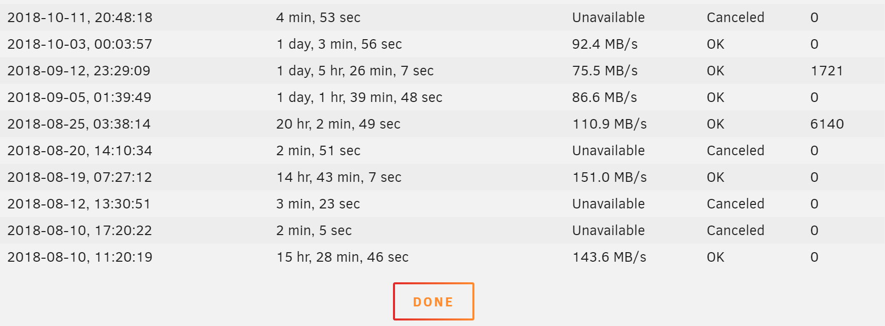

Looking at my parity check history these aren't my first string of errors. I guess I always assumed these errors were being corrected and that was the point of doing parity checks regularly.
That was a very tricky rebuild, first you had some read errors on disk10, dual parity saved you here, but then disk4 got disabled, so dual parity couldn't help when there were also read errors on disk8, every time you see this on the log:
Aug  1 03:06:53 Tower kernel: md: recovery thread: multiple disk errors, sector=4510123224
is Unraid speak for "there are errors in more disks than current redundancy can correct, the rebuild/sync will continue but there will be some (or a lot) of corruption."
