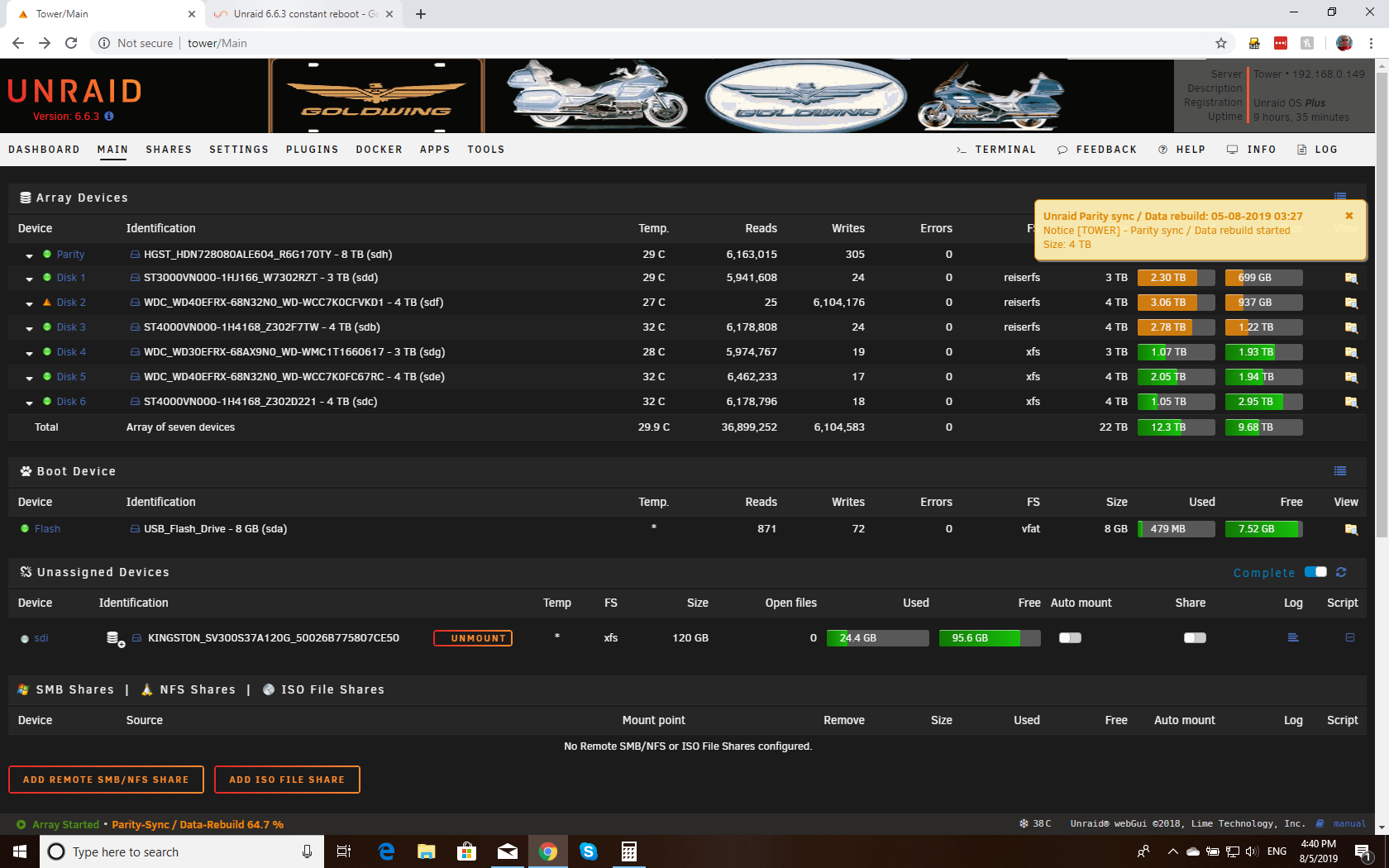

Hi everyone. I have been running my unraid box for quite some years now but, recently noticed a problem. The server would constantly reboot every 2-3 minutes. One of my disks is not recognized anymore. So I opened up the server, cleaned everything, made sure all sata cables were plugged in properly and rebooted. Same thing. So again, I opened my box, checked my Seasonic 750 watt psu under load and everything checks out. I plugged in one of those post code debug cards and everything checks out. I installed a Linux OS on a thumb drive so I could stress my pc with the stress command. Even with the thumb drive, the server would reboot 2 to 3 times before stabilizing. I stress tested the cpu, io, and what not for a few hours and all good. I started memtest and let it run for 24 hours and not one single error. I thought maybe the unraid thumb drive was corrupt but, it rebooted when I tried it with another OS. I am in the process of rebuilding my #2 disk after it was recognized and, I hope I did not do anything wrong because sync shows a total size of 4 TB, which is the size of my disk and not the array. Phew, I am running out of wind. Anyway, I downloaded the diagnostic for yesterday and the one today while rebuilding. I don't know how to post them or if they are even needed. Oh BTW, all my dockers are gone and I don't know why. I don't have another psu to swap, in case someone suggests it. Any help would be greatly appreciated.

Rebooting every few minutes has all signs of being heat related. ----- I agree but, after I removed the server from it's location and after it had cooled down, the same problem existed. But now that I am thinking more about it, I did have alerts about the hard drives heating up (50 C) It is still rebuilding but the hard drives had started giving me alerts so I installed a 70 cm fan blowing right in the sever. All disks are now at 27 to 32 C and the rebuild has not stopped. The server has been in a dedicated space with air circulation for years and has given me no problems before although now, it has grown with more disks and also more dust. (It was very dirty when I took it out to bench test it) I do not believe the ups is to blame  given that it is only a few months old and the server did reboot on the bench without being plugged in to the ups.
I do believe that you pointed me in the right direction and it is very possible that the server did in fact overheat. It is humming along very nicely now. When the rebuild is complete, I will close the case, stop the big fan and boot in non-GUI mode as instructed above and see what happens. I still don't know where all my dockers went but, I can reinstall those if all is good. Thank you and I will give feedback in a few days to see if everything is going well or not.
