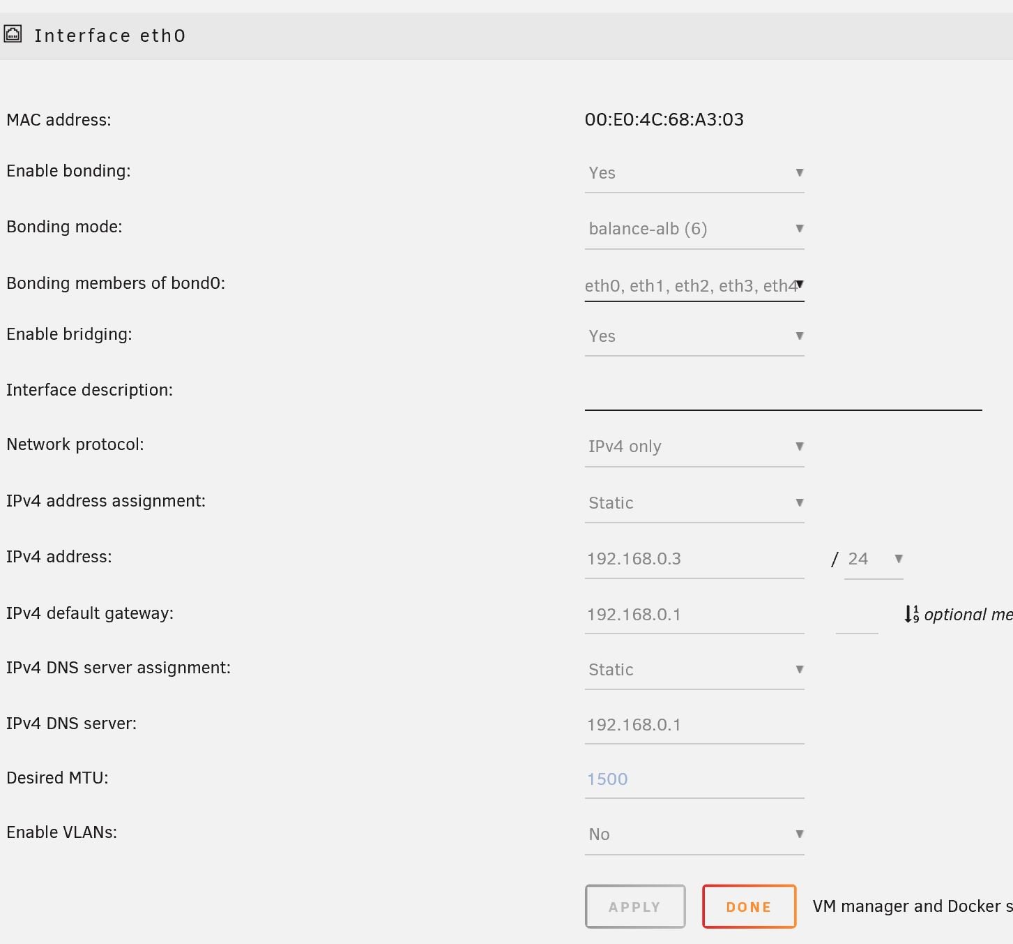

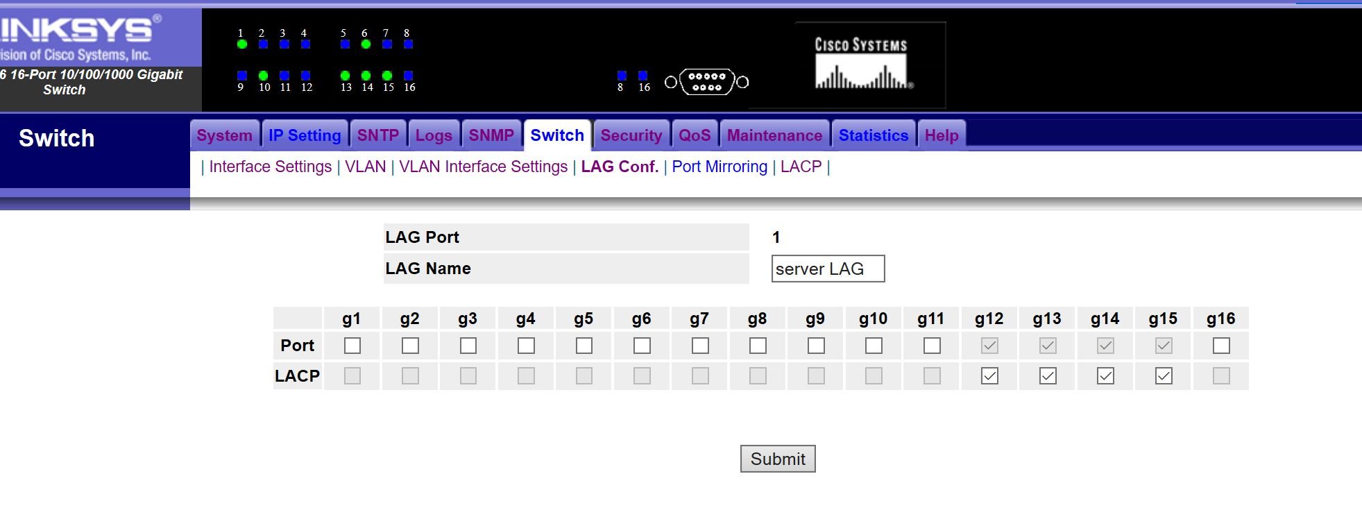

August 8, 20197 yr hi I just bought a 4 port 1gb nic as I was hoping to maximize my network traffic so I have the built in and then 4 on card.. I had it setup as active-backup but was reading posts from like 2011 to set it to mode 6 so its the balance alb I have a linksys cisco switch srw2016 under LAG I set ports 13,14,15 to to check box LAG and LACP I not using the other 2 ports yet.. ran out of network cable to reach my server at the moment... but with that settings I can my computer to ping... I truly don't know if its working... and I read on another post there is a LAG status where it showed Slow but I cant find any status on mine.. either because its not there anymore as the article was from 2011... but I also notice my xbox can no longer play Plex but my computer can..... my question is do you guys have a latest article or video on setting up this LAG to get the maximum throughput... out of my unraid server... probably should went with a 4 10gb but im not there yet... but ya any articles that is closer to date be good and pictures and is there a test where you can see your getting the max speed utilizied Edited August 8, 20197 yr by comet424

August 9, 20197 yr Author so I found setting it to balance(r) (0) that way works with the conf above and 1 other setting... but the mode 6 doesnt which setting should I have etc to get the max speed out of my unraid
August 9, 20197 yr Author or maybe my srw2016 is too old to do mode 6?? it is from like 2006 or so is that why mode 0 works
August 9, 20197 yr If you tick LACP then Unraid must set to 802.3ad(4). If no tick, it would be static LAG and not sure which mode will match.
August 9, 20197 yr Author oh ok so if I dick the LACP in linksys then unraid has to be the ad(4) which is the best way to go.. I just trying to get max speed out of it.. for transferring files or streaming my plex... but ill give that a try the ad(4)…. probably should gotten like 10gb card and network switch but not cheap enough yet for home user

August 9, 20197 yr Author oh ok so not worth upgrading to fibre then lol ok so I tested just got home if I check PORT and LCAP only balance-rr(0) balance-xor (2) and broadcast(3) only work the 6 doesn't work.. so whats the best setting anyways and what is just PORT checked off do.. as I thought I need this LCAP and I cant get that 802.3ad to work not sure what that one is if I just have PORT checked off then Broadcast (3) balance-xor(2) balance--rr(0) only ones to work under PORT check... maybe this swich too old to do all those other features of the other 4 options

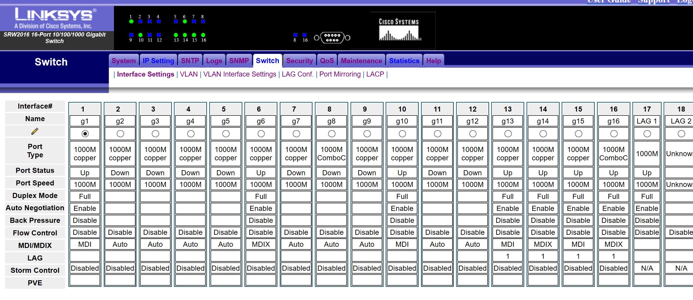

August 9, 20197 yr Strange, 802.3ad(4) not work. I have SG200 it work well ( test lontime ago, not use LACP anymore ) How about this setting •All the ports in a LAG must haveauto-negotiationdisabled, although theLAG can haveauto-negotiationenabled. Edited August 9, 20197 yr by Benson
August 9, 20197 yr Author so this is what is setup I using 13-16 as my 4 ports out of 5 for lag to my unraid… and you said to turn off auto negitionation and ya can not get the 802.3ad(4) to work.. si that what I want working
