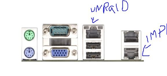

Normally if a motherboard supports IPMI then that is on a different physical LAN connection to normal ethernet use.    Does your motherboard have another LAN port, and if so have you tried connecting that as well to your router?
Yes i do have another port available. I will connect the other port to the router. I won't be able to give an update until IPMI firmware updates. Unless i don't need to restart the motherboard
I do not know the motherboard but I suspect just plugging in the other port may well be enough.
Yup that fix it. I didn't even see the other port. I have the unraid trail signup page running. Thank you @itimpi @trurl for all the help.
IPMI is handled completely within the BIOS of the board so it is reasonable that is not visible at the Unrsid level.
