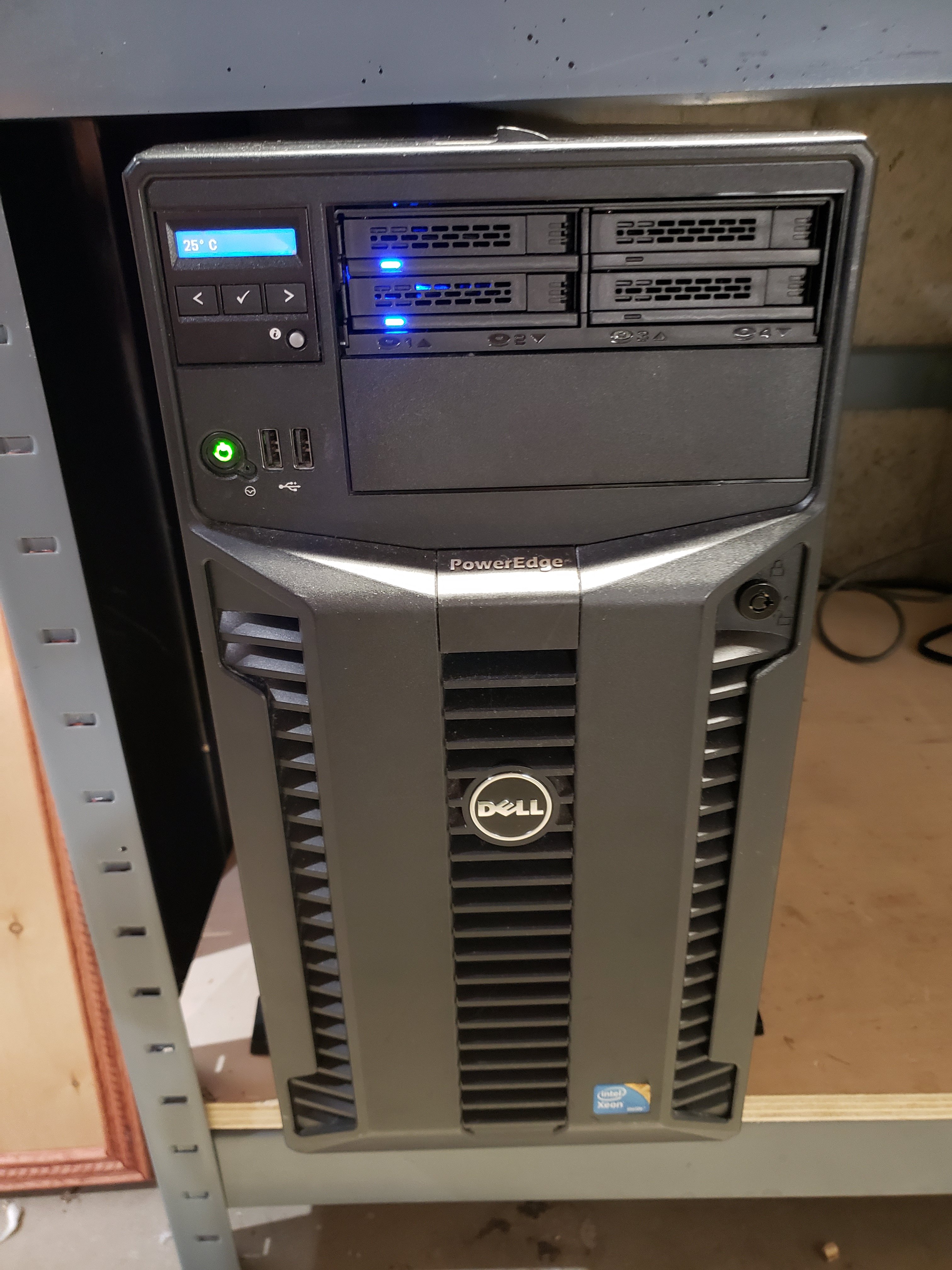

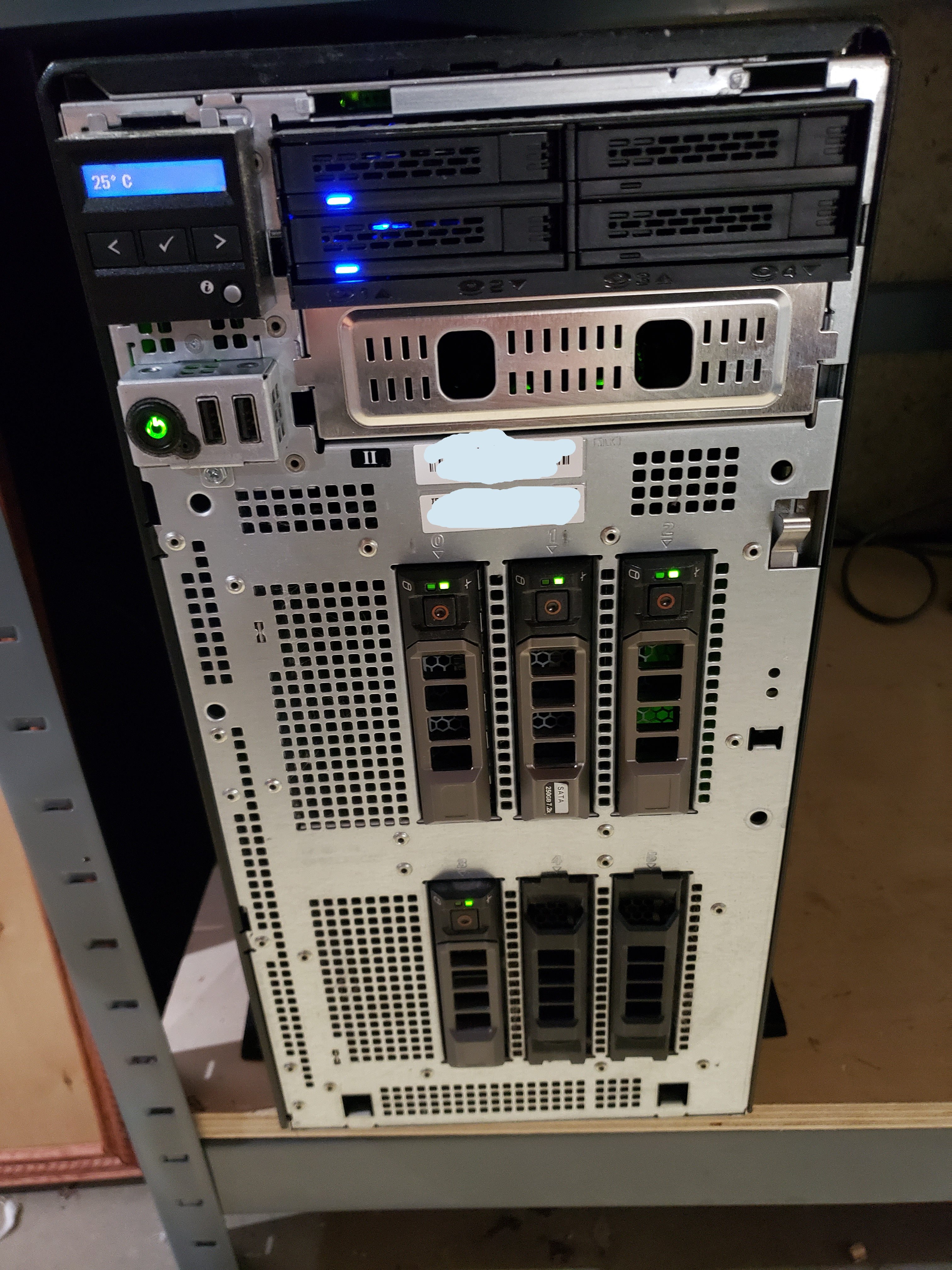

It all starts with a Dell PowerEdge T410 purchased on eBay for $130 and free shipping. It came configured with a single Intel Xeon E5620, 4GB DDR3 ECC REG Memory, 2- 250GB SATA 6Gbps hard drives, and a Perc 6I Raid Controller. 6 HotSwap SAS/SATA bays are located behind the front bezel and 2 - 5.25" drives bays located near the top.
The specs listed above are a great starting point for a budget media server after replacing the Perc 6I raid controller and cables with an H200 or H310 controller card and a pair of Mini-SAS to Mini-SAS cables. Allowing the user to install whichever size hard drives they prefer.

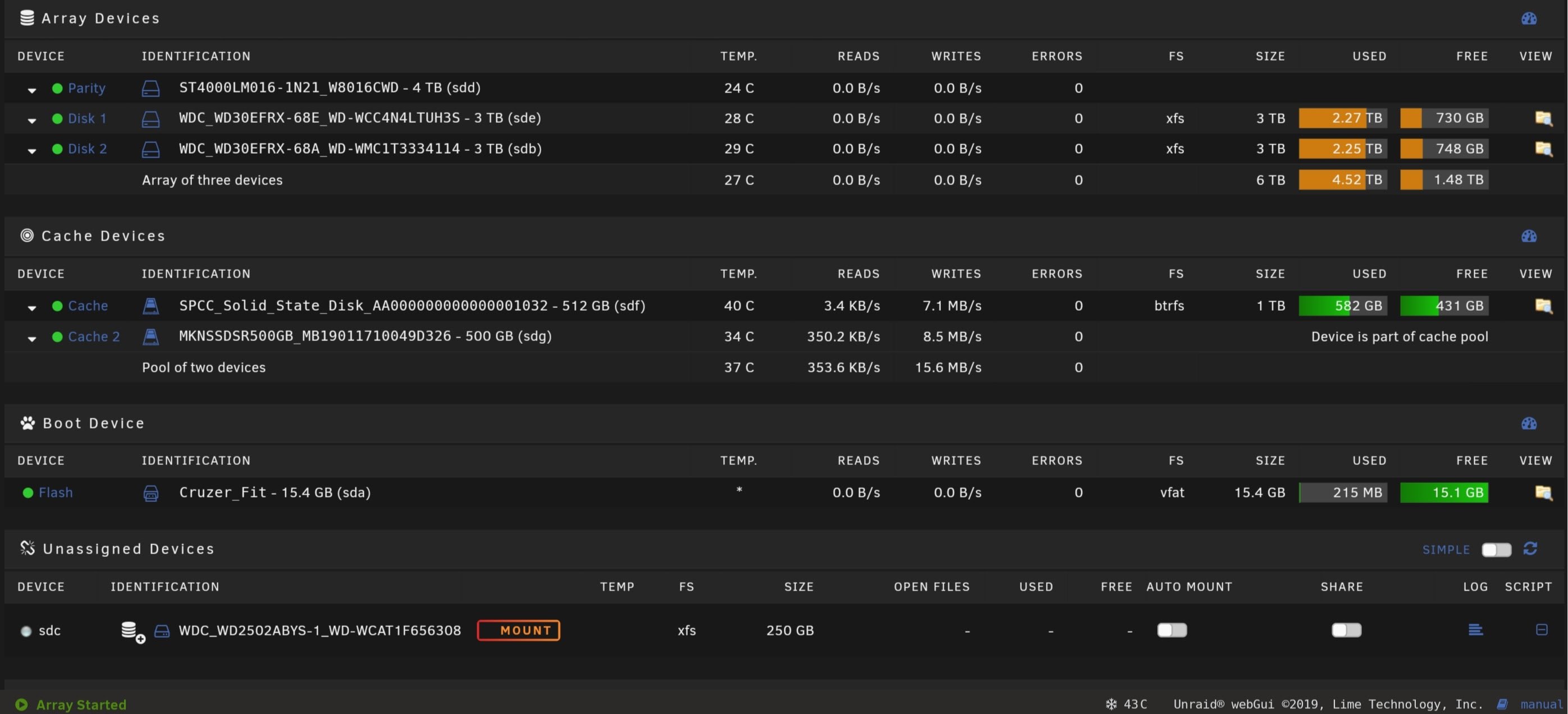

3 - WD 3TB 3.5" SATA Drives - 1 for Parity drive - 2 for Array  - $180.00
2 - 500GB 2.5" SSDs (Cache Drives) - Installed in Icydock 5.25" Hot-Swap - $100.00

1 - Sandisk 16gb Flash Drive (For unRAID OS) - $6.00

Note: Some prefer to use a H200 HBA with IT enabled firmware but I have found the H310 to work without a firmware swap by utilizing the passthrough feature of the firmware. Ive been running like this for a month with no drive issues and all SMART data and drive specs registering with the unRAID operating system.
On idle power the server the server uses about 120watts of power and runs very quite with the single exhaust fan in the rear. I have yet to push the system to its limits so I dont have the wattage readings under full load.

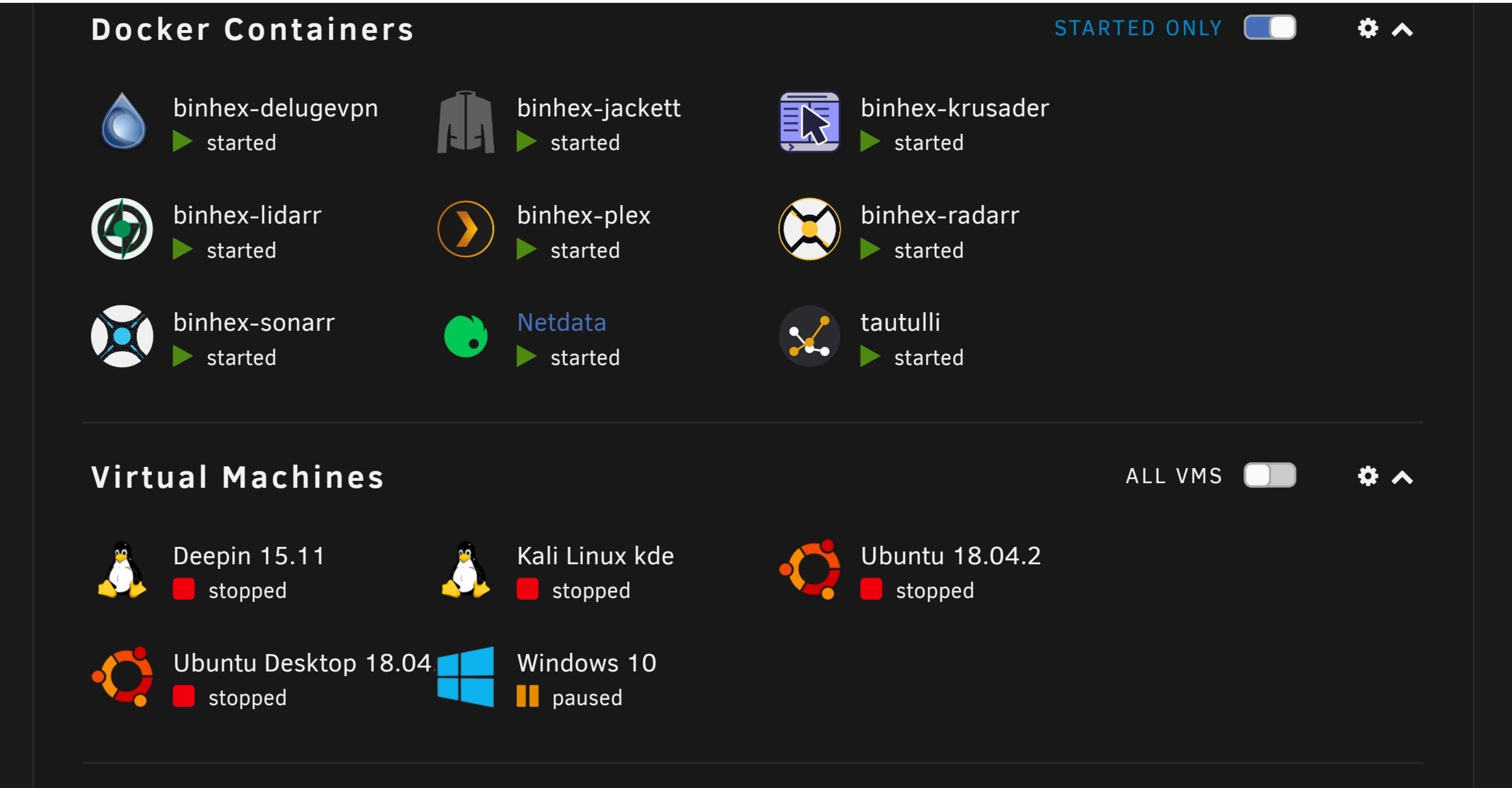

I currently run the following list of Docker Containers:
binhex-delugevpn
binhex-jackett
binhex-krusader
binhex-lidarr
binhex-plex
binhex-radarr
binhex-sonarr
Netdata
tautulli
And the following Virtual Machines:
Deepin 15.11
Ubuntu Server 18.04.2
Ubuntu Desktop 18.04.2
Windows 10 Pro
Kali Linux

Looks nice! How's the noise? The poweredge servers I've worked with have all been pretty loud.

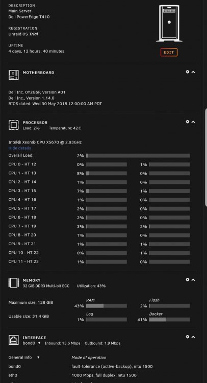

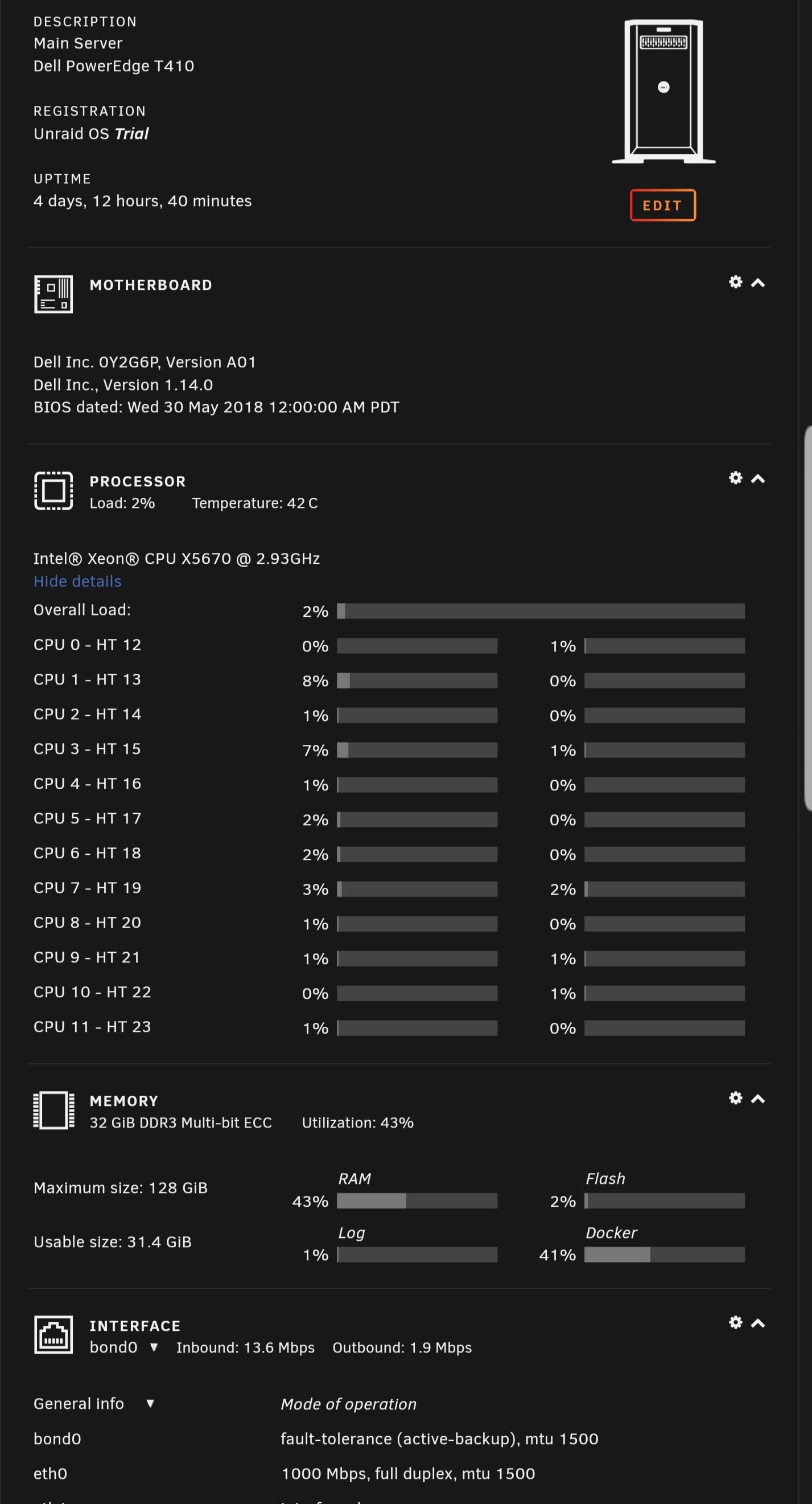

I see that UnRaid can show the CPU and RAM usage but what about the health of those components (heat, memory faults, etc.)?
Can you monitor the power supplies?
