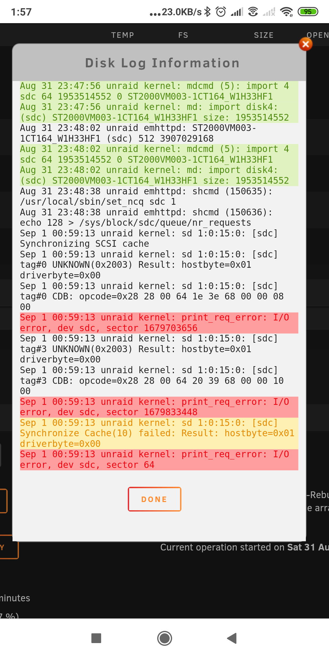

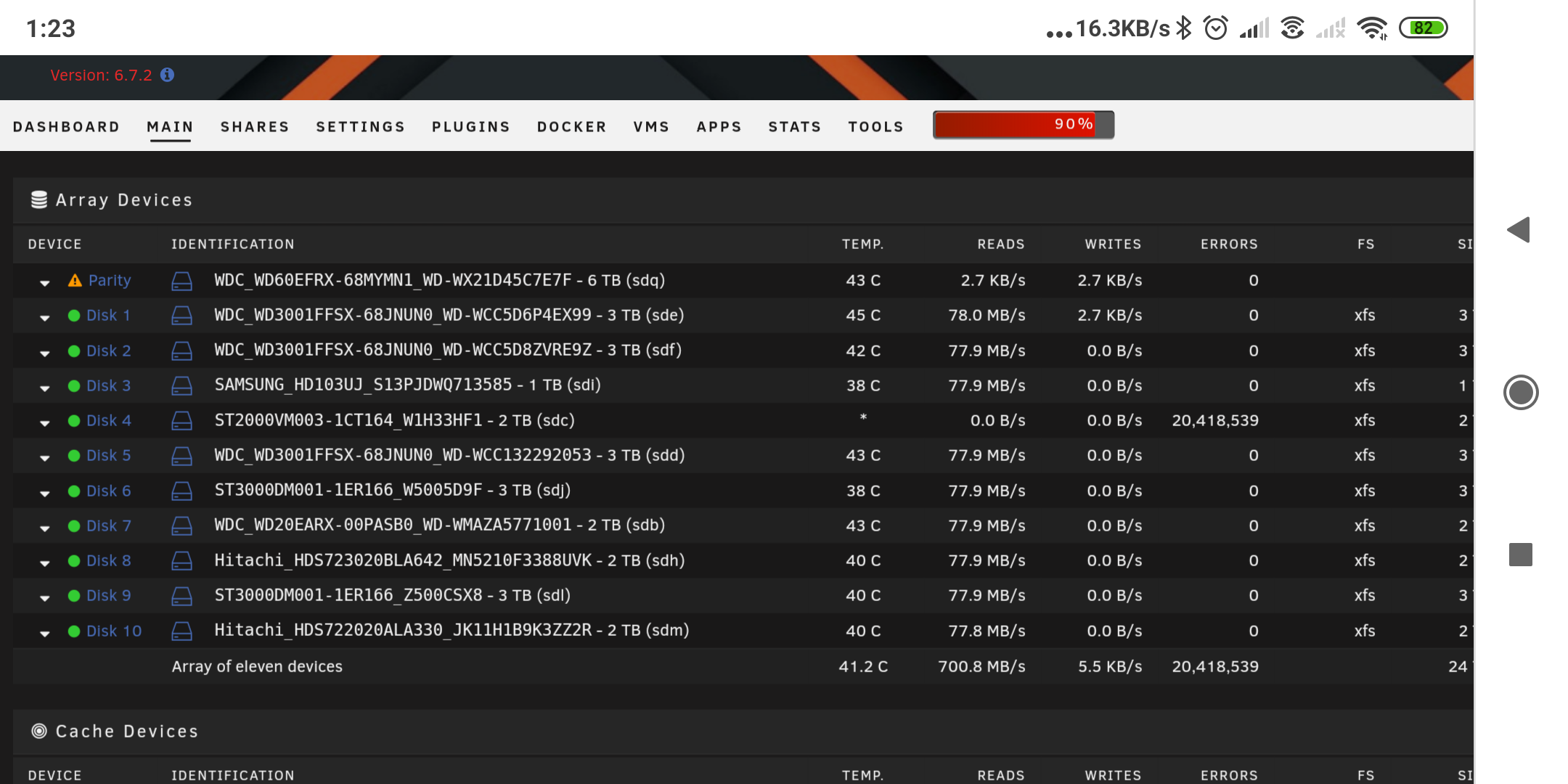

During the parity rebuild onto the larger drive, another data disk has failed. It showed no symptoms or smart errors prior to this, it simply dropped offline with the log showing an I/O error.
The rebuild seems to be continuing despite the number of errors being in the millions.

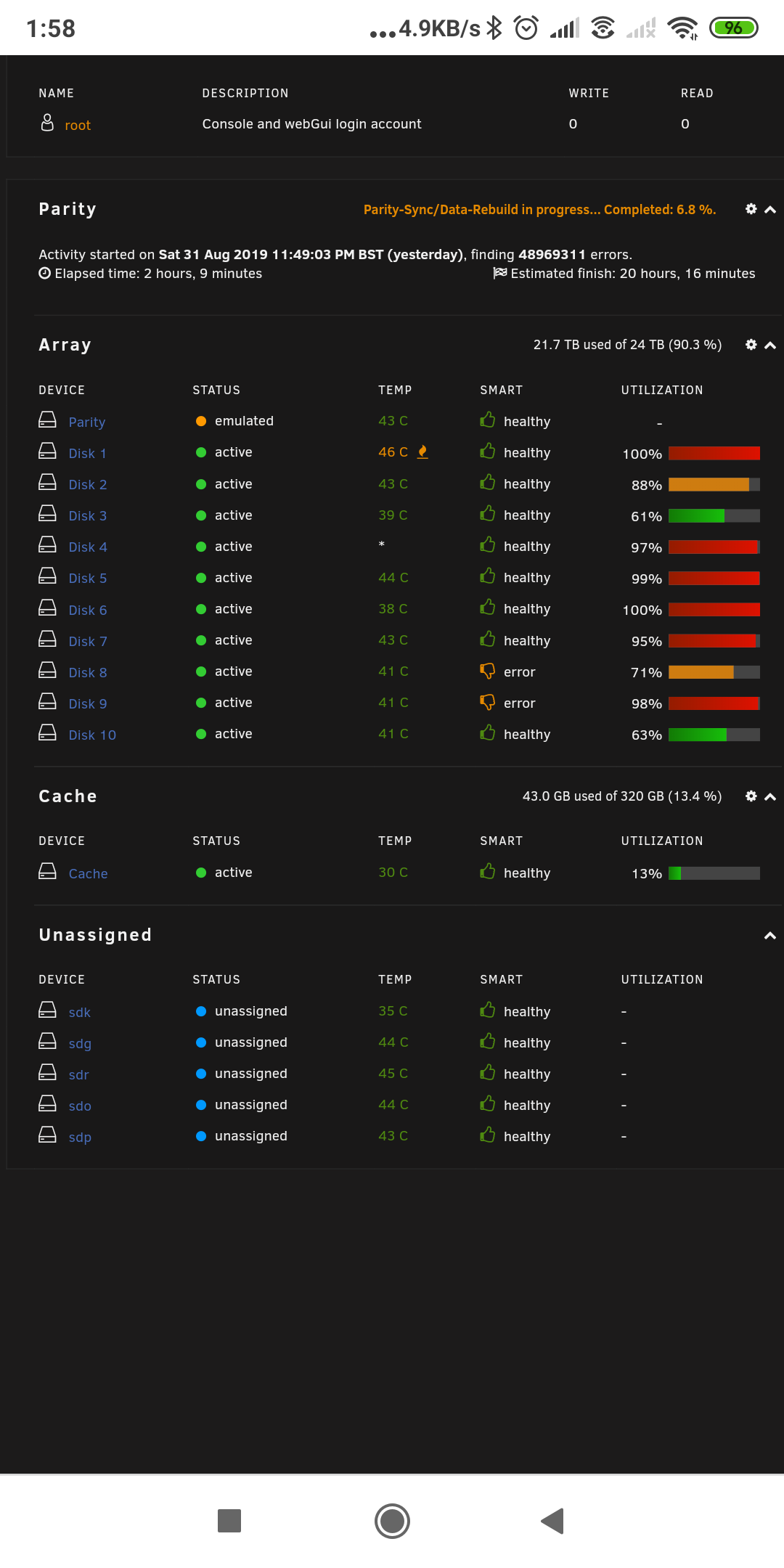

Few screenshots attached. Disk 4 is the failed one, ignore the other 2 showing errors (due to a previous dodgy cable).
Go to Tools - Diagnostics and attach the complete diagnostics zip file to your next post.
Disk4 dropped offline, disk itself looks fine, shutdown replace/check cables and try again, but you do appear to have a problem with disk8, so keep old parity intact, but it can only help in there weren't any writes to the array since it was removed.

The parity rebuild has now completed at last. Disk4 is also listed as disabled/emulated now and I can see the emulation does show some data although I have no way of telling whether this is everything that should be there or not.
As I was going to replace this drive anyway, can I just swap it out as normal and assign one of my new drives? I'm nervous to power down the system with the state it's in at the moment so can't check cabling yet but the new drives are installed, precleared and ready for use.
I wonder whether it may be best to add one of the new drives as an additional drive and copy the contents of the emulated disk4 and the erroring disk8 over to a new drive? My thinking is that we wouldn't want the load of a rebuild on the already dodgy disk8 which could push it over the edge. Disk4 being emulated at present isn't protected anyway and needs the data moving anyway so I'm thinking this would put the least strain on everything.

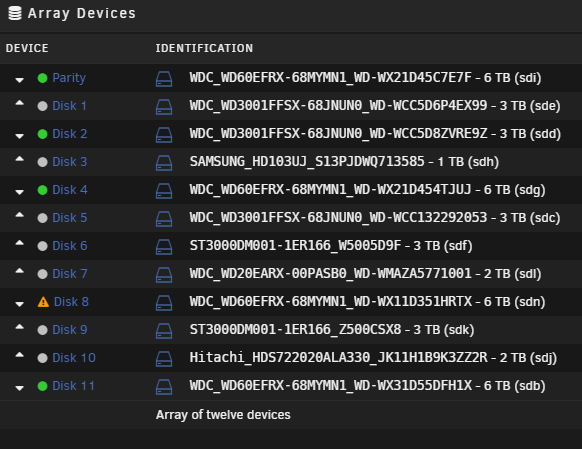

Attached my current logs. I put the old "failed" disk4 into another machine but it's definitely dead sadly. It spins up and sounds fine but is not detected under Ubuntu or Windows. I lost around 1.7TB out of the 2TB used. None of it is irreplacable, but most of it being a Plex library it's a bit of a pain to download things again. I do have a partial/incomplete online backup with Crashplan, but given the size of the array I don't have the budget for a local backup.
For the disk8, I swapped that out and added an additional disk at the same time so I had the extra capacity of the new disk to use whilst the disk8 was rebuilding.
