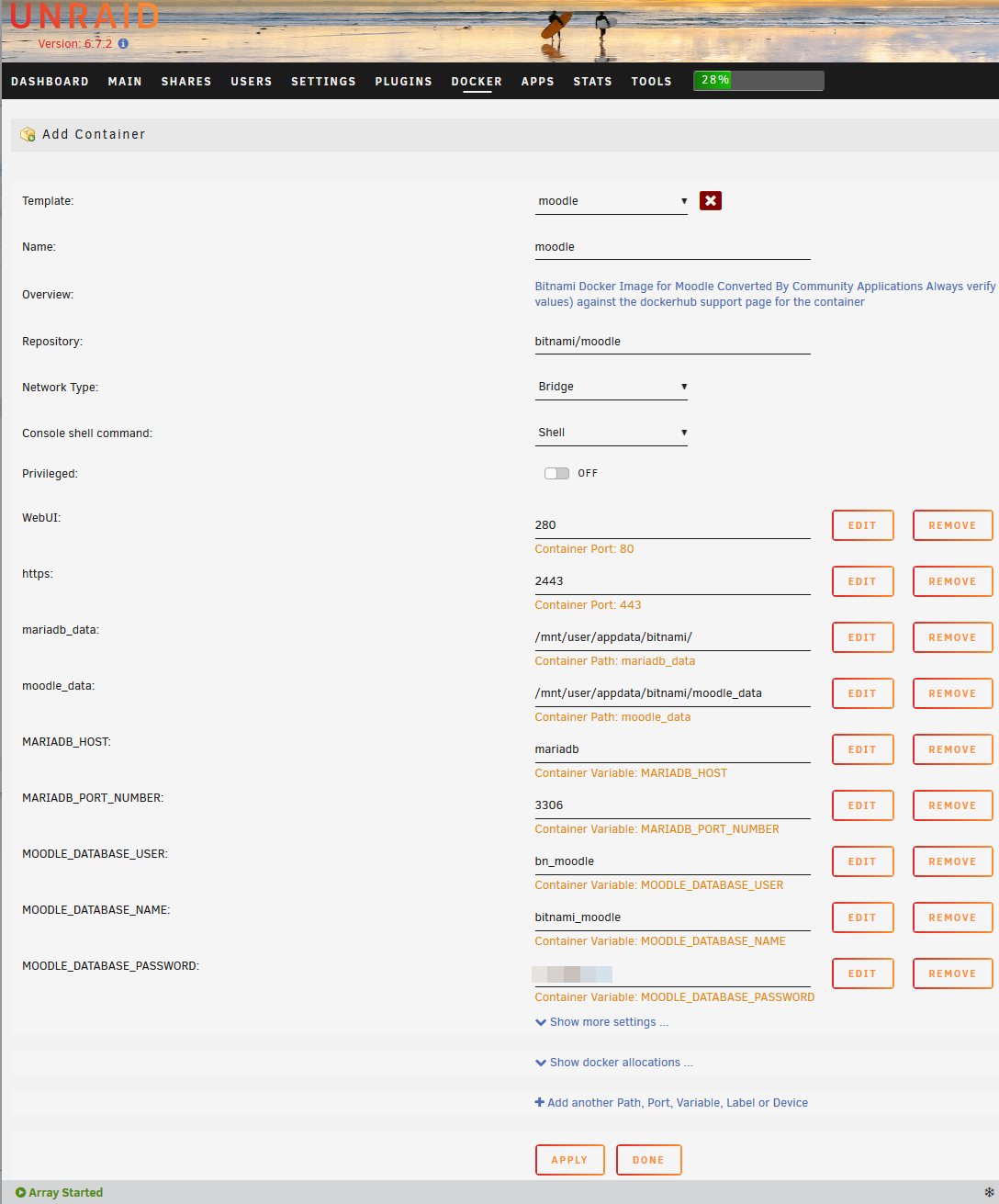

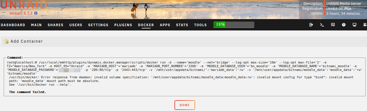

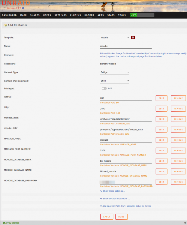

September 14, 20197 yr Hi, I'm trying to install the moodle docker container from Bitnami's repository (on github here). I have the MariaDB already set up from previous nextcloud install, and have created a database and user for the moodle instance. I can't get the moodle container to install successfully, though. I'll put screenshots of the configuration and the error below. Can anyone assist with this? Thanks, Ari Edited September 14, 20197 yr by adoucette

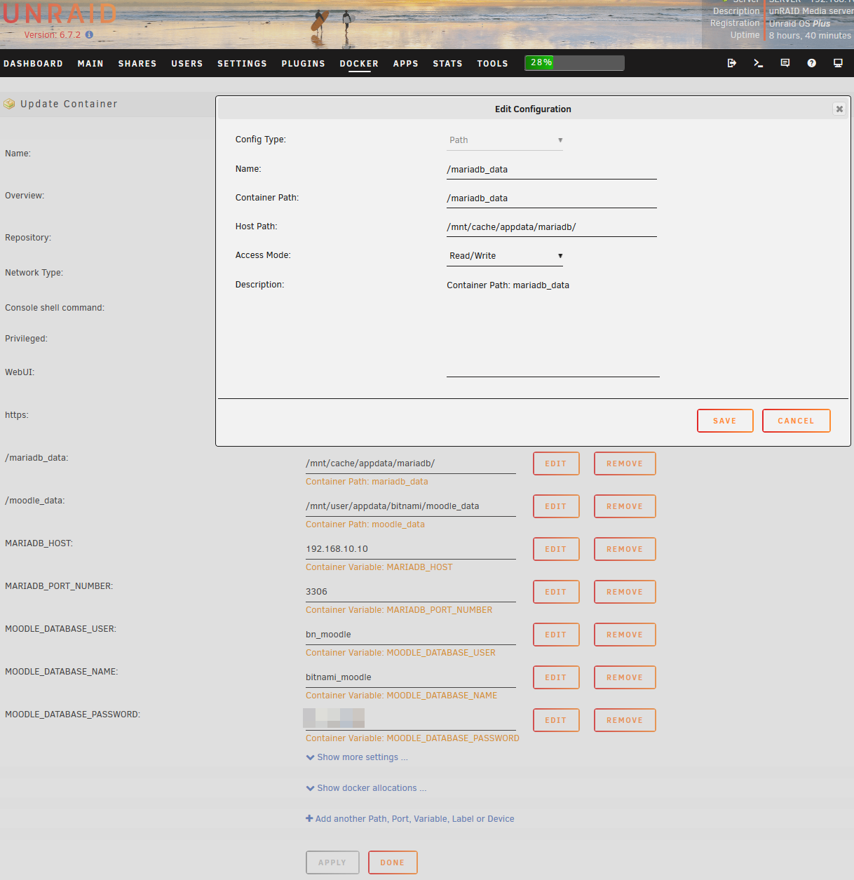

September 14, 20197 yr blah blah blah mount path must be absolute Your container path of moodle_data needs to be /moodle_data Same thing with mariadb_data Edited September 14, 20197 yr by Squid
September 15, 20197 yr Author Yes, that did it. Thanks Squid. Per the screen capture below, I needed to add the "/" forward slash before the names of the paths when defining the Environment Variables. Ari
