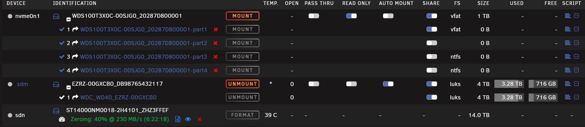

October 9, 20206 yr Noob here. Have spent a few weeks blundering about in Unraid and have a reasonably functional system. Unfortunately, did not encrypt the array and will have to bite the bullet on that at some point, tho don't have anything confidential on it yet. But at least I have plenty of space to move things around. But that's not the subject of this post. Was intrigued by Space Invader One's videos about encrypting unassigned drives and decided to encrypt an old drive and use that for confidential files. Short cut the video directions by just formatting the old drive in encrypted xfs format and assigned a passphrase. That seemed to work fine. Put some files on it to test it with no problems. The problem is that if I unmount the drive, it just remounts without asking for the passphrase. I assume there is a key file somewhere with the passphrase and if I delete that, it will require the passphrase. I can keep the pass phrase elsewhere. Problem is, I don't know enough to know where the key file is. Have watched the videos, but that didn't help as to the location. Would appreciate a pointer on that. Attached is a copy of my current UD configuration. Thanks
