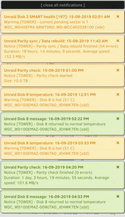

Now, while it went through the parity check/data rebuild process, it seems like several health issues on various drives popped up. Disk 2 had a
Current pending sector count of 1 but 0 reallocated event count (it didn't grow further though). Disk 7 also had its udma crc error count grow from 4 to 10 (I am going to try to replace this sata cable with a new one).
The data rebuild was complete but with 54 errors! Does it mean some parts of the data was not restored? Or does it mean the parity drive was updated?
I'm a bit worried here.. usually it's 0 errors.

by the way my parity check completed without issues. So I guess that’s good(?). Will update back here if things go wrong. Thanks a lot for your help!
Without either read errors on disk2 or sync errors? One or the other would be expected.
Yes without any read errors on disk2 or sync errors. I’ll generate a diagnostics for reference in a moment. Reaching home soon.
I guess that could happen if there was no data on the rebuilt disk sectors where there were read errors before, that's the only way it would make sense to me.

Anyway I have attached fresh diagnostics since then, could be useful.

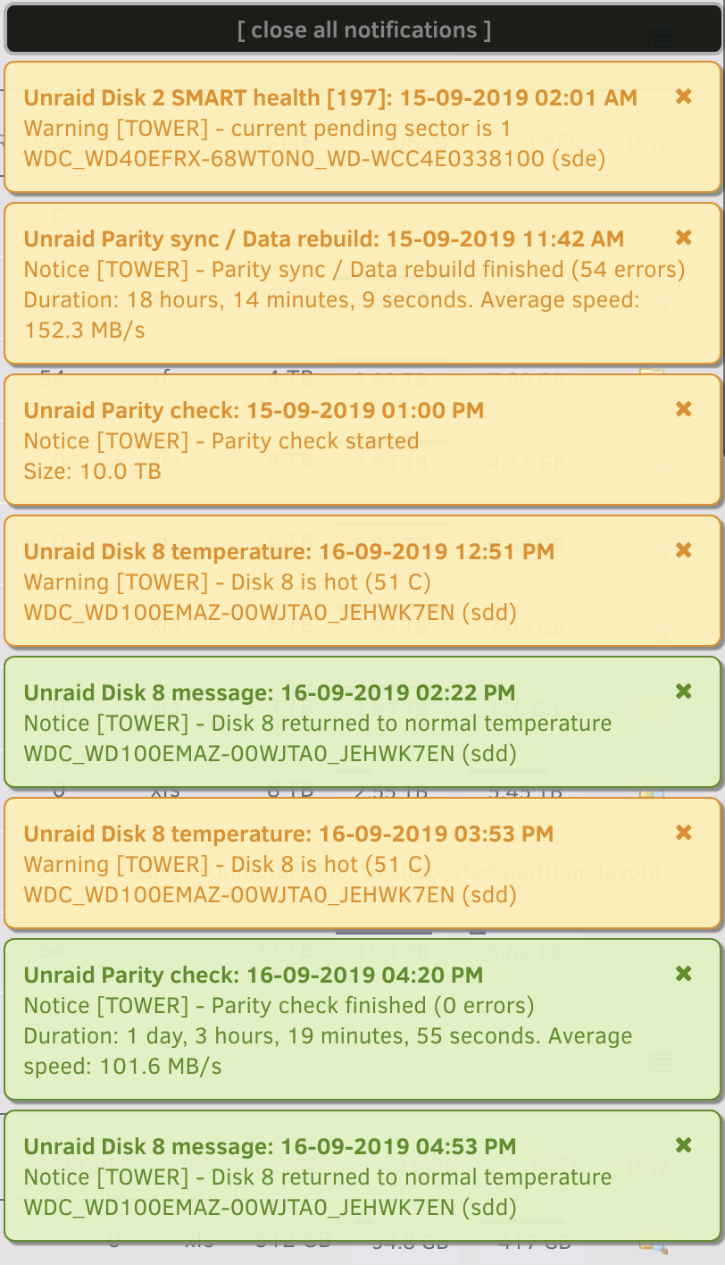

20 minutes ago, CyberMew said:
or maybe it could be a bug somewhere..
Don't think so, only explanation that makes sense is there wasn't any data on the sectors Unraid couldn't read, I would expect it would write zeros to those on the rebuilt disk, and if there were no sync errors now it means those sectors were already all zeros before, i.e., no data.
