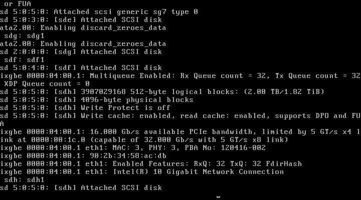

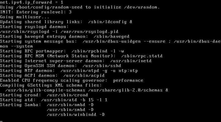

My servers does start, he stuck in the next image:
I used the functions xfs_repair, I used new configuration and nothing works.

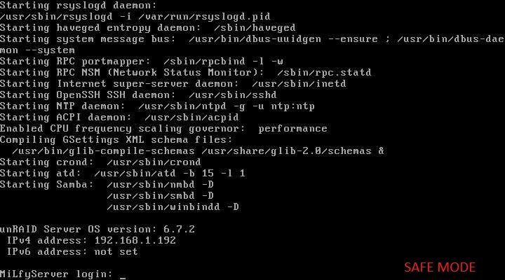

In safe mode, it works, but all interactions with the array works very very slow, for make the new array after use new configurations I taked 30 min only for selecction the hard drives because I selected the hard drivers and nothing happens.
I see when the unraid starts the message "[sdh] attached  scsi disk" take so much time for disapear.
I do not know what else to do, thanks.

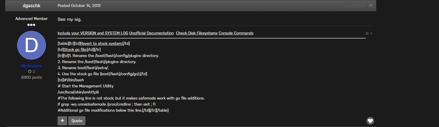

I seems i fix it with a signature from one user.
thanks @dgaschk
But the server seems slow starting the service http, starting array, applying simple settings.....
I can see this message in syslog "unraid Broken pipe (32): sendfile: /usr/local/emhttp/update.htm" and I have seen other people that also happened to him, but uninstalling plugins or updating was fixed, but I do not have plugins installed now and I am in newer versions of unraid
