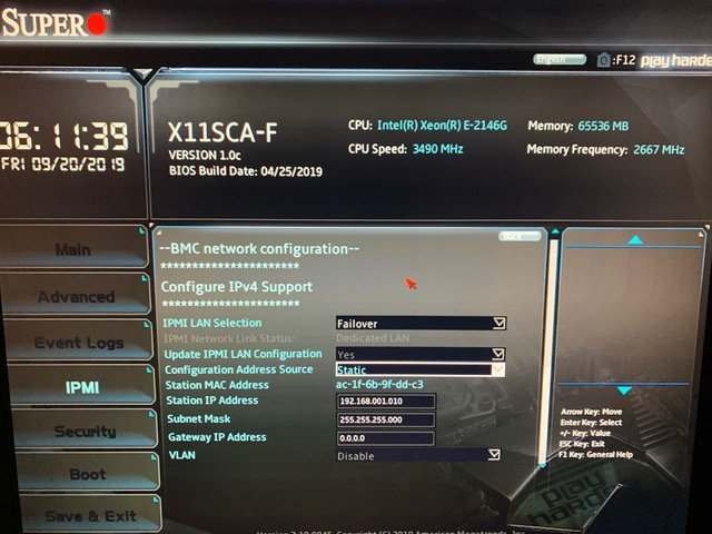

Trying to figure out how to get IPMI to function on this board.  Seems simple enough, but I can not ping the IP once statically configured.  DHCP fails to get an IP.  Board shipped with latest firmware.
Booted the system running Ubuntu and only one interface is seen.  I noticed that the 'IPMI LAN Selection is set to 'Failover' which I believe should be 'Shared'.  The GUI has locked that and I can not change the setting.

according to motherboard manual, LAN2 is the right port for IPMI and it's a shared port. Are you using this port?
Correct.  LAN 2 is what I am using.

Returned the motherboard and they discovered bent pins on the socket.  I've built a dozen or so systems and never had that happen before.  Odd since the system booted OK - just could not get the IPMI interface to work.  Did not pursue it any further.
